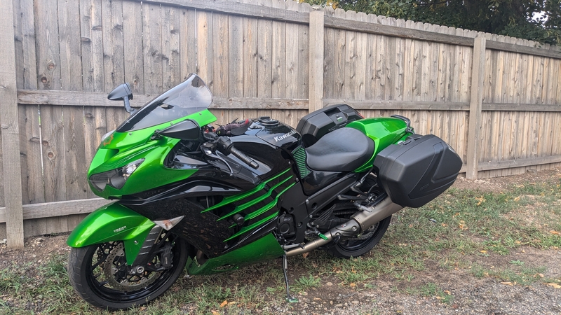

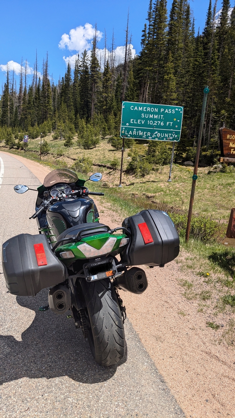

Here in the US I used SW-Motech side bracketa made for 2006-2011 ZX14 with Givi V35 cases on my 2012 ZX14r.
There are many threads you can read by "seraching". Givi can make you brackets, too.
