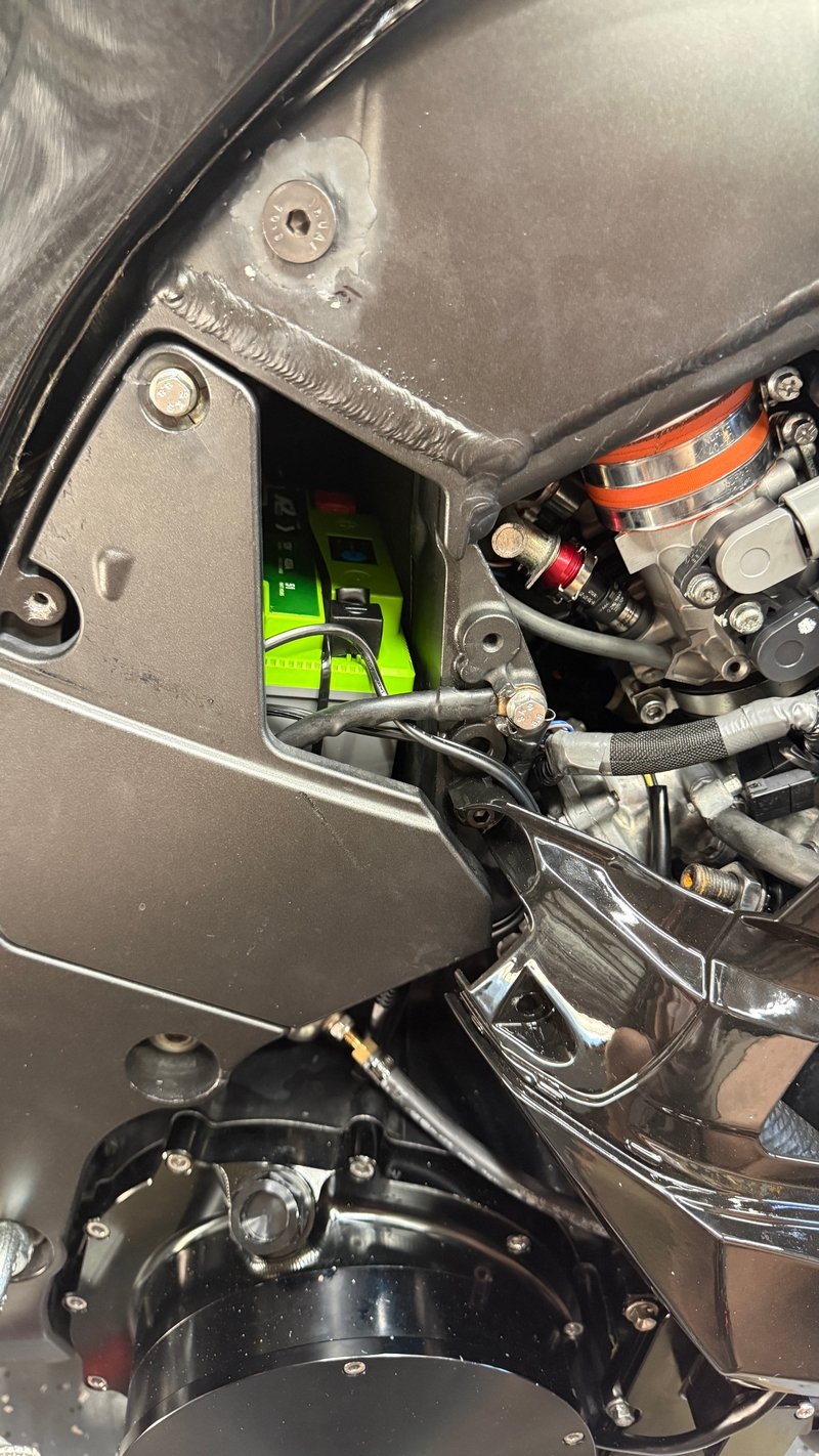

New battery in and new tire installed. Funny to see how much space is left in the battery box with the lithium. It also only weighs 2 pounds versus 11 or so on the lead acid. I didn't want to wait for Schnitz to order a battery from manufacturer and then ship to me. Picked up an X2 battery from Batteries Plus. Battery + charger totaled $130. Also this is a non-ABS bike so with no battery installed you can see a huge chunk of the frame does a whole lot of nothing. Bike sits at 13-13.2V now when key-on engine off. I need to set up relays to power my AFR Gauge and water pump. They both power on at key-on. Definitely not helping the starting situation. I am thinking I will tap my headlights to trigger a relay for power, since those only power on after the bike has started/attempted to start.
My old tire had worn a little more than I realized. Got the same tire as last time. Some Dunlop SportMax or something. $135 installed and balanced after tax. The battery pic also shows off the new injectors nicely. Supposed to meet the tuner soon. Hopefully the bike rides and runs right afterwards.
You can put something cool in there. I was thinking a small nitrous bottle for my Gen1.

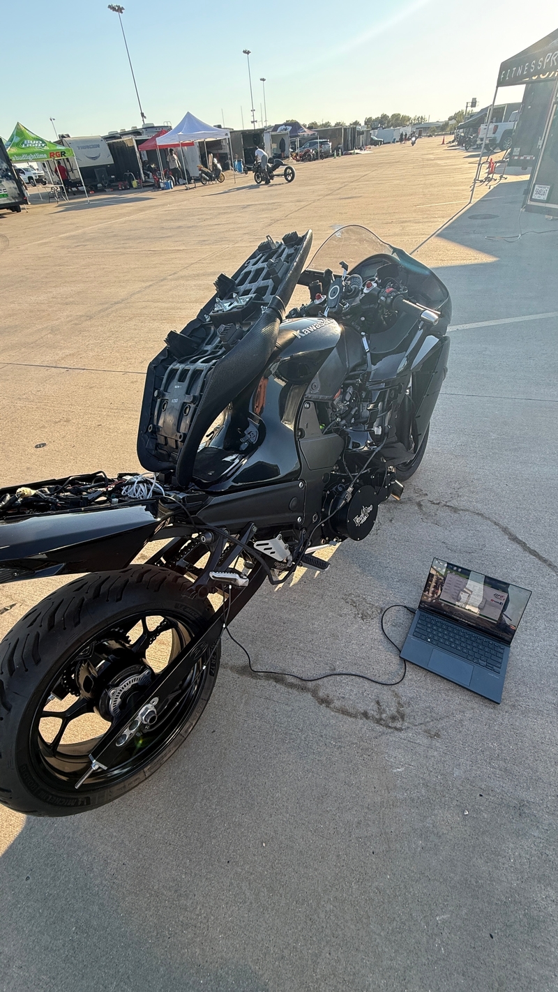

Top: My bike being flashed in the pits
Bottom: I believe Chris Boomstune's personal bike

Met Chris Boomstune at XRP in Ferris, TX yesterday. Coordinating when/where to meet was more time-consuming than expected. I also didn't expect the need to pay $70 to get into the pits so he could tune my bike... He did 5-6 revisions on the tune. He plugged in a woolich data logger and AFR setup to my bike and had me take a few drives. The bike isn't perfect still. It is a lot better than before, just not perfect. Still pops and bogs for a second before taking off when you open up the throttle. He did make changes to the tune everywhere though. From the moment he plugged everything in and me taking a 100 yard lap around the pits to verify the data logger was recording- he admitted that the tune was far too rich. At the end of the night, I know for a fact it wasn't for a lack of trying that the bike is how it is.
We talked about MaxxEcu. Chris Boomstune explained the Stock ECU isn't as capable as the Maxx and struggles to control my injectors at their size. I also talked to Greg Smith, owner of Boost By Smith. Greg hooked me up with a discount for a Plug-and-play MaxxEcu and walked me through all the questions I had, then Boomstune confirmed my parts list on the Maxx. It is ordered.
