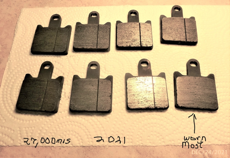

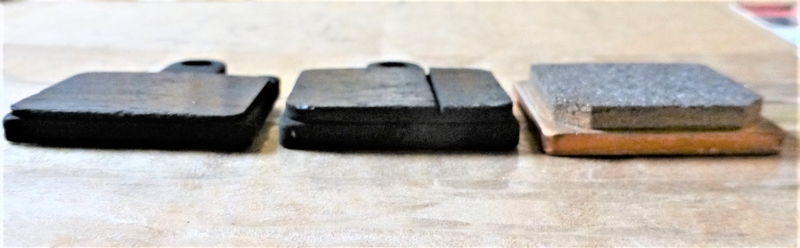

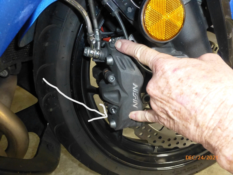

Check your front brake pads. I had a "pulsing" sensation when I applied my front brakes. I bleed my brakes at 27,000 miles. That did not help, then I removed the pads. The right side (looking forward) the lowest pad was almost completely worn to metal. I installed new pads and the "pulsing" quit.
Interesting that yours wore a lot more on the right side,
I have almost 10k on my 2013, so it may be a while before
I chang pads, but will make a note of how mine wear.
I'll assume when you say the 'lowest pad' , you're talking
about the lower half of the pad (?).
