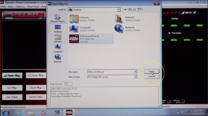

4. Click the Open Map button from, the Control Panel to access the map file you have stored on the desktop.
5. A Windows box called Open Map File will open. Click on the icon for the map file you wish to view. The file icon will become highlighted and the information will appear in the search boxes for File Name and Files of Type.
6. Click the Open button in the Open Map File box or click Cancel to close the Open Map File box without opening the selected map.
7. The Table Manager will display the expanded folders for the map. The Map folder is on top and is labeled whatever the opened map is named (in my case, fullmuzzy.fliesout.pvm). Within this folder is the Map Position1 folder. This folder contains the map for toggle switch position 1. The PCV can have a toggle switch connected to it to select between two maps stored in the PCV. If there was a map for toggle switch position 2, you would see a folder for that map as well. Within the Map Switch Position folder is the Primary Module folder. This folder is for the PCV. If there were other devices connected to the PCV, there would also be folders for them inside the Map Switch Position folder. Inside the Primary Module folder is the Fuel folder which holds the fuel map you wish to view.

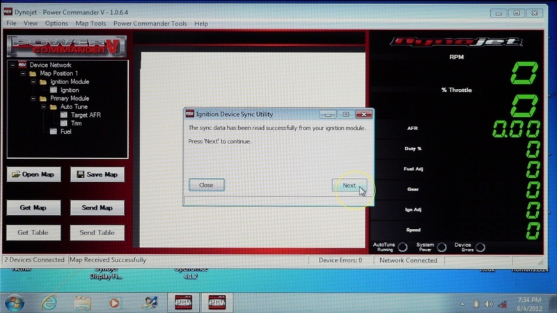

More complex devices such as an Ignition Module or Secondary Fuel Module will require syncing to the the PC5 and other devices in the network that connect inline with OEM harnesses.
34a. Connect the newly added device to the computer by USB cable. I connected both the newly added device and the PC5 to the computer at the same time (see Ignition Module Install, steps ** through **). You might avoid the error message if you do not connect the PC5 until told to do so in the following steps. I have not tried it that way.
Sync Devices Utility will be in the Manage Network menu if a device requiring synchronization has been added to the network.
Go to the Menu Bar of the PCV software and click on Power Commander Tools.
Go to Manage Network and click on Sync Devices Utility.
34b. The synch data from the new device will load to the Control Center Software. Click Next.
34c. A message box will appear telling you that one of the other devices in the network require syncing to the newly added device.
Click Next to synchronize the device to the newly added one.
The message will change and a progress bar will appear to indicate that the device is being synchronized to the newly added device.
A device driver will also install.
34d. If an error message comes up, it probably is because the device driver did not load fast enough to process the data. Click Retry.
34e. Sync data from the newly added device will reload.
Click Next.
34f. A message will appear telling you to connect your PC5 to the computer. If the PC5 is already connected, click Skip.
34g. A message will appear telling you to connect your Secondary Module to the computer if a Secondary Module exists. Connect the Secondary module if it exists in the network or click Skip.
At the time this tutorial was written, there were no Dynojet devices that require synchronization other than the PC5, Secondary Module and Ignition Module.
34h. Click Finish to complete the device synchronization procedure.
The gauge display may change but this will return to the previously chosen layout when the software is reopened.

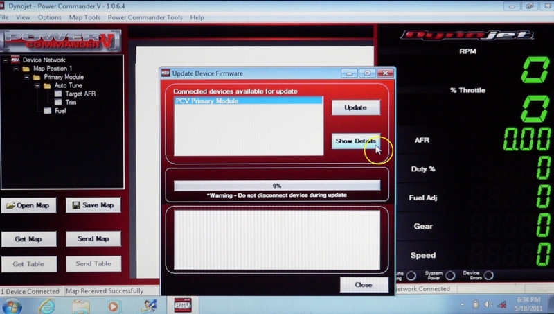

36. Go to the Menu Bar of the PCV software and click on Power Commander Tools. Click on Update Firmware.
The Update Device Firmware box will open listing any devices in the Dynojet network that require firmware updating. Highlight the device you wish to update.
You may click the Show Details button to open a box that will list the firmware updates as they download to the computer.
Click the Update button to connect to powercommander.com
The latest firmware will download automatically indicated by a progress bar. The identity of the update will display in the details box.
Click the Close button to close the Update Device Firmware box.
OR
X out of the Update Device Firmware box to close it without accepting firmware update downloads.
After closing the Update Device Firmware box, a Windows Open box will open so that you can navigate to the location of the downloaded updates file.
I found my updates file on the thumb drive where I store my maps.
Select the updates file and click Open. The firmware of the selected device is updated.
