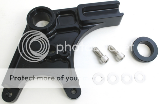

The only other mount I see on Web!ke is the Kohken Denka and that to me looks the same as the plain old active mount. You have the assurance that the Denka is aluminum so guaranteed lowest weight. The plain Jane does not lisyt the material and does not say anodized so my guess is it is probably not alum. Read the ads. You place the order, you cannot cancel, cannot return. It's your's baby.
I'm leaning toward the Denka because it comes in gold. Another $67 for something other than black.

I'm looking into weights of the Denka v the Active mount. Based on looks, I'd say the Active is lighter. The Denka is probably forged aluminum which will be stronger but I'm sure a bit heavier too. I don't pay more for heavier.

I got word from Webike on the Active bracket. They don't say "with packaging" and there's no mention of the spacer.
According to the distributor regarding to the item you are inquiring,
the weight including bolts is less than 400g.
Thank you for your consideration.
[ The product page link ]
http://japan.webike.net/products/21312328.html
*It will take about ? 4 days? to get ready to ship from our warehouse if you make an order today.
400 g is 14.11 oz
Throw in 1 oz for spacer and you got 15.11 oz
The Denka is 19.75 oz for the whole package so if the packaging is more elaborate or includes a corrugated cardboard box, it might be the same weight as the Active. i think the safer buy is going with the Active but i really like that Denka.

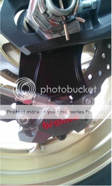

The Kohken Denka below.
The Active seems to possibly be cut a tiny bit deeper... maybe. The anti-lock sensor bung adds some bulk but this also has 3 holes. It also arches up between the caliper bolts like the OEM where the Denka goes straight across. The arch alone would account for about 1.5 oz of metal. Cut a bit deeper (if it is) and that would be an oz.
Posts: 22049
RE: Lightweight brakes
01/24/17 5:31 PM
Also, it is not very apparent from the pic of the Denka above but a couple other pics on the site seem to indicate there is a third rib along the rear edge. That's another oz.

Ordered the Beringer rear in titanium. Chose the Active mount as it had the only pics and description that seemed to indicate compatibility with abs. I dont like the extra spacer that is shown with the Active bracket, eventually I'll try to modify the bracket to eliminate the spacer
