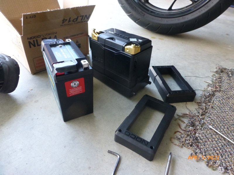

I'm using NOCO (NLP14) Lithium Battery for the last 3 yrs. The screen reads 13.5v when I turn on my key.

I just recently switched over from Shorai to a Noco NLP14 the other day. Liked the fact that it’s smaller and lighter and can be purchased for just about 50% cheaper than what I paid for my shorai. It also has 500 CCA which helps when starting during those cold days.

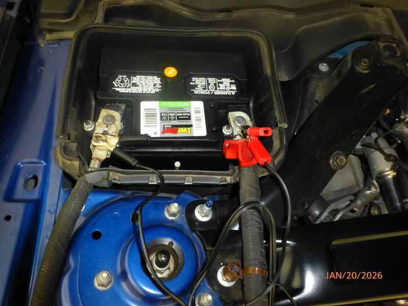

I believe mine weighed 2.5lbs. I used the spacers making the battery the same height to fit the strap. I am considering getting 2 NOCO batts, wire them in parallel and put them in my Mustang battery box. The battery box is about 6 inches deep. The stock battery is only a 2-year warranty with 590cca. An AGM battery is $355. A lead acid from Wally-W was $109.

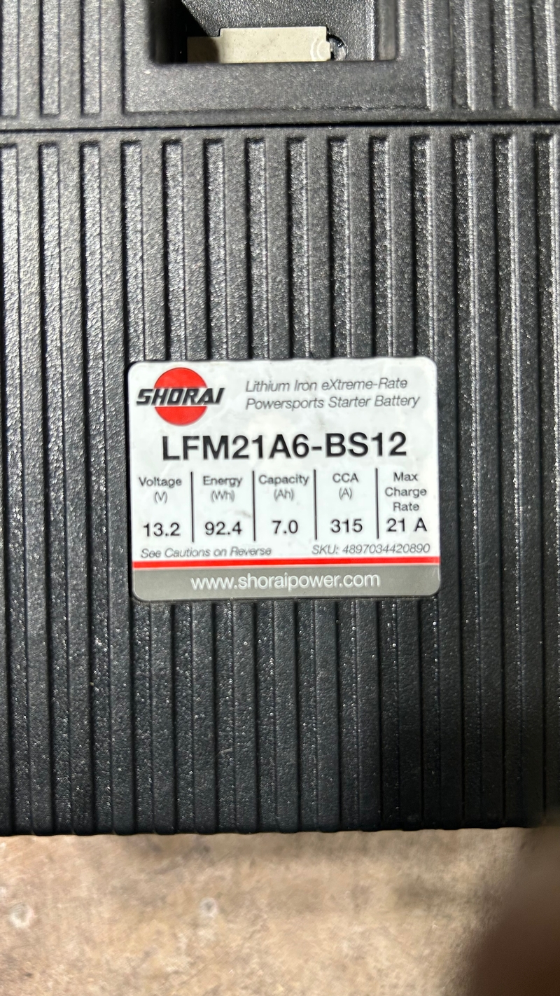

This is the Shorai direct replacement for the 14R. The smaller one you were using with your 14 was a smaller capacity battery, which I had purchased when I had my 2012 14R. That smaller capacity battery didn’t work out for me that well. Intermittent starting issues, just randomly losing power at traffic lights. Once it left me stranded 30 miles from home and had to call my wife to bring me tools and my backup AGM battery to get back up and running. Afterwards I contacted Shorai and they told me I was running the incorrect battery for the 14R and stated that the LFM21A6-BS12 was their recommended direct replacement battery for the second gen 14. Once I purchased it I no longer had the issues I mentioned.
The Shorai direct replacement battery weighs in a little over 3 pounds and has a 315 CCA, compared to the Noco NLP14 which weighs in at 2.5 pounds and has a 500 CCA cranking ability. Also it’s designed so that you can attached the positive/negatives connections at various ways/angles, if my memory serves me correctly there are 3 different mounting positions you can choose from based on your specific application. Did I mention it’s also much cheaper ($129.99) and since I already have Noco Genius chargers, it was a great match and purchase.

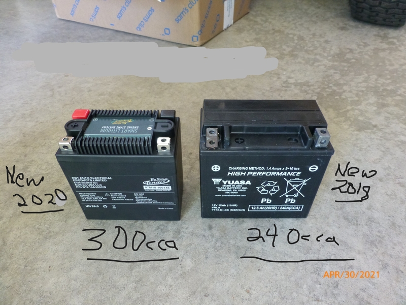

My first Lithium Battery came from Battery Tender. Rated at 300cca. But after 1 year it struggled like the lead-acid battery trying to start a hot engine with the electric fans running when I turned my Key. That is the difference from Gen 1-ZX14 to Gen 2-ZX14r, 2 radiator fans drawing more Amps. Kawasaki should have wired the ignition to start the engine first, then turn on the radiator fans on a hot engine. Maybe I could add a toggle switch?
