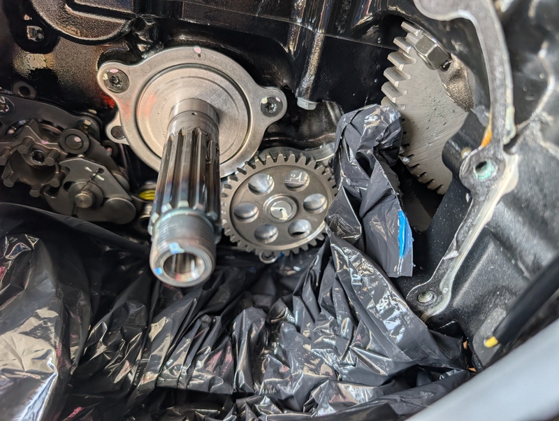

I did this today, and I want to reiterate what Rook says about putting a plastic sheet down. I managed to drop an allen socket in the oil pan before I put a trash bag down as a barrier. After I put the trash bag down, I still managed to drop the oil pump retainer pin and also one of the oil pump cover bolts. Fishing stuff out of the oil pan isn't impossible, but it's better to not have to do it.
Also, the clutch pressure plate is keyed. I somehow missed this, and I couldn't figure out why my clutch wasn't actuating properly. I took it apart 3 times trying to figure out what I did wrong, until I realized it was just the clutch pressure plate not being in its slot.

I don't remember the Gen1 pressure plate having any kind of key for exact positioning. I did mark the bolts to both the pressure plate and the boltholes in the hub so it all went back exactly the way it came out. The key for the pressure plate must be a Gen2 update. I'm glad this tutorial was of use to you on your Gen2 TXZX. Someday down the road, I'll be doing a Gen2 version. I understand there's quite a bit of change to the clutch on the Gen2. Thanks for the heads-up on the pressure plate key.
