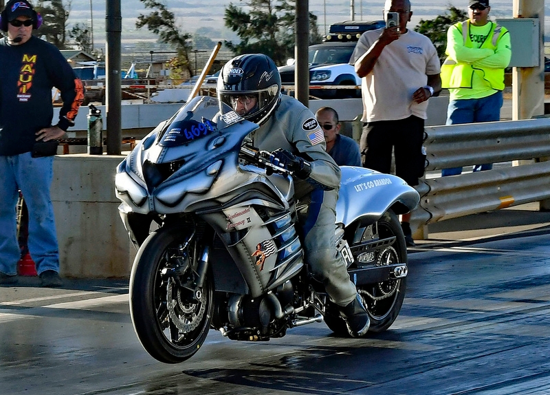

Aloha from Maui!
The 2023 season saw a few changes and got me closer to my original goals but as Ms Lewinski said "close but no cigar!" Mid season I added a longer arm built by DME for 69-74" to allow me to go beyond the 70" I was running. I ended up finishing second in the ProBike points and made 10-12 passes in the 8.0 range with a best of 8.035 When the season ended in late November I did a compression and leakdown test with a visual borescope inspection and found the motor to still be virtually flawless. With that confirmed I decided to put the bike on a set of scales which verified my thoughts. Miss piggy weighed in at a chubby 514.7 lbs. A diet for the bike and a tread mill for myself was in order. It was a long and time consuming and somewhat expensive effort but I thought it would be my best route to the elusive 7 second time slip...
Fordtech58
Fordtech58's Gravatar
Joined: 12/10/16
Posts: 224
RE: RCC stage 1 plus build... Goal Met!!!
03/31/24 4:12 PM
Our season opener was last Saturday March 23rd. We were scheduled to have a 2 hour t/t session which ended up being a bit of a cluster f$%k with delays, oil downs and timing issues on a 4 month green track surface. I'd backed the boost down by a pound in the first 4 of 5 stages for the t/t which I only got to make 1 pass spinning in all 5 gears.
My off season weight loss efforts brought the bike down from 514.7 to 493.6 with 18 of which came off the front. My personal effort brought me from 171.2 at the 11/23 race morning to 163.8 at Saturdays weigh in!
Our track specialist went back out to drag and spray after the t/t so I decided to make a little change and bumped the first 4 boost stages back up .5 lbs for the event and see what happens. In the off season I'd put in a new clutch pack, new slightly larger air filter, bumped the rear sprocket from 44 to 45 which set the wheelbase at 71.5" I put on a set of Brocks window links and slid the fork tubes a bit higher. The result ended with 2.25" ground clearance and with the NHRA spec of 2" I was legal but not comfortable with the oil pan sump being the lowest point. I decided a Schnitz modified stock pan was in order and they were able to get it to me a week before the event. I only gained 1/2" but it could be a critical 1/2". Q1 gave me the 7 year elusive 7 second time slip and a first of my 50 years of 1/4 mile passes. It also gave me a best 60ft of 1.272 followed by 2 1.267 passes and a E2 1.261 which also unfortunately gave me and long wheelie beyond the 100ft mark that just kept climbing and I had to chop it hard to 25% to drop the wheel which landed so hard it bounced me off the seat. That extra 1/2 was worth its weight in gold as nothing hit and all the slippery stuff stayed in the motor! Second best of the day was a 8.027 though all my runs the back half was slower and the mph down 5+? I'm leaving the gearing where it is for April and get a better idea if it were just the track conditions, gearing, air and boost though I never changed the 5th stage which is in at 2.6 seconds. My only fear is I've lost some aerodynamic advantage by removing the front fender and lower fairings. I can put the lowers back easy enough though I'd have to reverse the forks to get the fender back on but I'd really like to keep the brake weight forward if possible. Time and time slips will tell...

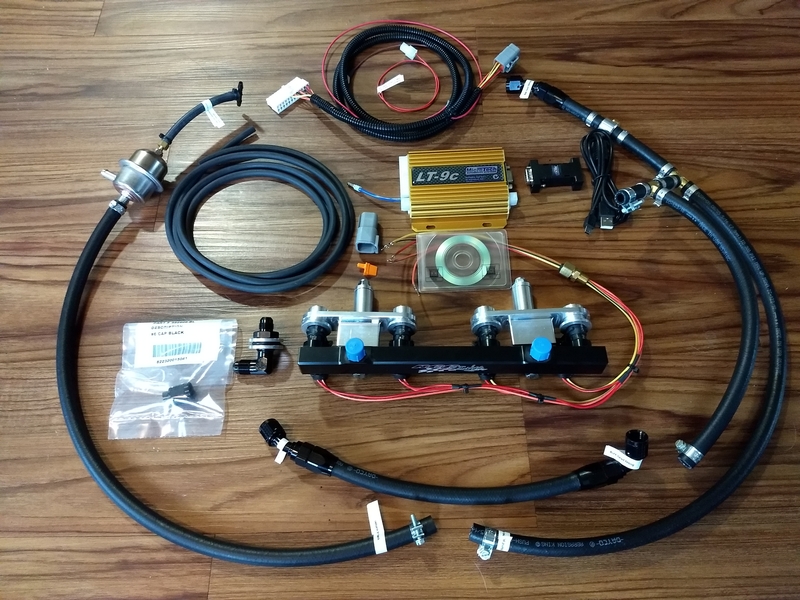

Hey Rook, PTI stands for pressure transducer input/interface not sure on the last one. It's a pressure sensor mechanically plumbed to the boost plenum and it electronically sends the information to the PCV for instant AFR adjustment following the boost being produced. I'll add some pictures of the secondary fuel system and intercooler kit here or on your new thread, your choice? If you can get me your email I can send you pdf docs for the installation of both kits. I purchased the stage 2 fuel system ($2000) and intercooler ($2500) after my initial build. I'd suggest the stage 1 kit can be installed by anyone with a fair amount of mechanical aptitude in a weekend. The stage 2 system gets a bit more involved as the engine has to be lowered to allow room to drill the frame to mount some of the fuel system components including lines, fuel rail and injectors etc. Rick Roman helped me along the way and was directly responsible for my use of Boostane Pro and getting into the 7 second zone! When I decided to start this build in mid 2016 Power Commander didn't even offer a system for the 2016 which is why I searched out a 2015 leftover for the build. There are multiple different ecu's over the years including with or without California emissions.
Posts: 22049
RE&amp&#x3b;&#x23&#x3b;x3a&#x3b&#x3b; RCC stage 1 plus build...
01/10/25 7:08 AM
Thanks, I will keep that in mind if you're happy with it. Autotune worked for building fuel maps for my NA Gen1 ZX-14 but it was way too slow to soley rely on for real time adjustments. I remember seeing selections for MAP sensor in the PC5 software. I'm sure they've updated the software since I last looked at it.

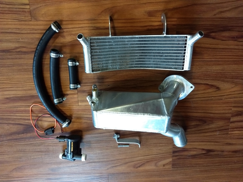

Why not post them right here? If you don't mind, I'll just rob them and post them in my thread if I need to.
I'll PM you my email this weekend. Thanks!

There is another Fordtech on the forum. I'll attach the RCC Stage 2 and Stage 2 plus picture here also. Not sure where you're located but I'm relocating to Bossier City Louisiana in early March. Looking forward to having a lot more tracks to choose from and try...
