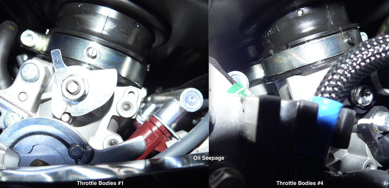

Regarding proper oil level, I kept my Gen1's oil level no higher than the top line. Even so, I noticed signs of oil that had blown up the throttle bodies. I saw the oil on the underside of my secondary throttle plates when I removed them. Also on the underside of the primaries when I removed the throttle bodies assembly. I also wiped the greasy dust off of my duct clamps once a year. It looks like my Gen2 is the same, first time the fairings come off, there's the oil on the throttle bodies. The oil level was perfect from the dealership and it is perfect now after the first oil change. All I did was run the engine at idle about a minute before shutting down for the year. This oil film we see has to be from the oil that came in the bike. The oil film is also on the inner ducts ...not a big deal, I'll just wipe it off once a year like always. I'll have a peek at the air filter in a few days. As long as I didn't run the oil in my Gen1 higher than the top line, no oil made it past the ducts.
