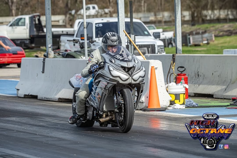

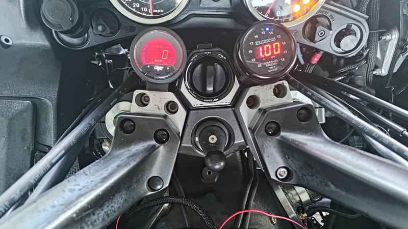

I received my BAM performance gauge mounts on Thursday. The kit was super easy to install and the pilot hole adapter easy to use. I've now regained full view of my neutral light and clock which you'd think wouldn't matter on a race bike but it does for this old guy. I did have some contact issues at full lock to my brake lever but with Bryans design I was able to angle shave the mounting screw base and gain what I needed. If the weather holds I'll be at the Texas Motorplex next weekend for at least Friday's test and tune then Saturday's bracket event. Sunday optional if I go a few rounds Saturday! I like the new view for sure, Thanks Bryan!!

I only needed two gauges, boost and afr, so I 3d printed some mounts that bolt to the standoffs. Im on a connie so it has risers with an existing hole already threaded and dont remember if my zx14 had anywhere available that would be similat. The standard 52mm gauges juuussst barely clear below the factory gauges but do not touch anywhere. Nice to still have full view of my factory gauges, but two would be the limit.

Looks good, I’ve updated my website listing to let people know sanding may be required and I will include a piece of sandpaper with each kit as well.
