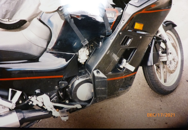

Speaking of "Tall. I met a fellow rider at the 1994 "Rider Magazine" gathering at Steamboat Spgs, CO. He was 6'6" tall. He had added forward footrest pegs on his 1000 Concours.
Also, notice how much drop he did to the foot pegs.

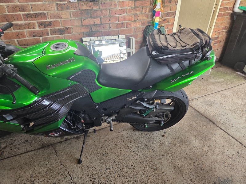

Does your windscreen extension come on and off easily
or is it permanent?
Nice job on the tour boxes, I have a 40 liter backpack
attached to my pillion seat, which allows me to
carry some things when I need to, not nearly as
good as what you've done, but it works for me,
plus I wear a backpack as well when needed.
It looks like your friend added foldout highway pegs
to his bike.

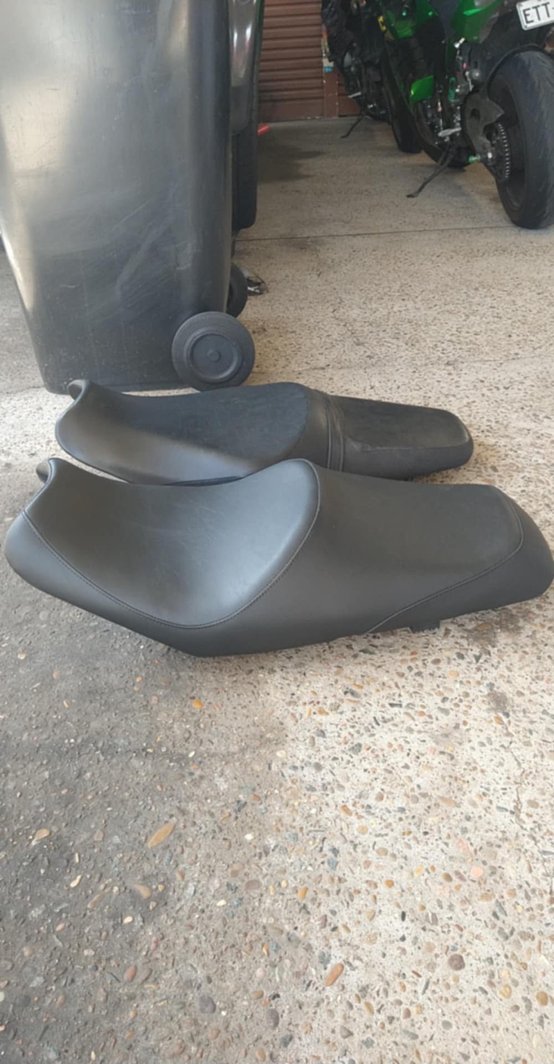

i put a cheapily obtained gtr1400 seat on my 2012 as a test , they use the same base but the bracket needs to be changed if you don't want it to wobble (held on by 2 nuts heh). Things to note is the concourse seat doesn't taper in as much as the 2012- seat so it feels wider at the legs aswell as being that bit taller , but it has a more aggressive buttstop which is nice.
i ended up disliking the extra height as effected wheelies and made wind protection less effective without being more comfortable in a worthwhile manner. Amusingly ended up using it as a base for a cut down race/street seat keeping the existing / more prominent buttstop in place. More comfortable than one would think and lowered in the bike , win win i guess.

it was cut down a bit more at the front after this but it shows the difference well enough. with a seat bag and such on it looks like a fairly normal seat.
