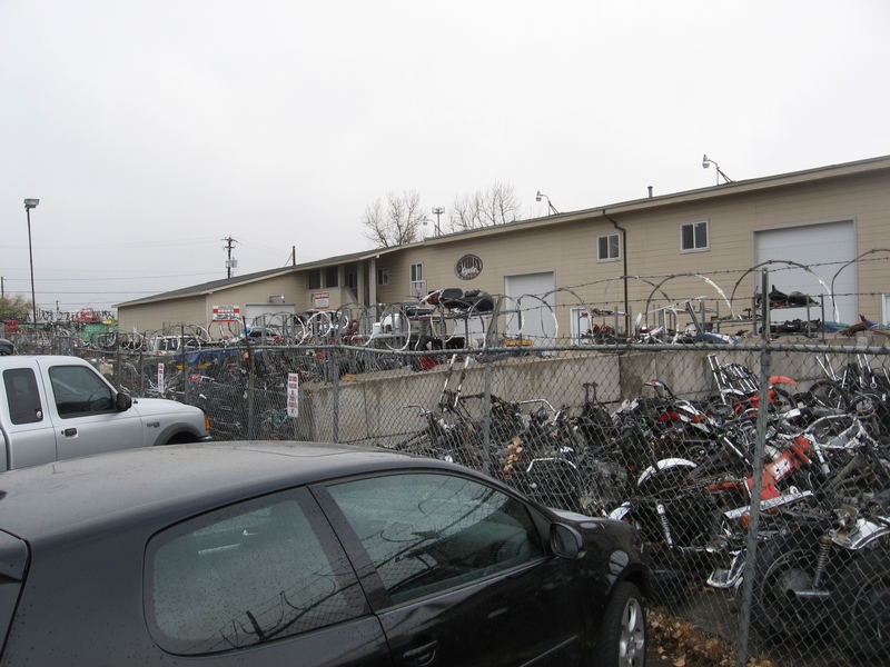

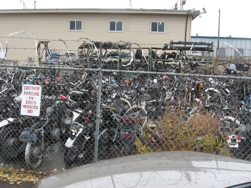

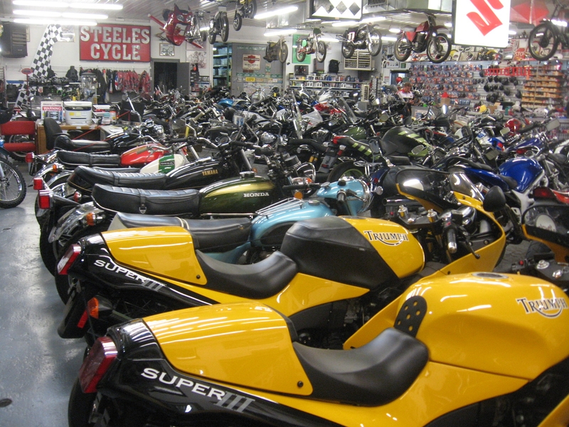

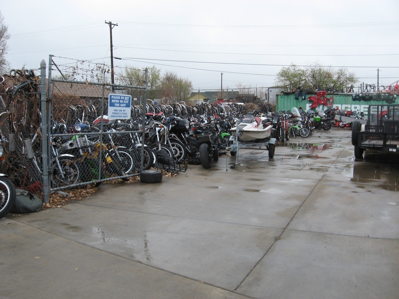

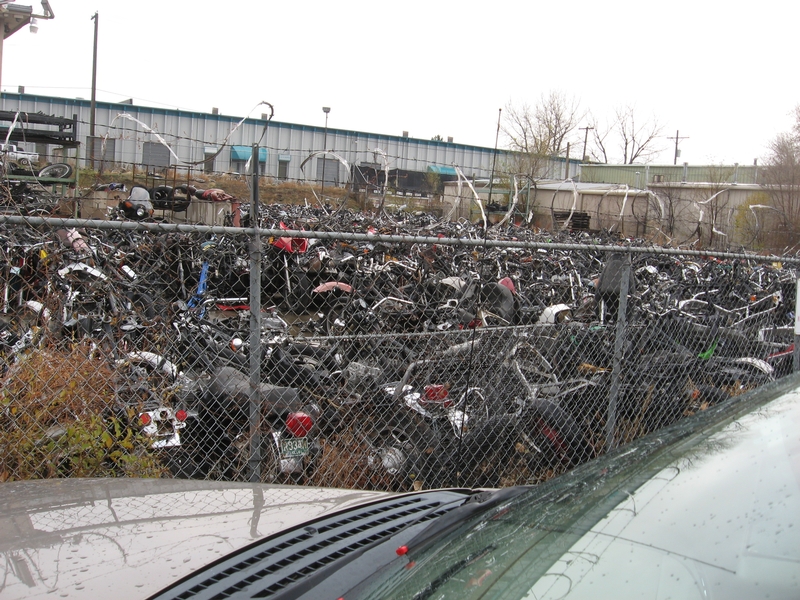

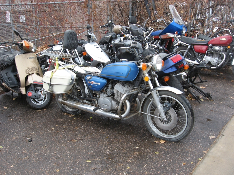

I moved to Colorado in 1979. I started driving for the largest Paper Company in the Rocky Mtn Region. My company had 60% of the business while 6 other paper companies fought over the 40%. Since I owned a motorcycle I was always interested in Bikes/parts. There were 2 main recycle (junkyards) for Bikes. DUMP (Denver used motorcycle parts) and Steele Salvage. Then I found out about Police dept auctions, usually every 30 days. Most wrecked Bikes have front forks damaged. I remember bidding up to $300 on a wrecked FJ1100 Yamaha with fork damage.
I bought a used 1986 Kawasaki Concours C10 in 1994. Kawasaki added higher handlebars in 1987 and I wanted a pair. They were $250 each new from Kawa. I called Steele Salvage and they had a wrecked 1990 and stored inside a large building. They let me take my tools and take the parts I wanted and I came back to the counter. They looked at what I had taken and charged $100.
I look at Copart stuff and Copart is the middleman for Insurance companies. Watch some of their auctions on YT. I'm following a used car dealer who buys cars, repairs them and sells them. NKY Auto on YT... https://www.youtube.com/@nkyauto
In the old days as motorcycles quit being popular people would just drop them off at Steele Salvage. They had a mass of Bikes the last time I visited. Now they rebuild Bikes and sell parts. Another place popped up is Imperial Bikes. They deal in Ducati and Aprilia. I went to them because they had a portable dyno I used for another Bike I was modifying. Delkevic Exhaust International Warehouse is in Denver, too.
For Copart vehicles I would talk to a used car dealer or body shop that might already be registered. I would think a wrecked ZX14 sells for less than $1000.

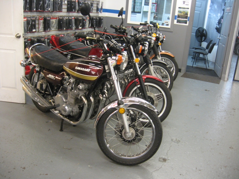

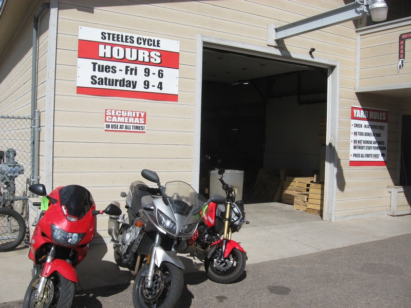

Steele Salvage Yard and showroom, pics from 2015.
