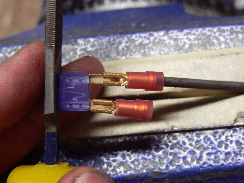

20. Place the crimp tube end of a 7/64” female contact for 22-18 gauge wire (audio contacts) on a small steel rod held in a vice.
Use a flat steel object to carefully press one tine of a 3 or 5 amp mini fuse into the female contact. It will be very tight.
Repeat this procedure for the other tine on the fuse.
I felt the manufactured inline fuse holders were a bit bulky to install to the ram air tubes and the wire was also rather stiff. A home made inline fuse is a lot smaller and does exactly the same thing. I have perfect confidence in them.
21. Crimp about 3” of 18 gauge wire onto one female contact and about 15 inches to the other. It does not matter which length wire goes to either contact.
Coat the top and bottom of each connection with RTV silicone sealant.
Slide a shrink tube over the connections and heat them with a lighter.
Repeat this procedure to make a second inline fuse if you plan to have the dimmer feature opperational.
