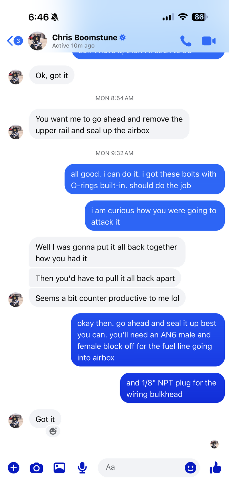

He offered to seal up the airbox. I couldn't say "no". I've been worried about sealing it up. I bought some fancy bolts with machined channels in the head and o-rings that were going to seal the airbox from the old injector rail holes. I guess if his solution (whatever it is) doesn't last, I can always revert back to the bolts.

New ID1050X's will give me all the fueling I'll need on pump gas or E85. Dyno tune will make them flow correctly.
Microtech controls the upper rail in the airbox. no more microtech- no more upper rail needed. I'd rather have it out so I can sell it, plus I need it out so I can access my velocity stake intake tube thingies.
Welding would be ideal. Hard to find a good welder around me to do it.
I move in exactly 1 month. If he isnt able to plug the holes by then, I'll be able to find a welder easier in the city.

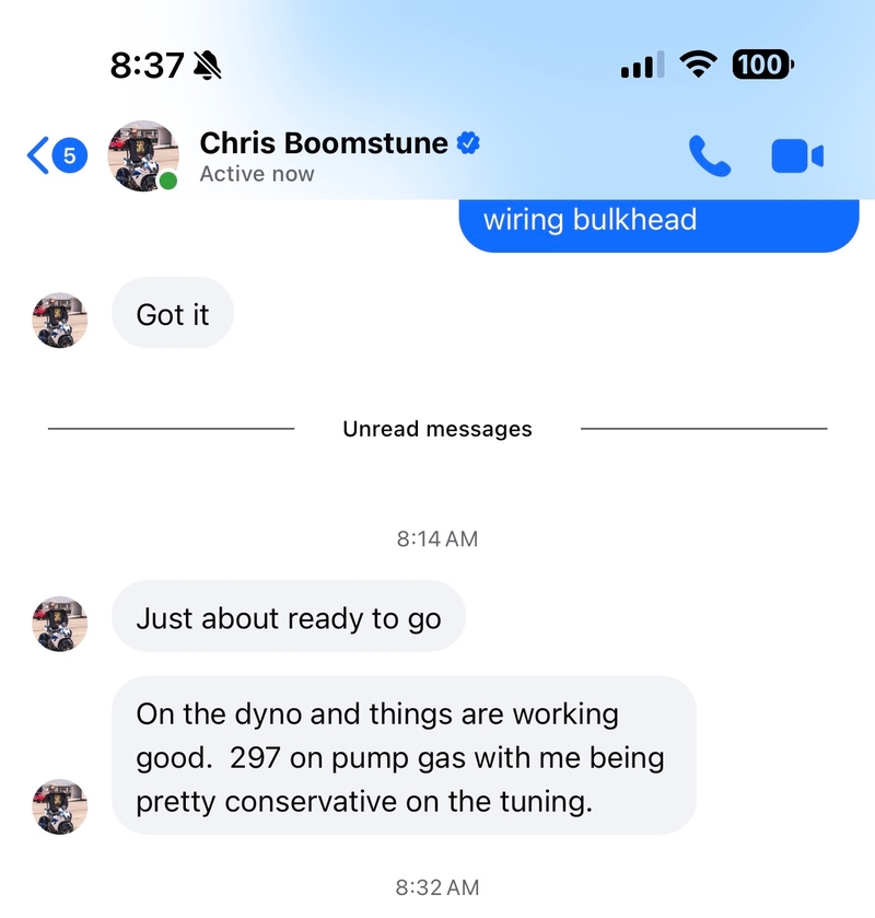

Bike is finally back home. It was an 11 hour turn around getting the bike. Chris warned me that the injectors are pretty big for pump gas. That it runs pretty rich down low. Also I noticed that the bike is either experiencing the same spark-cut as before when the plugs fouled, or is just running way too rich on tip-in.
After about a half second or full second of any throttle above ~80% it "stutters" and does what sounds like 2-step, it builds boost then takes off like a missle.
Feels quicker than before, despite there being less power. it even tried to wheelie on me a few times (including while I was leaning (scary).
I'm disappointed that the bike still isn't running quite perfect. Only solution left is to go to MaxxEcu or just live with it as-is.

With Microtech- 316whp (questionable reliability due to very advanced ignition timing)
With No MicroTech- 297whp (Less timing and less boost due to an uncapped top nipple of wastegate for consistent boost behavior and peak)
With the 316whp setup I was running up to 12 PSI peak of boost (capped wastegate nipple causing higher peak boost but inconsistent curve). On the 297whp setup I am running 10 PSI peak consistently. I will say that I can do a rolling burnout anytime I twist the throttle with 297whp and I couldn't do that with the 316whp setup. Could be the dynos were slightly varied, which is normal, showing different power numbers on the same bike.
I wish he had just cleaned up the off-boost fueling and maybe the timing, but he offered something I sort of always wanted. Even if it is a loss, I'd eat a 5% difference in power for peace of mind and less complexity.

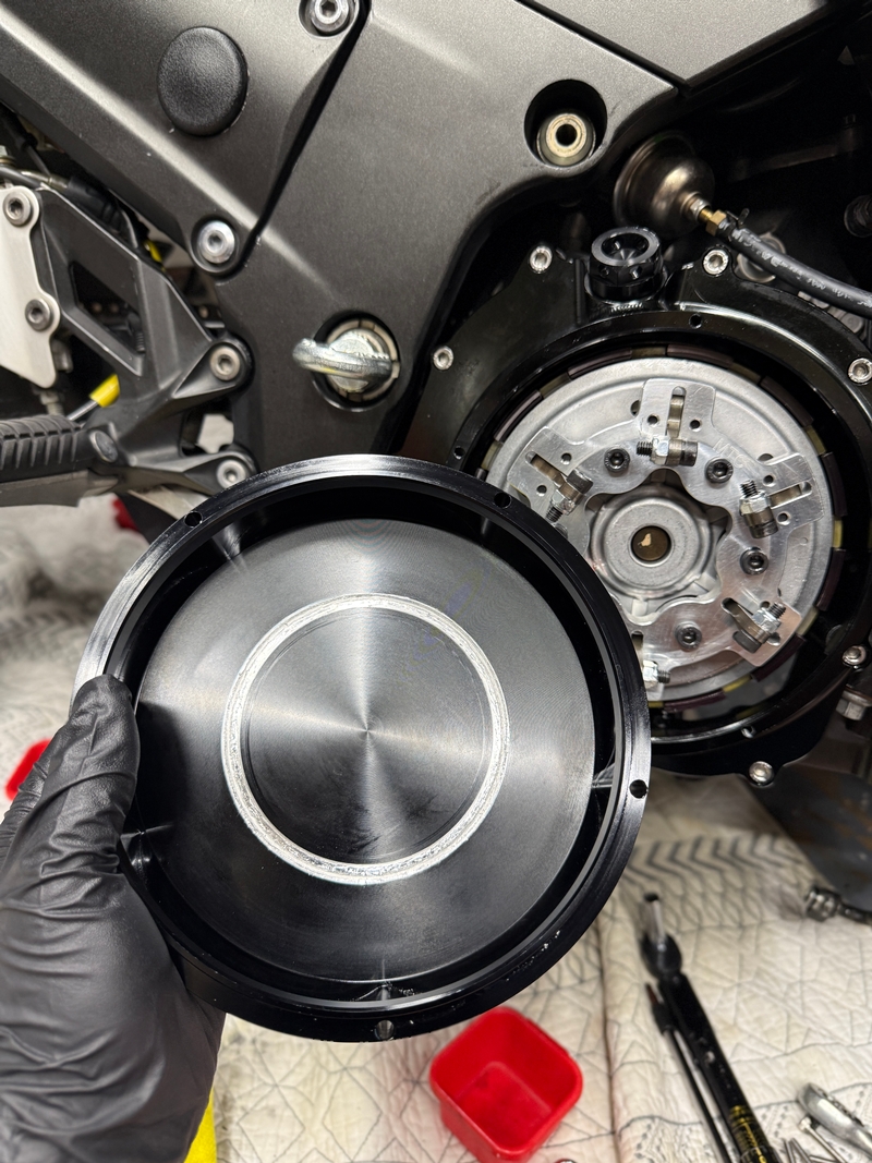

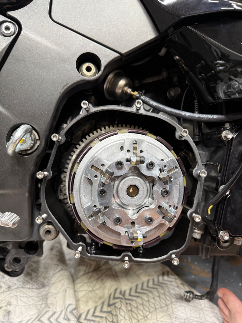

Clutch assembly was removed and torn apart. Clutch Hub Nut had backed itself almost entirely off the shaft. That is the nut responsible for keeping the entire clutch assembly in place. Not sure how it loosened besides it not being torqued enough. I have a new torque wrench I can use now that is probably more accurate than my last.
The screeching noise I heard appears to be from my clutch cover and 2-Stage lockup making contact while the basket had moved further away from the case. My clutch cover has an almost perfectly machined ring on the inside now. There were also strings of aluminum inside the case and resting on the oil pan in a manner to support that the noise heard was indeed from my lockup machining itself into the clutch cover.
Pulling pan off today to clean it and check for any other damage.
I will need to file the bolt head on my connecting rod #4 because it is still making contact with my clutch basket.
I ordered a new oil pickup tube which I anticipate will be the biggest holdup to getting the bike back on the road.
Fairings are missing paint unfortunately. ~$900 feels wasted. Oh well. I'm going to try and salvage them or just not care enough to notice the scratches.
I haven't inspected the clutch cable and slave yet. I removed the clutch cover and the basket assembly nearly fell out of the bike. My focus has been on that.
* Last updated by: danmin on 10/2/2025 @ 9:15 AM *

MyGen1 ZX-14's clutch is the only one I've ever removed in my life. I remember the hub nut was very hard to break free, probably the tightest fastener I've ever removed on the bike including the rear axle nut. The torque spec for the Gen1 is 99.6 ft lb. It's a special nut with a flattened spot in the threads to self lock on the input shaft. The SM recommends replacing the hub nut if it's removed. That's what I did. The torque wrench I used was cheap. I think it's kind of accurate. There are torque adapters that will turn anything with a matching square drive into a torque wrench. They're available in various ranges of torque settings. I think this is the exact one I own and I have trusted it over and over.
I'd get a fresh new hub nut though. Leave nothing to chance.

I didn't know they needed to be replaced. Hmm. I have a titanium nut as a part of my slipper delete. I hope it's reusable since it cost $80.
I am thinking I trusted my giant MATCO impact. It's rated for 180ft/lb. Double checking with my torque wrench made it appear as though it was torqued well enough. I have since bought a new fancy digital torque wrench. To replace the one of unknown age annd origin. I am wondering if my rod nut contacting the basket also played a part, but 100ft/lb is a lot of torque to just get vibrated loose... Gen 2 calls for 100ft/lb flat.
Looks like my oil pump is okay. my pickup is toast. i took it off and looked inside. went straight into the trash. my parts arrive over the next 3-7 days. I am anticipating a return of the bike. Everything looks and feels good now. I deep cleaned everything in the engine. no more flakes anywhere.

Cleaned and clutch back together. Torqued to 100 FT/LB. Doubled checked it too.
Attached are new photos of everything cleaned and reassembled. I also included the clutch cover damage
