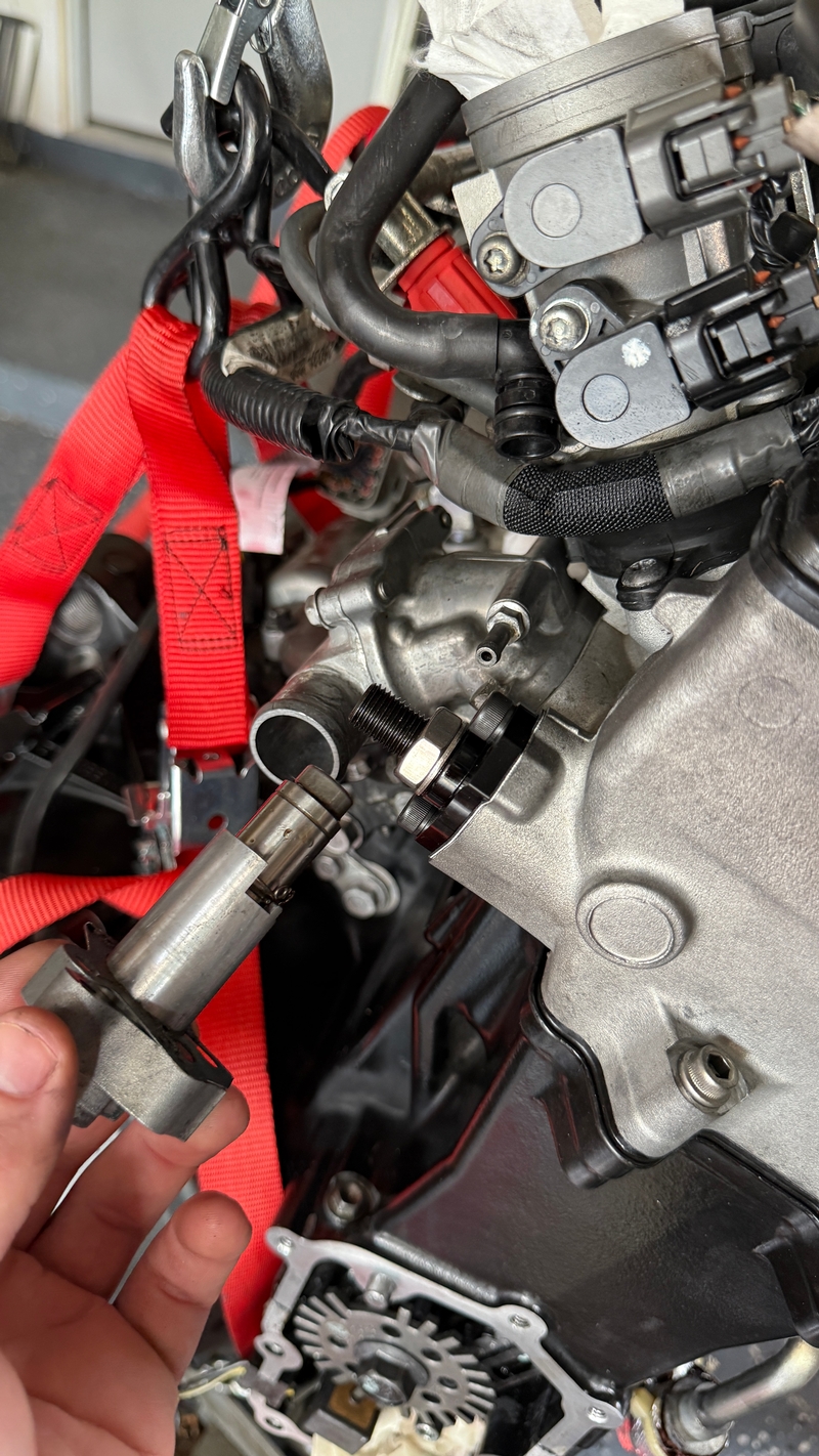

Bought the APE Tensioner. I had the chain jump teeth more than once while rotating the crank with cams installed. Had to pause and disassemble everything. Thinking the tensioner wasn't activating as expected. Irritating to uninstall, line up the marks, and reinstall so many times now. I need to make sure the spark timing is correct. Need to dig into how that works again. Forgot since assembly. I don't want to chase down a poorly running engine all due to timing being 180 out.

That's what I was talking about when I mentioned starting the bike after the valve clearance adjustment. You just never know 100% until you turn that key. You know what you're doing. My only course of action when doing these things is to be extremely careful and go extremely slow. LOL I didn't dare let that chain move off the crankshaft sprocket. I had it all bungied up until it was ready to go back on the camshafts. I don't recall it jumping teeth with the cam chain tensioner in. I must have turned it by hand a couple times to check everything out. Sounds like your stock CCT spring release is a little worn out. Maybe it wasn't released properly when you put the CCT back in. Mine was locked open and then I tapped it with a long screwdriver held down the cam chain tunnel. It popped shut putting tension on the chain.
With the APE tensioner, you tighten it down until you feel contact and then start the bike. Play with tightening or loosening until you get it just right (no rattle). The instructions with the APE CCT were very clear, I have a tutorial on here than should be of help too. It was the older model of the APE CCT but I assume setting the tension is the same procedure.

04/26/25 5:46 PM
April 26, 2025

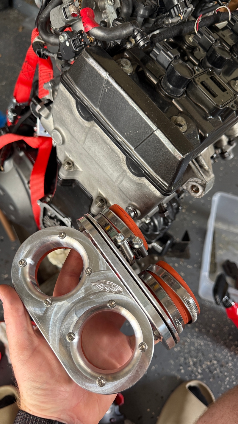

Installed APE Manual Cam chain Tensioner. Received Brutal Performance Silicone/O-Ring velocity stacks.

I love it! Does it care what velocity stacks you have if it's turboed? I remember Romans went with aftermarket intake bellmouths because they sealed the airbox better than OEM.

I really think going with the APE tensioner makes sense. I'm just a turbo newbie but that seems like a wise choice because "just incase" happens. ...might as well be covered.

danmin, I really like the looks of those stacks. I did a quick search and found nothing on them. Where did you source them or do they have a direct website? If I'm correct it appears they'd seal the frame to the throttle bodies much better under high boost. my only concerns would be the 4 small screws that appear to secure the upper to lower half? One fall down the intake track would be catastrophic though a dab of loctite should relieve those concerns? I'd appreciate more information if you would share? Last question that I haven't found an answer to is there's a dual divisional at the Motorplex May 15-16-17-18. Would you happen to know if there's a bike class available??

Here is the link to their site.
https://stores.brutalperformancellc.com/kawasaki/zx14/
Not necessary if you’re going to run low boost. The OEM stacks are supposed to leak around 8-12 PSI, in an ideal circumstance. People use the OEM stacks in higher boost applications but you risk big leaks. I don’t want to try keeping the OEM stacks and then needing to swap them out later. Kind of a pain. Not to mention- my old stacks were soaked in oil and gross with questionable clamps.

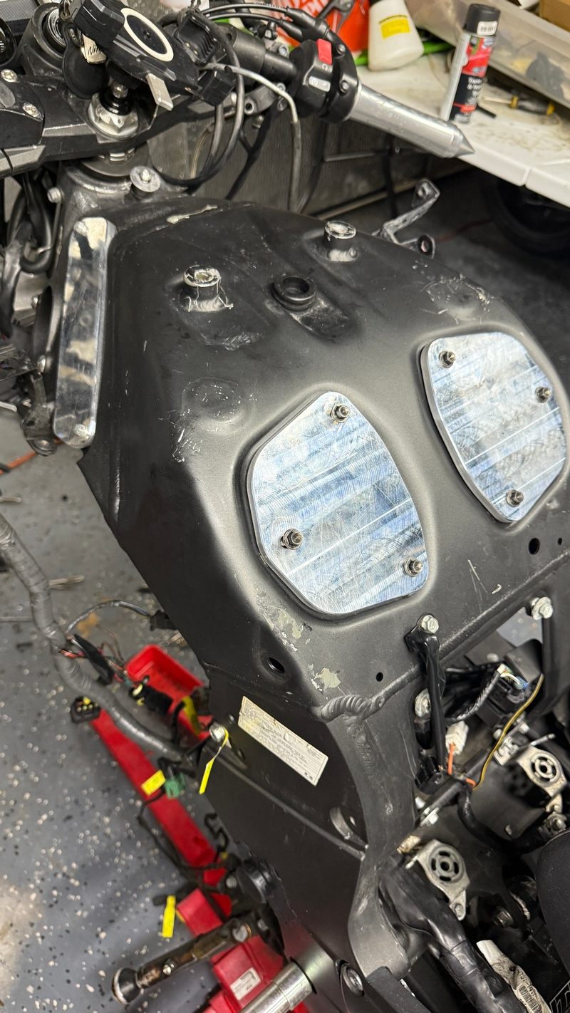

I’m trying to get a welder to come out and weld up the frame for me. I’m not gonna risk a rubber plug or chunk of JB weld falling into the engine. My goal is to never need to take the engine or bike apart more than just wastegate springs and tires/suspension when I turn it up to about 400hp.

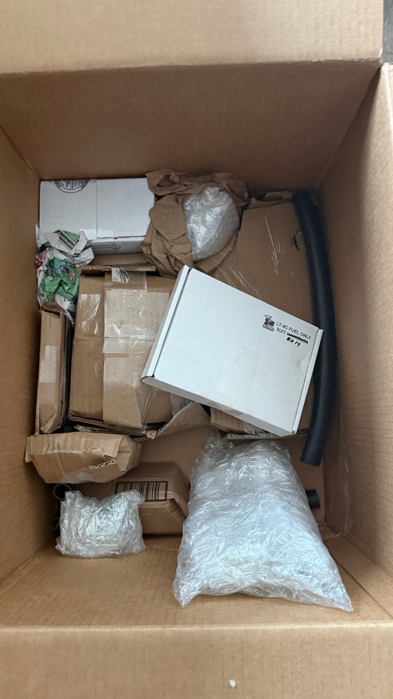

RCC Turbo kit arrived. It is extremely packaged. I have overfilled a standard trash bag with just the bubble wrap and cardboard Ha! At least everything is safe and sound.
It’s gonna take a few hours to get this stuff unpacked… And organized.
(Pictures are of the items received with most of the packing removed.

First impressions are that everything looks pretty good in quality. I haven’t noticed any significant flaws yet. I started on the install. The directions take a few reading attempts to understand (at least for me) which made things a little slower. But I spent about 2 hours installing a few items.

The Brutal Stacks were pretty easy to install. I thought I would need to drill the frame some. Nope. Bolts in. Pretty neat things.

Oh well.. I think I’ll just drill a 1” hole or something in the top and bottom plate for it.
I need to see pics. I have an idea of how the fuel rail mounts. I think you can do a clean job of this, just take your time. Modding mods, I've been down that path a couple times and it makes the bike even more one of a kind.

Yeah I’ll definitely grab some pictures. There were seriously zero pictures of a couple of parts of this kit being installed, such as the stage 2 fuel system. I have stared at the only handful of pictures of the secondary fuel rail assembly trying to understand it more than once. Now that it’s in-hand it finally makes sense. It’s a unique invention. Once I get holes drilled I’ll grab some pictures of the holes drilled and everything getting assembled. I’ve got to drill a couple holes in the frame. I bought all new bits, taps, and center punches to make sure I get it right.
I surrendered the welding up the frame idea. Quotes I got were outrageous. I’m going to stick to the epoxy provided for now. If it doesn’t seal well after that I’ll add more epoxy or finally buckle and cough up the $500 for 2 0.25” sized holes to be sealed.
