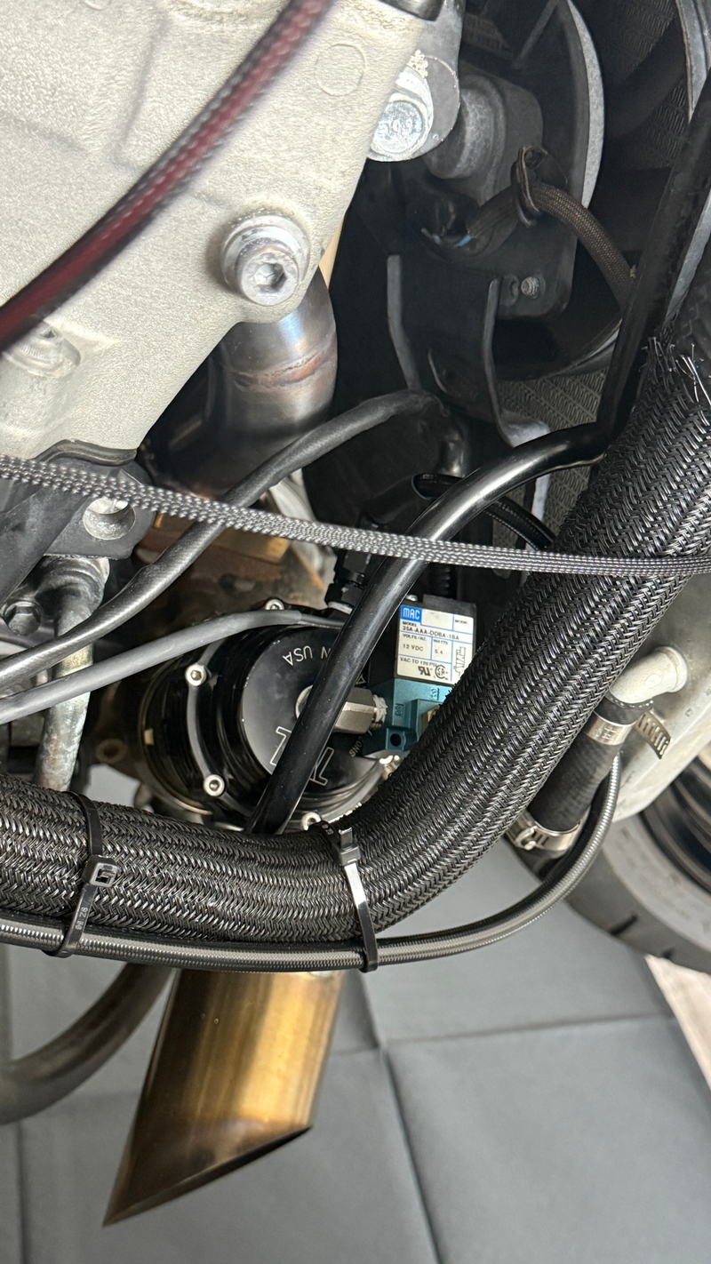

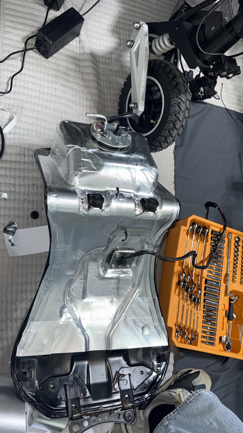

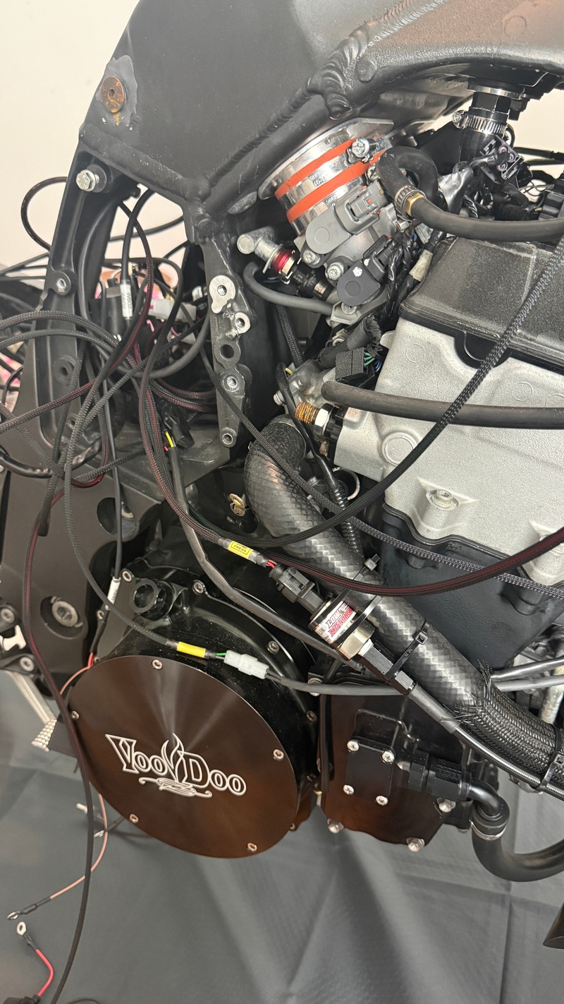

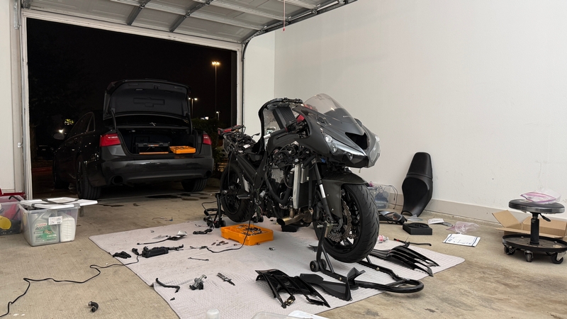

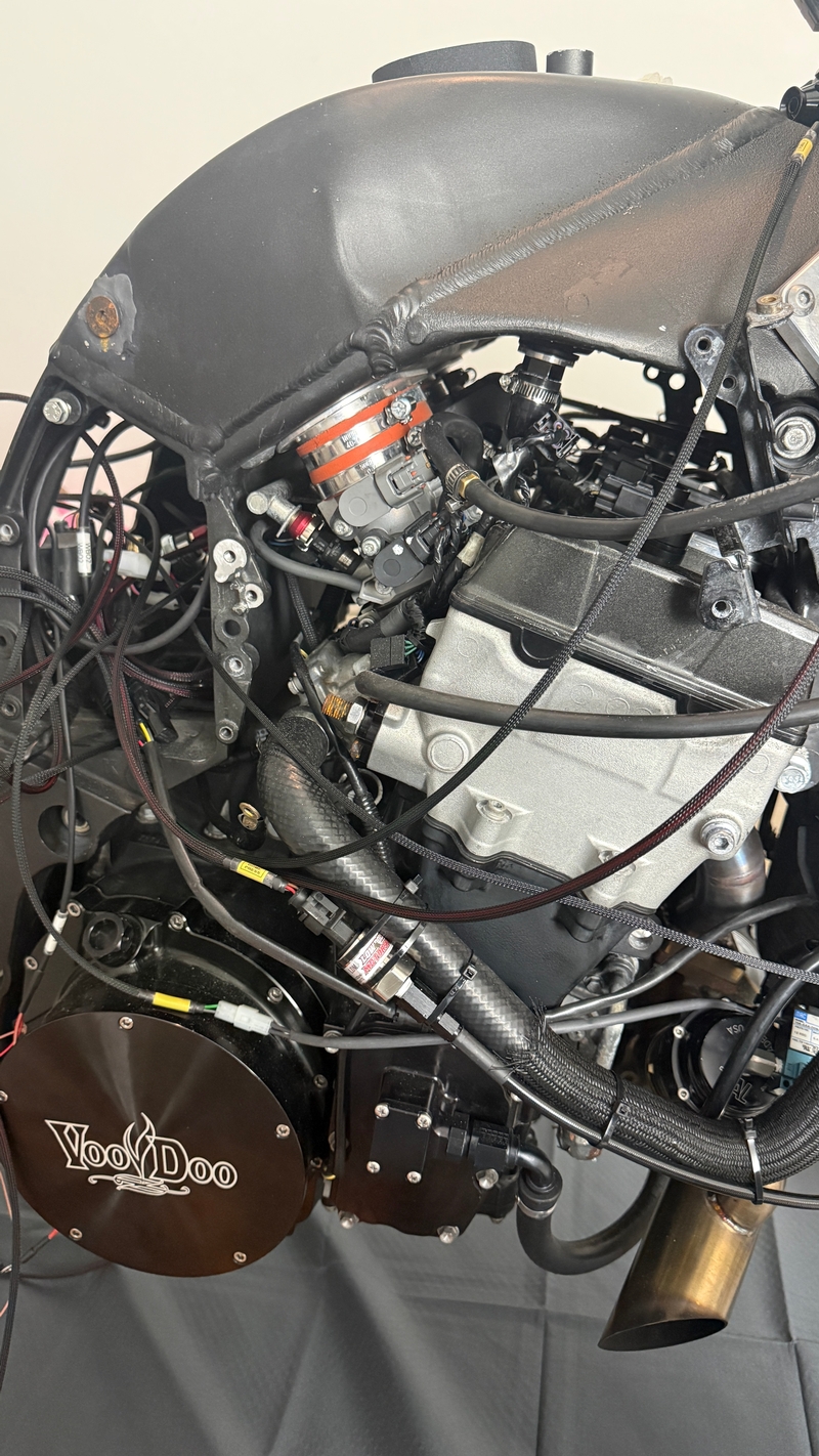

Garage is set up now (80% set up)
Couple of things i've been working on-
* Maxx install
* AN6 fuel lines with pressure sensor and ethanol sensor
* deleted IAC system
* swapped my Amazon Brand coil packs for new OEM's
* heat wrapped my gas tank (I am bored and waiting on parts) + (I reinstalled the original shield in addition to the wrap)
* mocked up my air compressor routing to be inside the battery box
* identified a bad connection with my stator/rectifier and soldered the connection(no wonder I had weird battery issues all the time)
* bought a bunch of goodies that are back ordered from Schnitz. You could add coupon codes on top of the black friday discounts... 15% off + free shipping + no tax on my fuel pump = air shifter kit is paid for and then some.

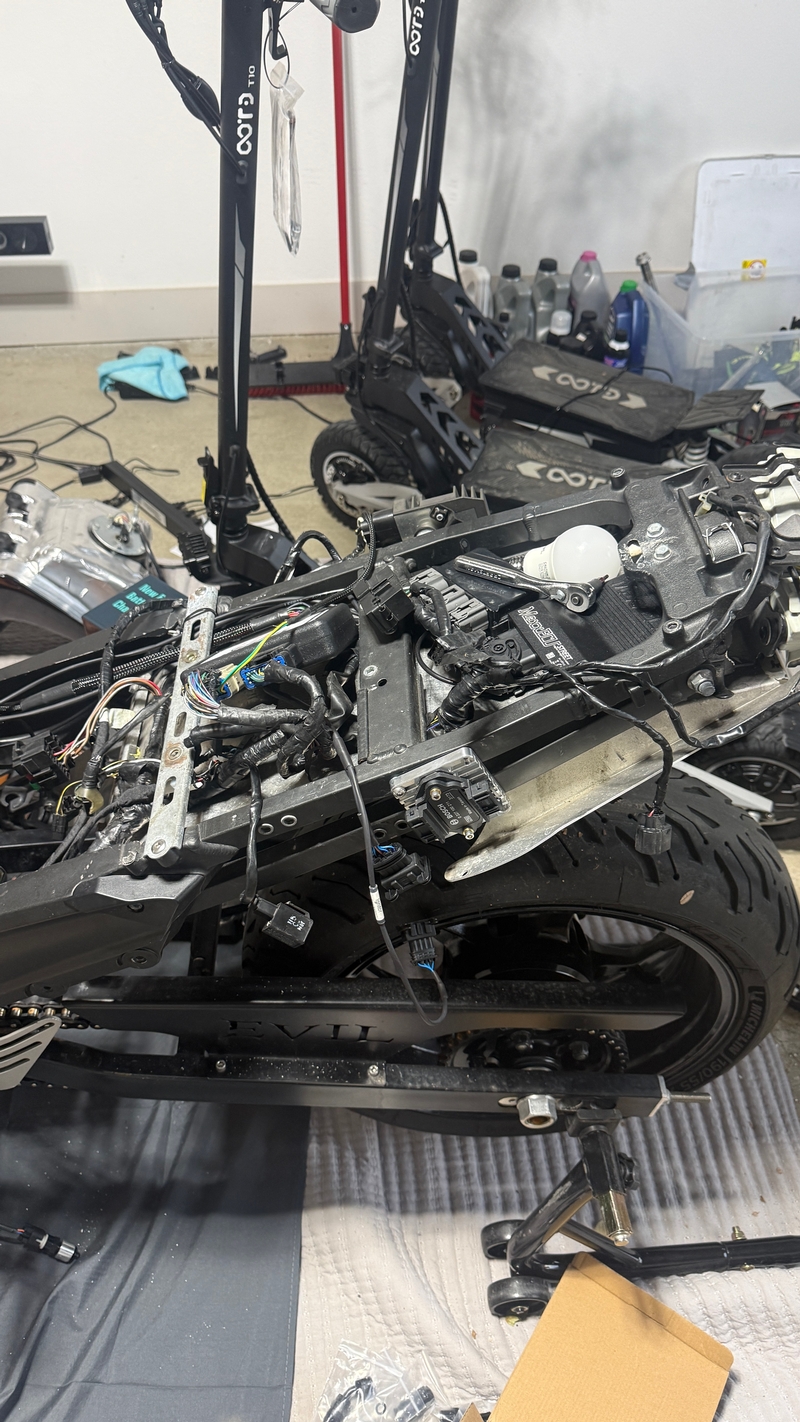

ignore the light bulb

To Do list before I take it to my tuner:
* Install air shifter kit
* Take intercooler to shop to have 1/8 NPT bung welded on for intake temp sensor
* Swap lithium battery back to AGM for the extra protection against voltage sag while running all my electronics
* Figure out where to install ethanol sensor + fuel pressure sensor (larger than imagined)
* Repair broken fairings from idiot neighbors bumping into bike before I had the garage
* Swap rear tire to Q5S or Dragmax or something ready to handle 400-500hp
* Swap rear sprocket to something halfway decent (I have to slip my clutch for so long when street riding)
* Double check my clutch springs are correct (I am seeing a lot of clutch material in my oil changes after about 200 miles. maybe slipping before the lockup engages?)
* pressure test airbox for leaks
* oil change
* winterize cooling system
* clean chain
* clean out swingarm air bottle
* figure out routing for rats nest worth of wires under the seat and in the battery box
* Last updated by: danmin on 12/10/2025 @ 9:04 PM *
Posts: 21532
12/11/25 8:01 PM
Nice new garage!
The Gen2 Hayabusa has this stock. I don't believe in the rubber heat blankets the 14 has. ....at least not for a stock bike. The oil cooler is a pile of BS too.

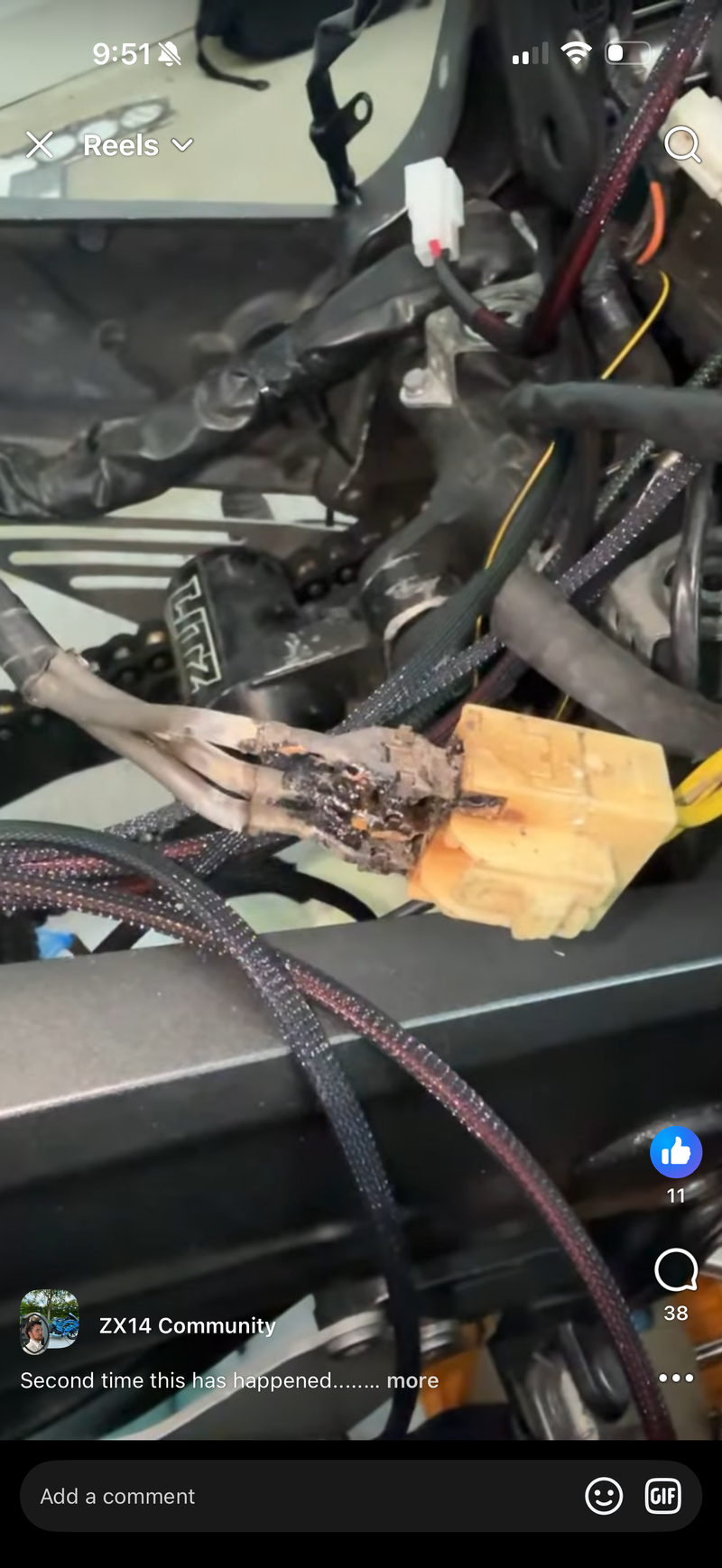

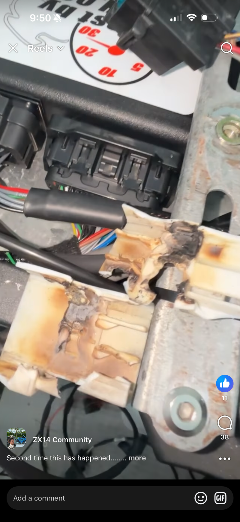

"second time this has happened" ....that was you? I was watching but had no idea it was you. No suggestions, just I wish you well with figuring that out.
This is a good thing! Secret hidden space needs something cool to go in it.
Good. This the kind of auto shifter a 14 was meant to have.
