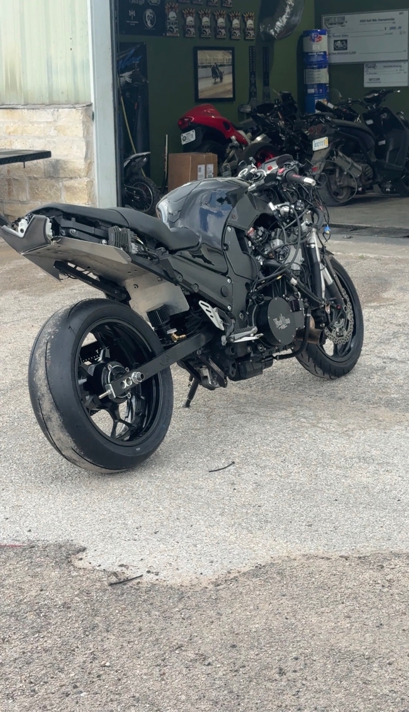

March 3, 2026
Bike dropped off at Boomstune for:
-MaxxEcu Tune
-Swapping SAE Outlaw Headstuds to APE
-Installing HD Cam Chain
-Degree cams
-Starter upgrade
Will end up having power modes, and will scale the power according to power mode as well as ethanol content.
Max power- 500hp
Low power- 300hp
I didn't feel like tearing into the engine again. The time/expertise/cost/margin for error made sense to pay Boomstune to do it. Small cost to also have his blessing on the rest of the engine build.
Estimated pickup date will be Mid-April. I probably won't be on here too much as work has picked up and so has my desire to find someone to ride on the back of the bike. I'll poke in every now and then still.

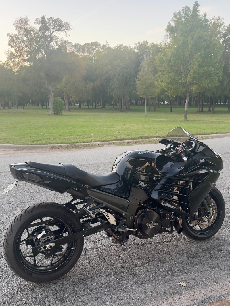

Found this picture of the bike from October. Looking forward to getting it back together. After seeing a friend's Montgomery Headlight Deletes with the added 2 Projector bulbs, I am looking forward to the 12 pound weight reduction + ease of fairing install + reduction of squeaks and headlights bouncing.

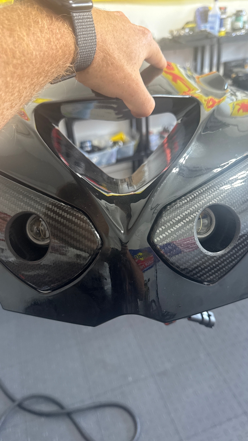

Montgomery Headlight Deletes installed. Fitment leaves a little to be desired... Not sure anyone will notice when they're on the bike. The pair weighs 1.5 lbs. Not sure what the old ones weigh, but it's significantly more than these carbon ones. Weight difference feels like going from lead battery to lithium. Also no headlight bracket used anymore. Delete plates install onto backside of the fairing and that is all.
Still no word from tuner. Motorcycle tracker tells me that the bike hasn't moved in a few weeks

I see a sliver of light peeking out on the bottom corner. If that's the fitment issue, I wouldn't worry about it. No way is that going to be visible when the top cowl is installed. It might have even been intentional to make sure the inserts do fit. I can't wait to get mine! Those look great!

If the headlight fitment really bothers me, I can always run a bead of silicone around the lens to seal it up good. Also, you need to put superglue on part of the led projector housing. there is a plastic pin that holds things together. This pin fell out on my buddy's bike. Also his adjustment bolts have come loose. I am going to put threadlocker on the adjustment bolts and take pictures of the superglue on the pin so anyone else can do the same, if needed.

Asked the tuner for a clarification on timeline. I am not holding my breath on getting it back for another month or so. The other bikes like mine he had planned on breaking down and building are also behind schedule. Tuner has been at events all over the country for a few weeks. Not sure when he has been back home to work on stuff in the past month
