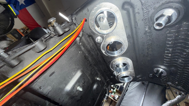

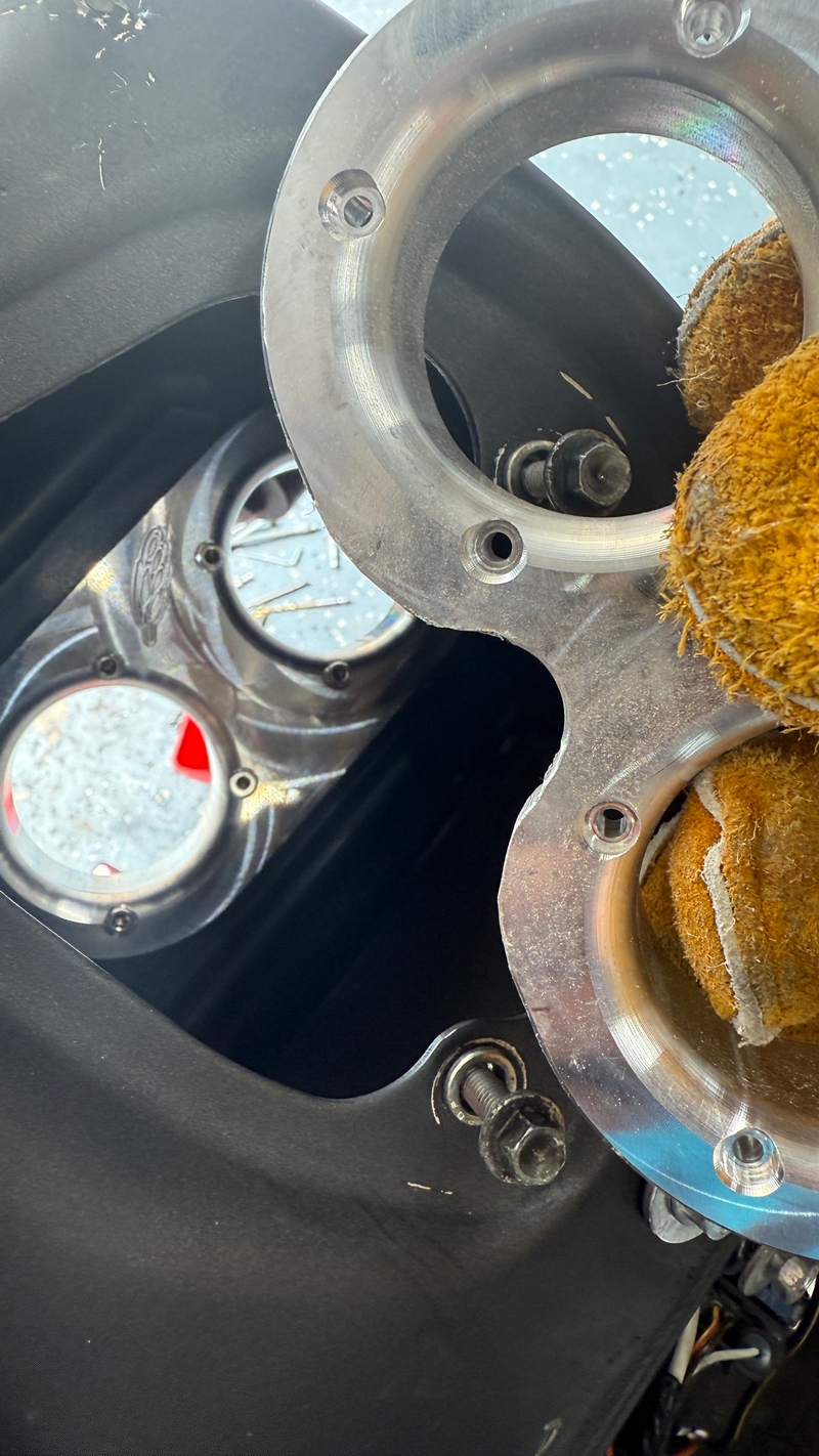

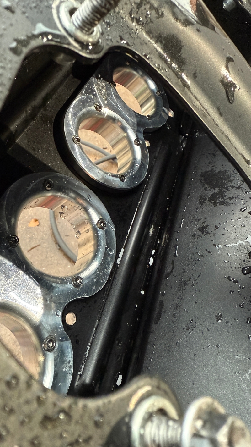

Cut Brutal plates to fit secondary injector rail. Bummer to cut up something that good looking and shiny- but there wasn’t another option besides shortening the spacers on the injector rail mount. Pictures show the rough cut complete on one plate. The second picture shows the holes (3) drilled after both plates cut and installed. So many metal shavings that I decided to hose the frame out. Lots of glitter and dust as well as large chunks.

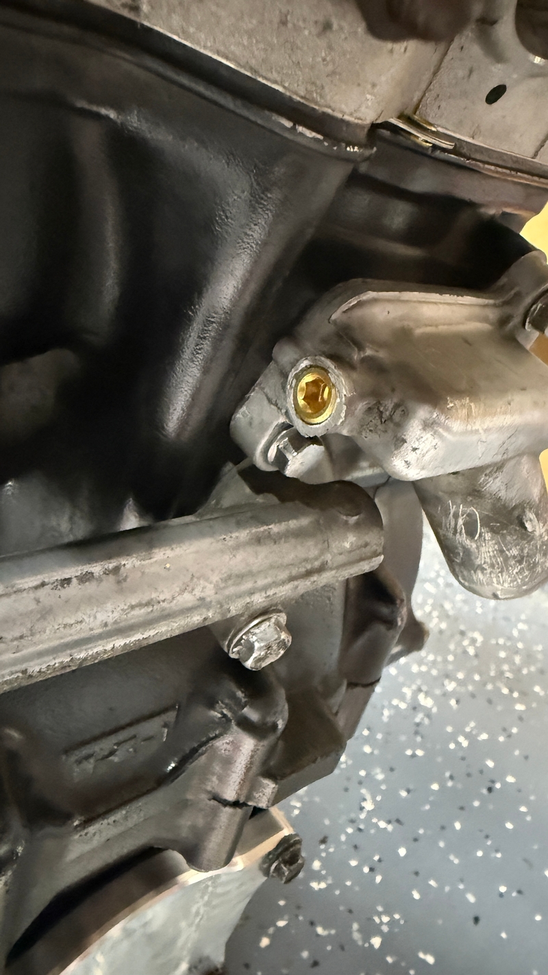

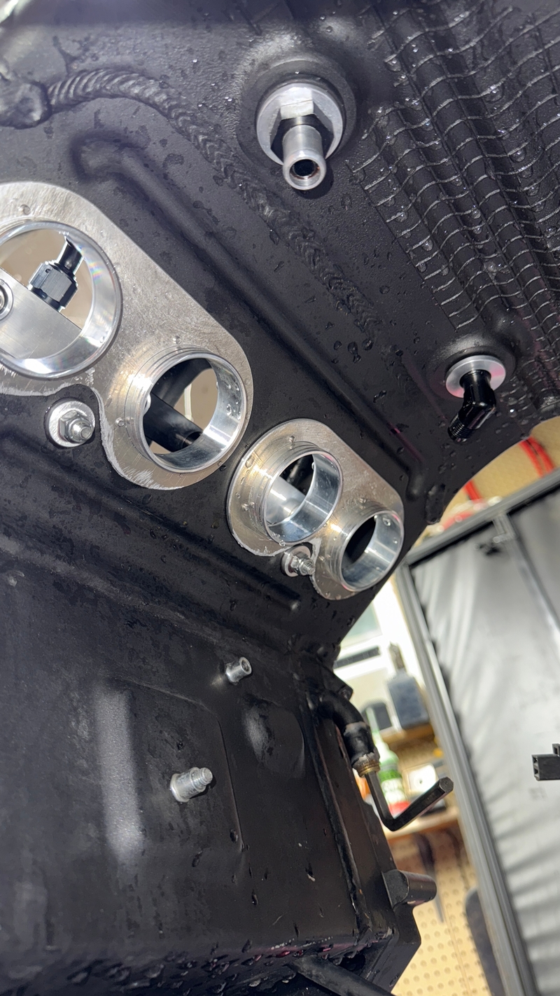

Installed block off coolant plug. I broke the stupid little neck that is normally on this piece due to the factory hole being drilled uneven. This caused it to crack. I took the whole neck off and just drilled and tapped where the neck sprouts out from. I still need to do this with the Crankcase Vent.

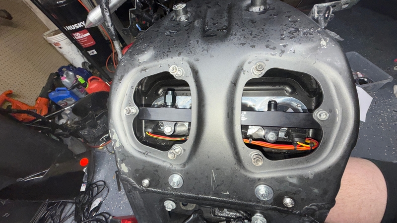

04/30/25 8:08 PM
April 30, 2025
Installed Secondary Injector Rail. Also installed fuel line and Idle Air Control sandwich plates.
The Stage 2 Fuel System Install Instructions are not extremely detailed. It’s sort of like “drill holes in this area, then install everything. Here’s a single picture to look at.”

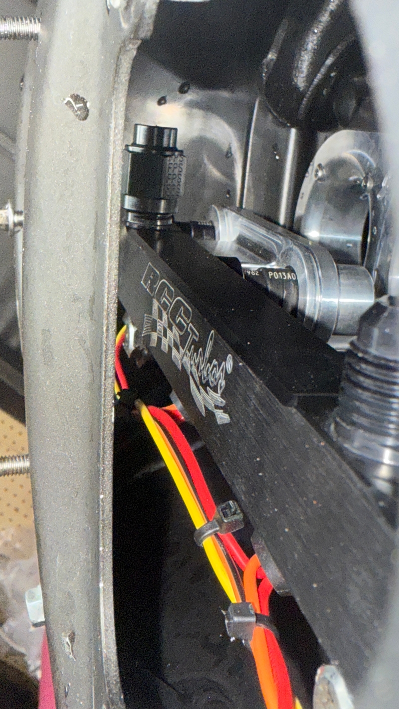

04/30/25 8:11 PM
April 30, 2025
More Pictures.
Bottom plates are ugly- but they do the job.

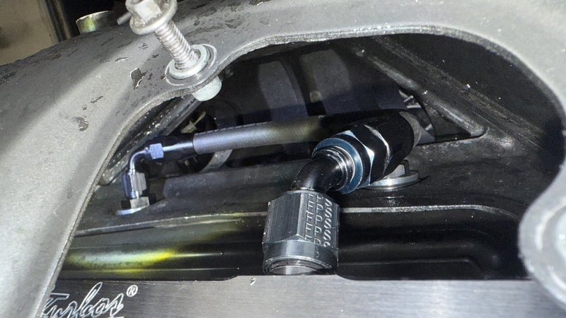

04/30/25 8:12 PM
April 30, 2025
Last picture
I somehow had the idea the fuel rail went under the air box where the stock injectors are. It goes right inside the air box like a nitrous spray bar. ...so this thing squirts fuel right down the intakes like dry nitrous?

05/02/25 10:30 AM
I was on the same page as you. Yep the injectors mount inside the airbox and spray like nitrous. right into the throttle bodies.. kinda. little bit of an offset so it’s not exactly square through the throttle body. But almost. Probably going to take today and maybe tomorrow off of progress. It’s my birthday.

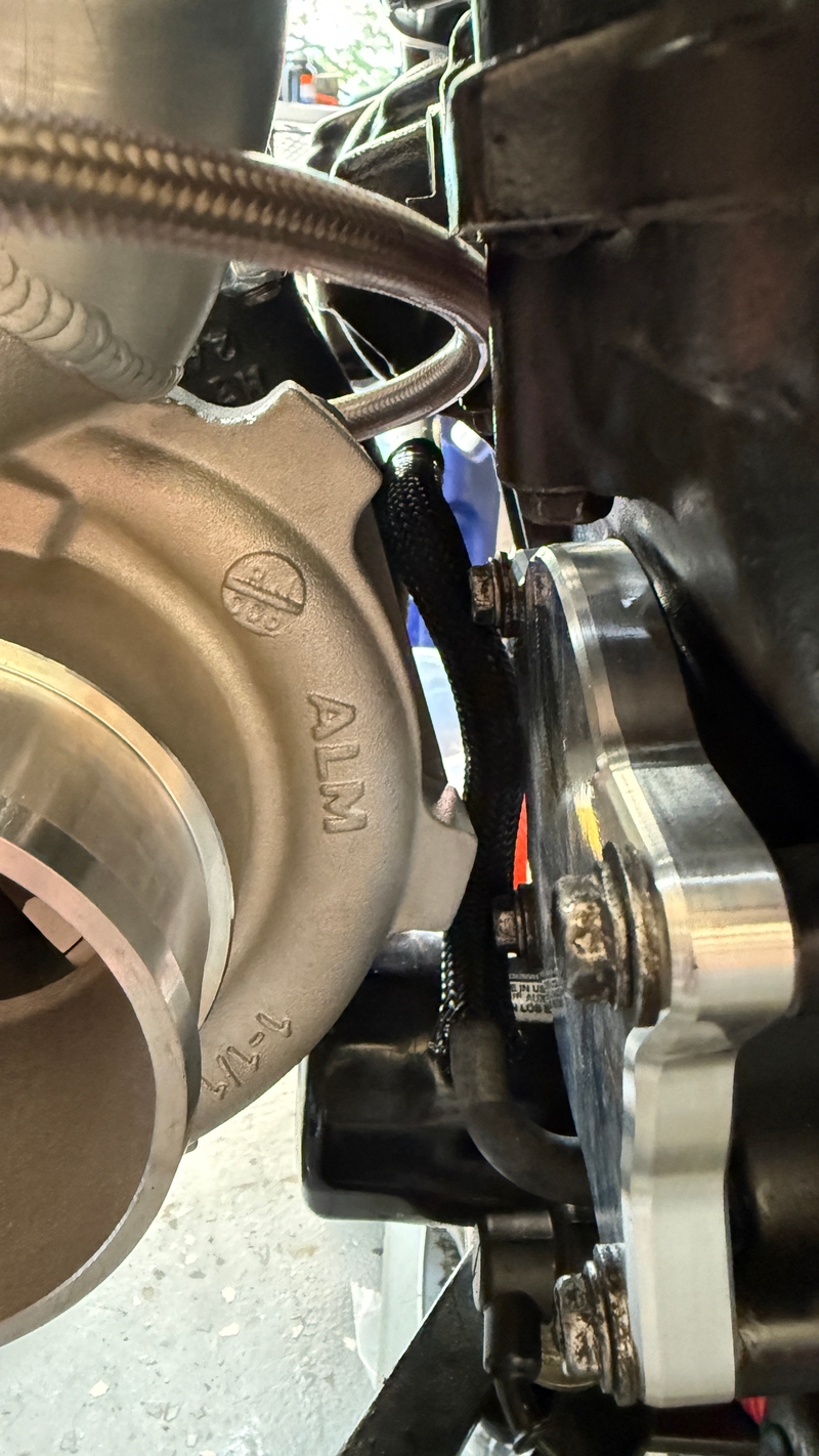

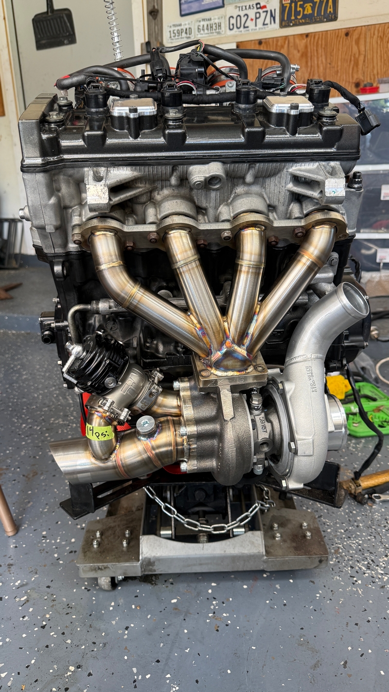

05/05/25 12:16 PM
May 4, 2025
Turbo installed. I had to remove and reinstall the piston oil squirter feed hose a few times to bend and hammer it to allow for the turbo to fit. As pictured in the second picture- it was making contact with the hot-side of the turbo (yikes) and it blocked the turbo from seating in the head's exhaust holes properly. Also installed the exhaust pipe (I would do this BEFORE installing turbo onto engine). I swapped the wastegate springs to Red + Green which is 10.15 PSI. This is a hugely difficult task to do. I used 3 zip-ties to equally and slowly move the lid of the wastegate onto the body so I could bolt it on. I had zip-ties break more than once. I also had to remove the water neck on the front/head of the engine and clock the turbo. The cold-side outlet was pointed in such a way that would not allow the water neck to be installed. 1/2" wrench and 5 mintues fixed that up.

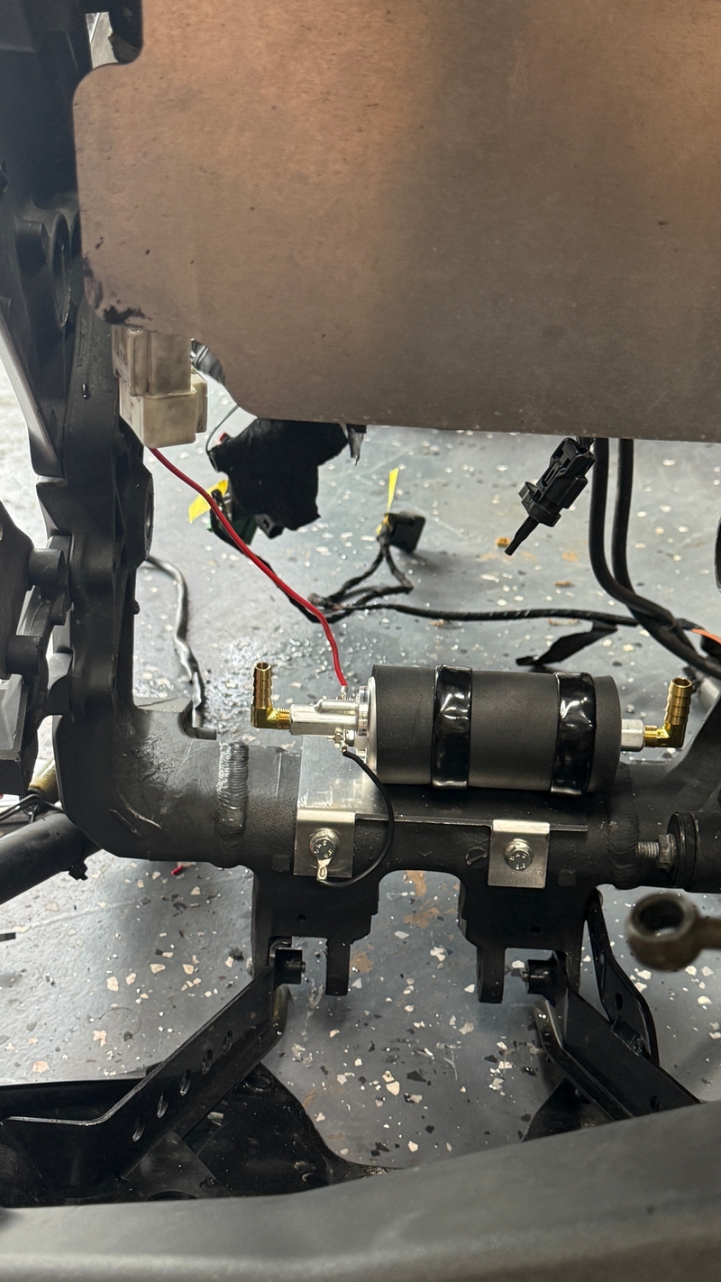

My dating life took a turn in a direction that gives me exponentially more time to work on bikes. So my planned vacation from turning wrenches ended early. I am planning to get the intercooler and the odds and ends wrapped up today, or I'll install the engine today, but likely not both. I also installed the fuel pump and some lines already.
That must be the one covered with the black woven sheath, right? Is it a solid tube or is it a hose of some sort?
Seems like they should have had the fitment of that part perfect. There's been a couple times where I had to use spacers or do a little filing to get simple aftermarket parts to fit but this is pretty complex. ...it should at least fit with itself even if it might need a little tweaking to fit the bike.
The brand new turbo looks beautiful! I imagine it will gradually become darkened and crusty on the outside like a used stock header though, hey?

Oh yeah. BTW Rook. The tube is part aluminum pipe and part rubber hose. I had to bend the aluminum to hug the case better near where the oil cooler is. Somehow this one was bent a little bit. It also isn't the original engine so it might've been bent up by the previous owner.

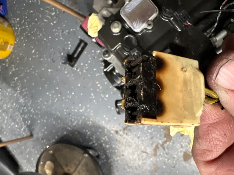

Looks like I need to review the charging system…… Looks pretty well-done to me.

Hey Dan, my guess would be that was overheating from either loose battery cables or a poor negative cable ground. I believe that would cause the stator which is virtually the voltage regulator to increase output in an attempt to show the ecu the target 14.0-14.4 volt input? I have a few donor harnesses so when you get back to it look over the whole harness and let me know what connectors you need. Just cover the ride and they're yours...
