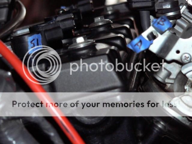

15,000 mile REPORT
I was still needing to add oil for two years after doing the washer fix shown in this tutorial. The need to add oil has become less frequent over this period and now in year three, I am ready to remove the head cover bolts again so that concludes the test. In this, the third year, I have not noticed any change in the oil level although it has only been in the bike for a few hundred miles.
The ringos look as though they are compressed more than they should be.
RIGHT AFTER WASHER WAS INSTALLED, PRETTY NORMAL LOOKING SHAPE
TWO YEARS LATER, RINGO EXPANDS AND PROTRUDES SHARPLY AT BOTTOM. DEFORMED BUT LEAK IS MUCH REDUCED
NEW RING-O, NO WASHER, NEW HEAD COVER GASKET AND SPARK PLUG GASKETS--PERFECT SEAL AS OF 2017
I have no picture of the front of the engine but what I see is just a slight film of oil which has accumulated dust just below the front of the head cover. It extends between the region of the left head cover bolts and the middle head cover bolts. This stands to reason. The middle bolts are situated closer to the right bolts than the left (see the pic in step 5 of this tutorial). The middle bolts are not centered so there is more pressure being exerted on the right which has sealed the gasket better. However, I don't consider the slight film that has developed over the last year to be objectionable compared to how it was before the washer fix. It does not even run down as far as the exhaust manifold. It would be a simple yearly maintenance task to clean this each year. I'd say the washer fix was a big improvement but not a total cure. I do not feel comfortable torqueing the bolts tighter. Possibly damaging threads in the head would not be worth trying that. We've been over that topic in this thread and opinions differ.
Next, I will be replacing the sparkplug gaskets and the ringos and head cover gasket with the updated parts. Hopefully that will stop the seep 100%.

RE: Head Cover Gasket Leak Fix
04/10/17 6:06 PM
Updated.
Yes, replacing the head cover gasket, ringos and spark plug well gaskets stopped the leak. The bike still uses a little oil between changes but it's not leaking and as far as I know, it's not burning in the engine.
