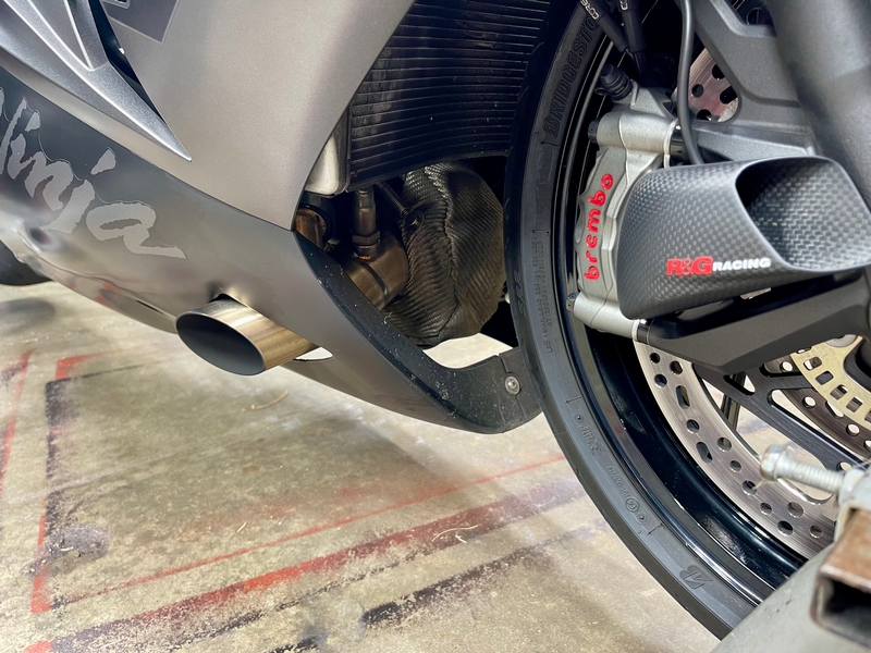

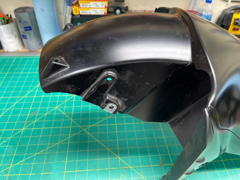

• Trimmed a little bit off the back of the front fender to prevent it from hitting the radiator.

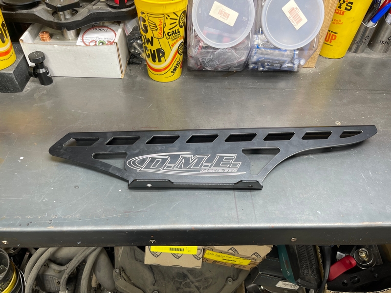

• Trimmed a little bit off the front of the chain guard to prevent it from hitting the subframe.

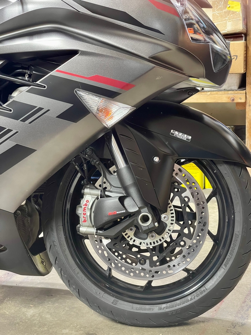

• Installed a couple front brake caliper air ducts.
• Installed a cheap turbo blanket from Amazon.
• Fixed a couple oil leaks.
• Removed links out of the chain and moved the rear tire forward about 2 inches to improve traction.

I'm digging the front caliper scoop! I think I have to do that even though I doubt I ever get my brakes really hot.
Speaking of hot, looks like you are getting some meltage on the lower fairing...or is that just a reflection?

The plastic is okay. Haven’t had any issues with it melting yet.

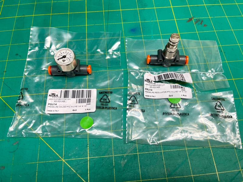

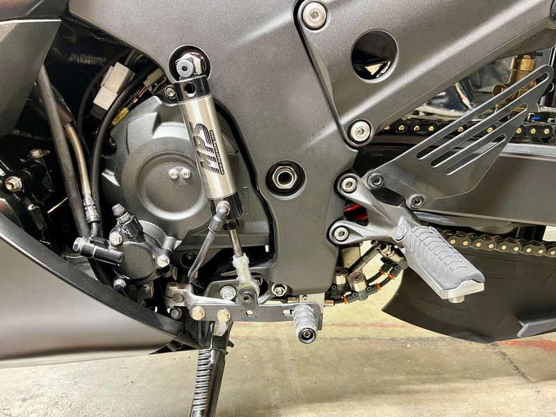

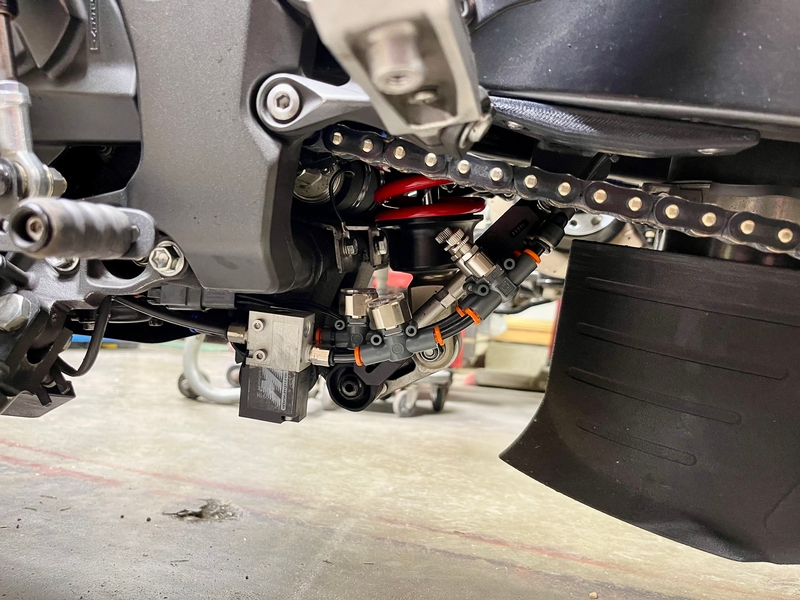

I’ve been doing a lot of runs with the bike lately working on boost maps. I’ve also switched it over to e85 and started working on boost maps and some small fuel table adjustments. I did get the air shifter installed and working. It would have been a lot easier if I would have had Greg setup the original wiring harness for an air shifter.
It’s taken some work to get it working good. I had a a few miss shifts. I had to play with the shift cut times and I have a weird issue with the co2 tank regulator where it doesn’t hold a consistent pressure. It starts out reading say 150 and I’ll look at it later and it’s 120. I replaced it with a different one and it does the same thing so I’m starting to think maybe my clamp that prevents the knob from turning is somehow causing the problem.
So today I installed another small inline regulator for the air shifter in addition to the one I installed for the boost control solenoids and set the main regulator at 150. I went out and did some runs and it seems to work good. I may play with cut times a little more. I have it set to kill fuel and ignition right now. I may also try setting it to only kill ignition and see how that works.

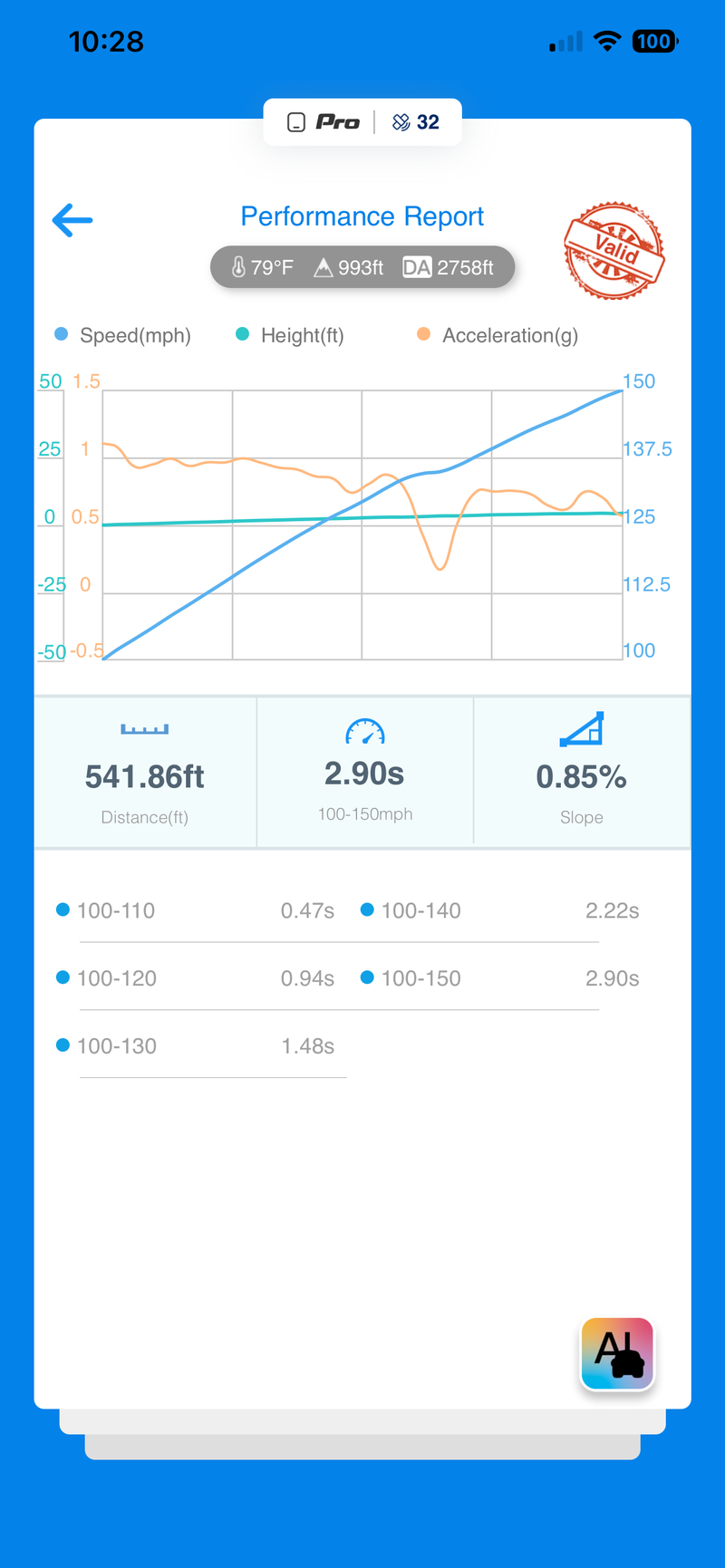

As far as your 60-130 time goal goes all I can say is I have had to work really hard to get into the low 3’s. Today I finally managed a 2.95 60-130. Until recently I’ve been doing all of my runs on asphalt backroads and on them I can usually manage 3.08 to 3.20 60-130 times. On a concrete highway I was able to run a 2.95 60-130 today. I think I can add a little more boost towards the end of 2nd gear. In 3rd gear I’m running 16-17 psi of boost so there’s not much left there. Currently I’m reading around e75 as well.
Here’s a couple 60-130 videos. The 1st through 3rd gear run was a 3.13 and the highway run was a 2.95.
https://imgur.com/a/39pAmD0

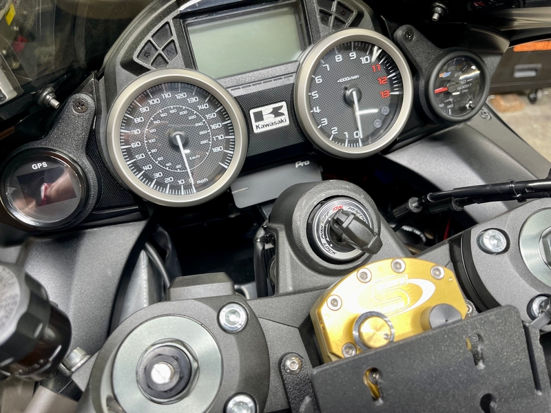

Here’s some pictures of the air shifter setup.

LOOK at those tiny gauges under there! The shifter setup is really cool.
The foot quickshifter I used required something like 80-90 mls of kill time to be reliable at high rpm. It caused a palpable jerk when ignition came back on at WOT. I could have lived with that but I felt clutch shifting was just as fast and very reliable. I have a hunch an air or electric shifter is more appropriate for these larger engines and also that they do need a little more time to make a clean shift than a liter bike or smaller.
I wish I could watch your videos. The old version of Safari I use is slowly not working with more and more of the internet. LOL it still works fine with this site though, ninjaforum runs on older tech than my 2015 Mac does!

Currently I’m running .065ms on 1-2 shift, .060ms on 2-3, and .055 on the rest. 120psi to the air shifter. The small regulator and gauges are pretty cool. I’m not sure what they’re intended for but they work good. You can send me a email or text and I can share the videos with you.
Sixty-five milliseconds (.065 second) was the manufacturer suggested general kill time for sport bikes with "slick gear boxes." It often caused the higher rpm/hard load shifts to stick in false Neutral. I tried preloading the shift pedal and using higher and lower sensitivity (how sensitive the strain gauge was to pressure) but nothing seemed to help.
That sounds like a strong blast of air just to click the shift lever. I'll bet that's why it works so well. It would be hard to duplicate that much power instantly with a foot shift. There are milliseconds wasted as the foot is moving and more while all the mechanical parts move in response to the foot shift.
