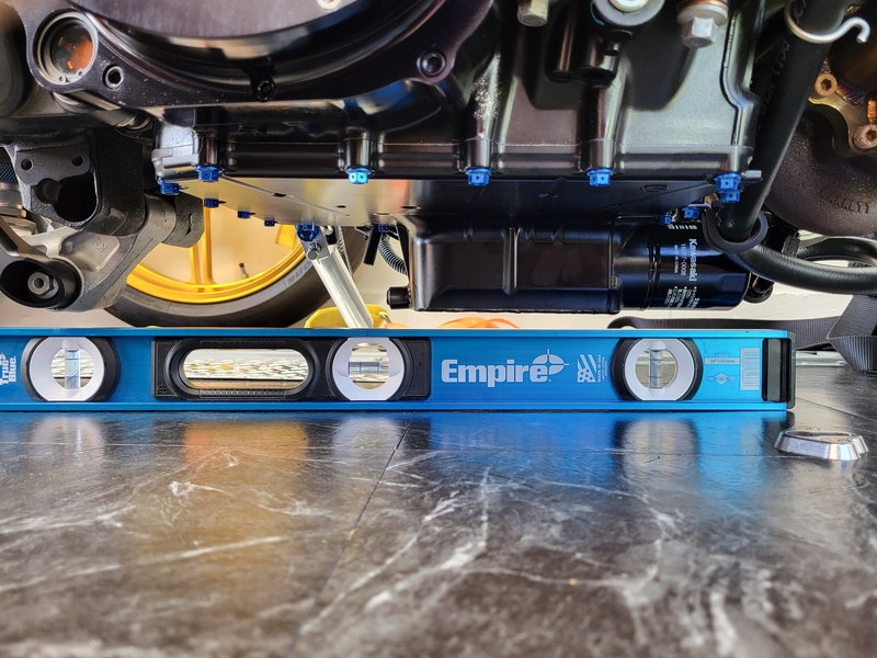

You haven't mentioned if you have a boost controller? Also what track or tracks you're going to run? Fully prepped, concrete launch pad and how long or full track? With your size option 3 should be avoided at all cost even going 45 degrees if you're using a stock oil pan. I'm using the Schnitz/OSR factory cut pan and it's saved me more than once. Oiling down the rear tire under acceleration never ends well.

So right now my main track which I’m probably gonna be at most of the year is a 1/8 mile prepped asphalt track. I do have Adam‘s low profile oil pan. I made sure to get that because I scrape going on a trailer and stuff anyways. I do have the Adams flat link and Adams adjustable arms for the rear and I do have a spring that is rated for more weight than the factory spring. still factory shock but of course I’ve got the screws turned all the way in. Far is boost controller. It’s just a spring rated wasteGate with the lowest Boost spring in there.
