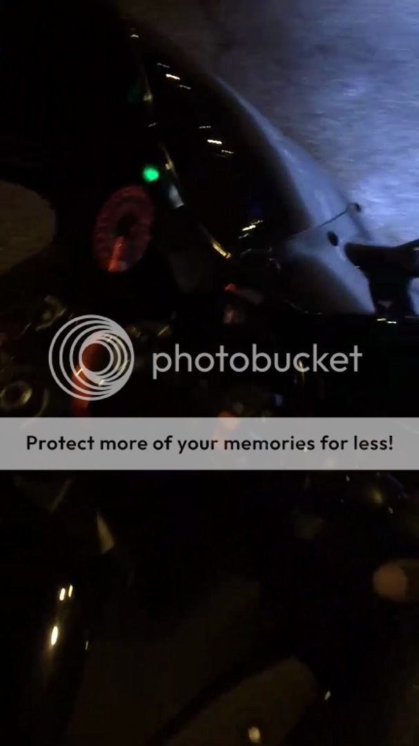

As of now we have removed the clutch basket and all looks fine. Plugs and could replaced and nothing. The next step is to open up the case unless one of you great folk on the forum have any suggestions. I took a video of how she sounds after the oil change maybe this will help. I wanna thank you all in advance for any help or advice you may have. Sorry for any typos.
Here's the link
http://vid392.photobucket.com/albums/pp8/Travis_RRtravesty_Brown/Mobile%20Uploads/trim.B0FBDD0A-8118-4803-BC43-ED7862DC21C1_zps8zphxg17.mp4

Im not a mechanic but that does not sound good. I would not run it anymore and bring it somewhere for a motor tear down. I am guessing but sounds like its skipping or running on two or three cylinders. Maybe a spun bearing or blown head gasket.

I ran my busa on 2 cylinders when I had a connection issue withe Bazzaz. never noticed anything unusual about the sound or even the performance in a low speed test run. It really sounds pretty normal unless you are listeniing for something wrong. Yeah, I'd say it's missing a cylinder.

Agreed this is serious. If you've heard big clanks something big happened. IME normally spun bearing is more of a knock (like hammer against an iron block sound) than the sounds I'm hearing.
