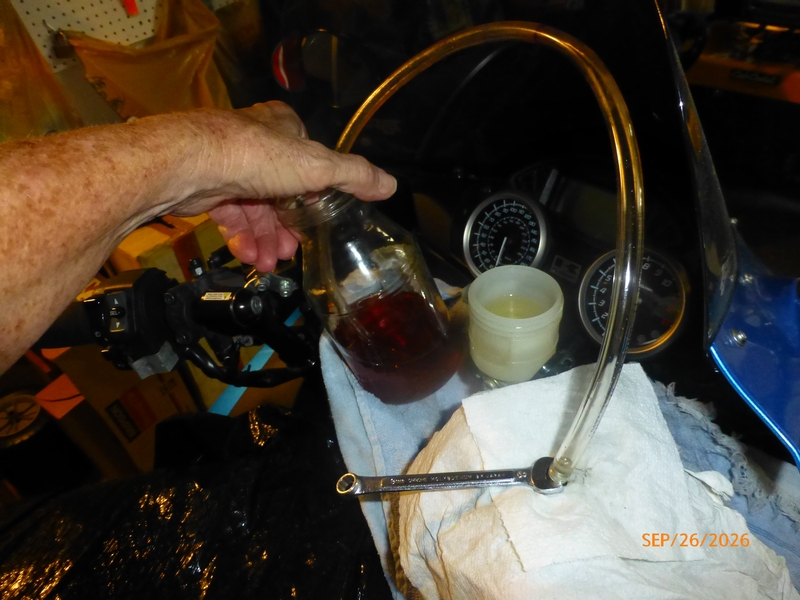

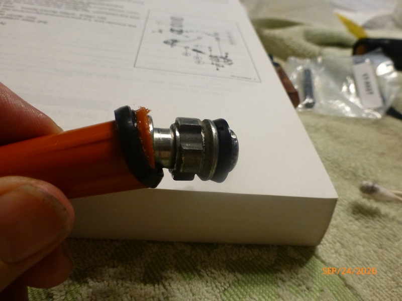

Update with pictures.
I did a rebuild of my MC brake cylinder. It had been burping air for the last 2 years through the bleeder. Last week the lever went to the grip.
I ordered All Balls mc kit and replaced the seals. Boy, that was a fight getting the large seal on. I cut the end of a funnel and used silicone with lots of pushing to get it on.

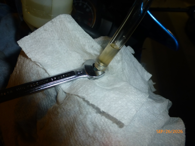

I spent hours trying to get results with a passive bleed at the caliper. That did nothing.
I watched many YT videos and no one shows this procedure.
Hub, I read your last post and with 4 squeezes I got bubbles then fluid.
Thanks.
* Last updated by: doubleD on 9/26/2026 @ 9:29 PM *
