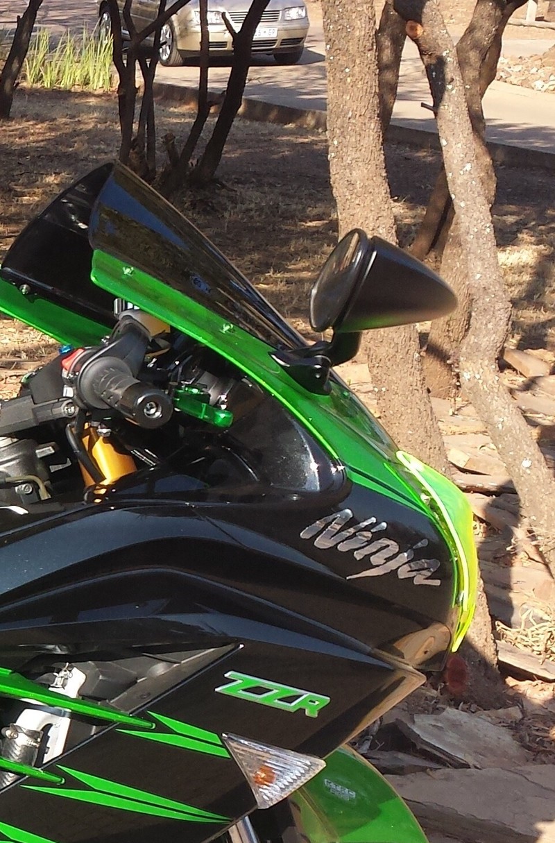

The "Ninja" on my front fairing did not come standard on mine. I had it made locally to the same spec as OEM.
It's been on through rain, sun, sand, washing and still there as new as the day I put it there.
