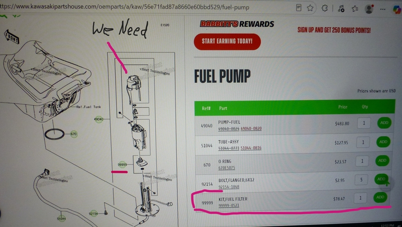

doubleD
doubleD's Gravatar
Joined: 06/16/14
Posts: 453
RE: Fuel Filter
10/06/26 12:00 PM
Chris peters, can you give an update?
Does the substitute fuel filter hold pressure and work for how many miles?
I found a YouTube video of a performance shop (Proven Power Cycles) in Florida. They had a 2016 ZX14r with 57,000 miles. The complaint was it felt like the clutch was slipping. The guy put the Bike on the Dyno. The Bike was leaning out at 7000rpm. He installed a new OEM fuel pump and the lean went away. This shop has many videos on the ZX14.
It is the inside fuel filter. Has anyone be able to reglue the fuel filter housing after cleaning?
Does anyone have the "ear" of Kawasaki to see if they could sell the top separately?
https://www.youtube.com/watch?v=N_S70XEeIxQ
