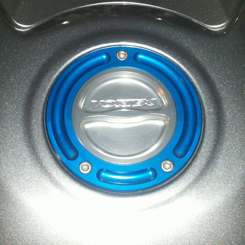

Anyone have a pic on their bike? Does it just bolt on and you don't need to replace a seal or something? Thanks for any help.
RE: Anyone have a Vortex gas cap?
03/09/12 10:05 PM
Just bolts on. The base and cap each come with their own seals.
I assume the Vortex is a 1/4 turn type?
2 full revolutions, from the position in the pic, to remove.

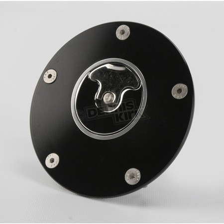

DogoZX or anyone...did you happen to notice the venting on the Vortex?
I want to buy the Vortex model you show in the pic (CP403K) but there's no mention of venting in the spec's. Other models Vortex sells DO include venting info and how their venting is "better" now.
I have to assume the Vortex works fine but have you had any issues with venting/fuel flow?
03/30/12 12:13 PM
The Vortex has a vent... Can't say that it is better than the one on the factory cap, but it works just as well.

I decided against buying the Vortex. I wanted the "classic" Vortex, first generation or whatever you call it.
But I kept reading about poor venting and leaks. Maybe some guys have good ones but I'd probably get a leaker. Even in that video in this thread the guy has trouble talking up the new V3 without making the classic design sound bad. The classic I assume had finer threads that could cause cross-threading on top of leaks and poor venting. It's funny as he talks about the new and improved coarser cap thread but you can see he never gets the cap threaded in right as he's talking to you. Another thing about the older Vortex was the cap was hard for some to grip because of the shallow turn handle.
Anyway, I was disappointed because I liked the all black Vortex and the new V3 is too mechanical looking for me.
I looked around and decided on this.....
It's from Roaring Toyz. Found it for $68 at Dennis Kirk.
It's billet. About 1/2 the weight. Anodized black. 1/8th turn. Check valve for venting.
You flip up the lever as you would the stock cap and turn 1/8th to the left. Opening is about 2" diameter. I just recieved it today and it looks nice. Operates smoothly. I didn't install it yet because I had to work on the bolts they provided first. Sanded down the numbers on top the heads and made them smooth. Then I painted them black. Will mount tomorrow when cured.
Funny I decided on it because I wanted all black to kind of hide the cap. The center is chrome, about 2" diameter. But it looks OK with the reflective Kawasaki badges on the tank and I do have polished wheels and stainless cans and a few other small chrome bits. Hope it's a good choice.
