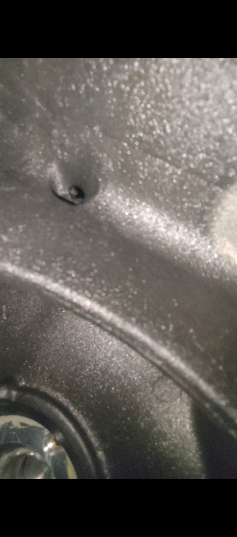

Imagine my surprise when I see smoke billowing out from UNDER MY STEM BEARINGS. I had noticed recently some oily residue around my horn that I assumed was just the head stem bearings starting to go bad and leak some grease residue, but its actually leaking boost from inside the head tube, which I have never seen before. Got a camera inside the airbox expecting the worse(cracked frame??? She's a heavy girl and doesnt get babied). I found way up front right in the center of a supporting spine a tiny hole leading to the steering stem tube, which you can't see from outside the frame but allows boost to actually get inside the head tube and force its way out of the bearings. Probably doesn't make it past the bearing seals on really low ~4psi setups, and its likely a small enough leak that most don't notice it, but it was surprising to me and thought it was worth sharing. Honestly looks intentional, like a vent for welding or something, but I guess it could be a defect/void.
To seal it was annoying but nothing crazy - its a rough bumpy surface already so opened one of the airbox covers and got my hand inside with a rag and some iso to degrease it as best as I could, then mixed up some JB weld that I awkwardly ran down the spine and around the hole until it built up enough to seal it. Its far from the entrance hole and tight around the forearm even with my pretty lean and lanky arms so might not be possible for some to get in there, but I was able to seal it and after letting it cure for 24hrs I tested again and zero boost leaks.

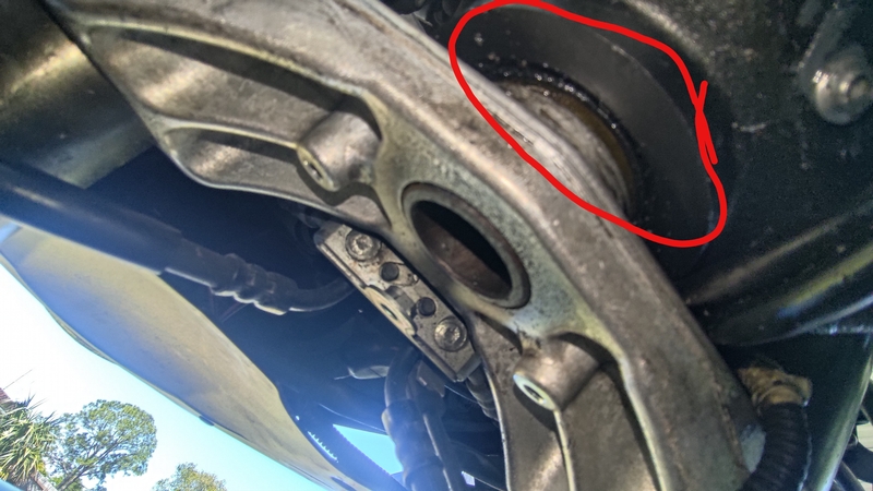

First picture is where the smoke was billowing out of directly over the front tire with the horn+shield removed for access.
Second pic is the hole I had to seal to stop it, view is inside the airbox, facing the right side frame blockoff/ pointing towards the steering stem. Its directly in front of the drain hole that is above the horn and is directly connected to the head tube, not visible from outside the bike.

In the first pic you can see the bolt in the top right sealing the "known" drain hole in the airbox above the front tire which is on the FLOOR of the airbox - this is a completely different hole on the front WALL of the airbox, that leads inside the head tube so it would never be found if looking from outside the bike. If I wasn't testing with a smoke machine I never would have found it.
