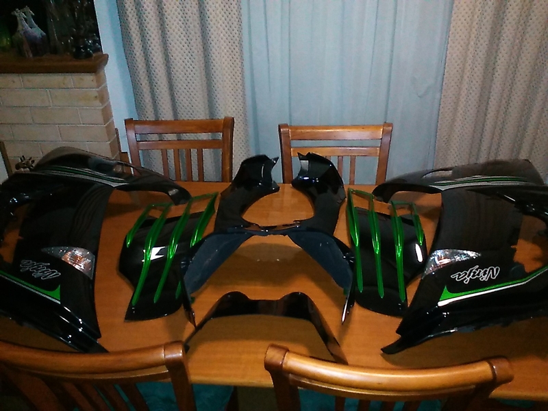

Good to know , thanks Rook bro . Just pulled the 14R fairings off for my first time , sort of comparable to the Gen 2 Busa in intricacy and complexity , maybe a bit easier even . I am enjoying just messing around with a different bike , so far , and will give it a careful clean today , and remove the stock exhaust .

I absolutely HATE those two clamps holding the lower fairing to the midfairing.I think they could have done better on those.Maybe a wellnut or something?In truth though,that whole side fairing CAN be removed in one piece.That's how I do it anyway.

Yes , those are a bit tricky , sort of floating suspended arrangement . I certainly needed the service manual , those were a thing that a newbie like myslf would of missed for sure . I have actually been checking out Brocks excellent tutorials on youtube , for the ZX14R , and they are an excellent help . I will remember what you said about both pieces removable together next time Grn14 , cheers .

Body work off , In my last post I got a bit mixed up , the main issue I had to watch for was the tank cover removal , the lug that the cover joins up to , that is sort of not fixed firmly , but hanging on a tag only with grommet . The mufflers are off , the bike will be cleaned , then the headers off , oil change and filter , then new pipe and pc5 fitment .

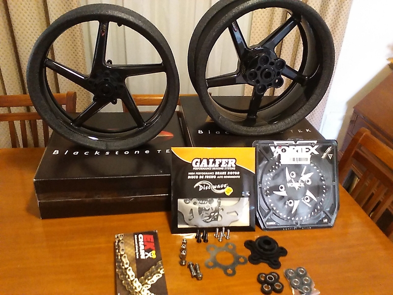

So the pipe etc. did indeed arrive yesterday , the Ohlins are back as well , so it time to start the fitment .
Pic of the parts now already to fit up .

Beautiful parts!!! Makes my heart sing!!
As far as the tire diameter, I'm pretty sure the Gen1 ZX-14 swing arm presents more limitation than the busa. there is a pic of the 200/55 pirelli I put on my 08 on the link below. That was with stock wheel base. I have a 45T rear sprocket but added a link to the chain. Anyway, just measured WB carefully last summer and it was stock length. So --- make sure your tire guy checks carefully if you plan on anything taller than a 200/55.

The BST's arrived today , very happy with them , now looking forward to getting them fitted up with RS10's ( next week ) and then on the bike . I decided on a Galfer rear rotor + ti bolts along with Vortex sprocket + ti carrier nuts and bolts , with a new EK chain . The BST's are fitted with ceramic bearings and are stealthed out black hubs , the rear is a beefy 6.625" . Here is a couple of pics
6.25" is the widest rim? A tad heavier but extra strong, I'm guessing.
Black hubs? Can you order BSTs in colors? I would like to keep the BSTs for my busa as black as possible but ordinary BST's often look grey in pics I see.
Why not the BST RapidTecs? Those seem to be the lightest according to my research.

These BST's are the original Black Diamond , the set is the R version , they are still natural glossed color / but with black aluminum hubs /centers . I am lucky enough to have the option of any wheel set for this bike , including the very lightest versions from BST , so the newer Rapid Techs , or even the latest Rotobox wheels . But I love this original style BST best of all for this bike , and only the 6.00" is readily available for any of the mentioned wheels .
The 6.625" is the biggest in this original BST style , made to drop into the ZX14R . The 6.25" is also available in this original type , but not in R form , but street as fitted to my Busa . If this huge size rim messes up the handling that bad , I will get a 6.25" replacement for street riding , and only put the 6.625" on for some drag racing etc . The billet disc carriers and sprocket carrier on my Busa's BST's for example , are in original natural finish , and can appear dull if not buffed a bit , where as this stealth black will probably show up dirt grime more .
With this bike especially and even the Busa , I am not overly concerned about maximum weight loss , having said that , I will be chipping away at it no doubt , because I like a lighter weight bike best . But if I was able to physically fit and really serious , I would definitely start off with a hot light liter bike , zx10 or a BMW 1000 RR or even a H2 .
The ZX14R though , was chosen , because it is the right machine for what I want from a motorcycle at this very time , I love everything about it so far , and it is an excellent companion machine to my street racer Hayabusa .
