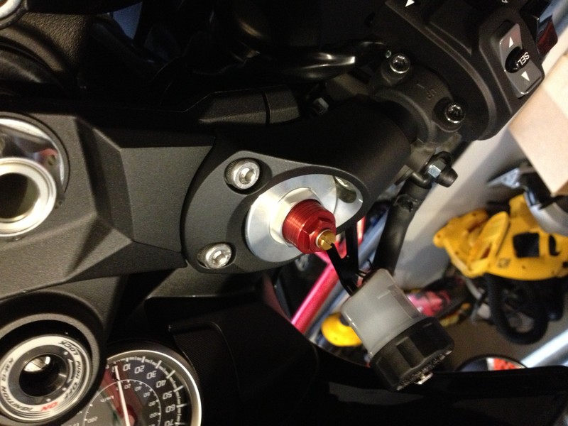

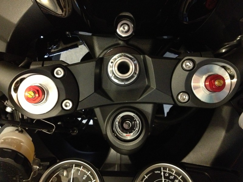

hmmm!? Weird. The bike was definitely turning sharper and I felt like I had to reach for the handle bar more, the setting in the second pic is definitely more comfortable. Also the guy who did my suspension is reputable and does track days, and provide service to racing teams. I'm trying to see if I can get a hold of him before I go to work this pm.
* He explained to me that he cranked everything up (first pic) so that the spring could break in and when I came back we readjusted to the current setting. The forks were never dropped, the geometry was just altered via suspension, sorry about the confusion.
* Last updated by: dragking on 5/21/2013 @ 10:12 AM *

Usually a few degrees off. Not a click out.

It is so simple to check. Stick a screwdriver in slot. Turn righty. Stop when you feel it come up firm. Do not force it. Count clicks. Back out same #. Do other side. If # is off, cblast is right. If # is same cblast is wrong. Either way at least then you will know and your front rebound will be the same.

Cblast: forked are matched. 4 clicks out on both.
I think I need more preload for sharper steering because like I have said the bike was sharper with the previous setting. Also you seem to have more than I have which is the ticket in my opinion.

RE: Tire Pressure for Street
05/21/13 12:03 PM
You'd have to spin one fork to match the analing. Then, this would cock the axle some if you change out tires, you'd have to dial the axle in again on the one fork float.
Or am thinking this way? Say for argument sake we have two holes on a flat surface. I have a drill. The cutting tip rests at 9 o'clock and I now dig into this material with this tap. I stop the drill, the tap rests on the next hole at 5 o'clock and now I tap that hole.
Both my screws are perfect as the flat lines up with the first thread of the screw. I start at the 9 o'clock hole and the flat lands at 9 o'clock by one full turn in. Do you see how those two flats would not line up if they were tapped [for the screw] into the cap cover or whatever that piggy rides over?
Makes sense. Also my forks could have switched a little bit during the high side but I'm not even going to start worrying about that. Down the line if there is some problems, I can't always get the Ohlins forks I wanted
You don't need a suspension guy Drag! There are a bunch of em here. If you look under the 14r specific thread I wrote some crap about setup on my bike that might be of use.
Takes to much trial and error and I'm both picky and impatient. Also I can't go with the manual because I have an Ohlins kit in the forks. The guy that did the suspensions knows more about where the change were made and what affects what and besides I get adjustments for free. Plus the road to get to his shop has a huge sweeper. I'm aiming for a setting between what I have now and what was originally done. Also the shock is now too stiff... but I digress.
