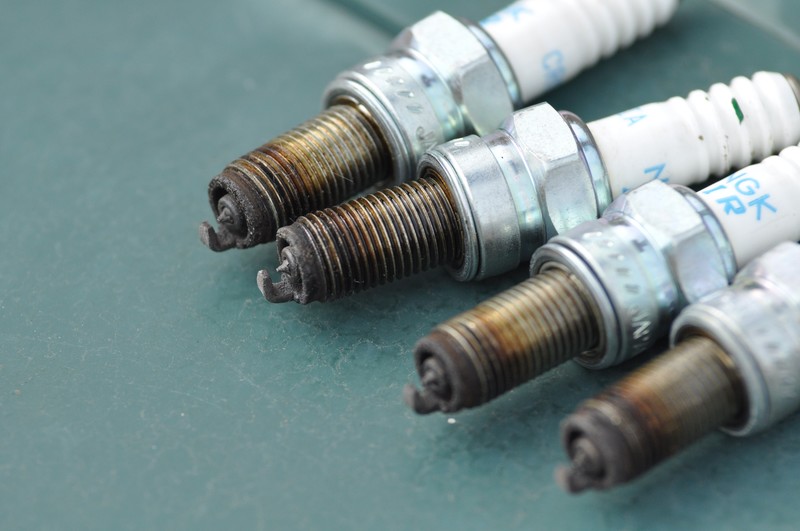

My plugs were a tad oily but I attributed that to Brock's rich map!
I'm going to take all the plastic off: there are a few parts I need to replace (cracked brakets and well nuts) and will check for leaks. I will also post pics of my plugs!

Yeah Erik, I just re read my comment again and it didn't make sense (erased it). Even if it was plausible I wouldn't be left with a 1.5 quart deficit. I wonder where that much oil would go though. Here are pics of the plugs after 21k miles:

Looks fine to me, I don't see any oil, just dry brown fluff, running about right IMHO.

yeah, it's hard to see on the pics but mine were a tad wet, definitely glossy. I checked around but couldn't see any trace of leaks. One thing I have noticed is that the oil filler cap appears to have a crack at the end of the thread. It's fine and cut at an angle and I can't tell if it's supposed to be like that or not. Also, when I tighten it up, it's like it doesn't seal properly. I remember, I used to struggle a little more to remove it but last time, it came out pretty easily. Any chance a damaged cap would let oil out (evaporate)?. There was no residue of oil on the oil filler so I doubt it!

Erik's plugs look good,loss of electrode some...but in 30K...you'd expect that.Yours...oil fouling looks like?Put any additives in your fuel regularly?

Here's one of my plugs about 3 years ago. Guess it was about 14k miles. Still on same plugs (Better change those).

Drag, looking at those again, they do have a lot more burned residue than Erik's plugs. How many miles on those plugs? Who did your fuel map?
You say they were wet with oil?
Posts: 6866

Drag, what was the gap on them critters, looks like I could park my truck in there...lol!

I wonder if running a lower octane fuel could have an adverse affect on plugs and 'firing' for these motors.I ran exclusively 91 premium as well in all three of my 14's.My plugs looked very close to Erik's at around 20K.HOWEVER...the electrode tips were indeed 'bending' at the very tip.Like they were about done.You guys plug's electrodes look pretty good.
The thing about plugs though...a guy can over time get used to them diminishing...until they just start fouling or not firing correctly.It takes a while before performance starts failing...and it's very subtle.Personally...I never run 87 in my motors....(14's).ONLY if I HAVE to stop and add some.Then it's mixed with that 91.I know some guys say it runs better on 87....mine never did...you could tell there was a difference.

Yeah the #2 and #3 coil sticks were hard to get out. I had to twist them back and forth for a long time and my fingers were sore. For the plugs I used the OEM plug wrench and a gear wrench with a ratcheting end. Best tools for the job!
I changed those plugs about 2 weeks ago at 21k miles. All the gas here contains 10% ethanol so I use star-tron about every other time I fill up the tank. I use 89 , never used 87 and purchase mainly from Shell and Exxon. My 1st and 2nd oil change were done at the dealer. All I know is that they used non-synthetic. I then switched to Amsoil to find out I had the valve cover leak. The last two oil changes, I have used Motul 300V. I'm using Brock's CT-dual map made for my bike. Idle was ok and throttle response was great, however I noticed a difference when I switched the plugs. Also, my idle speed dropped 200-300 rpms after I installed the new plugs so I had to raise it back a bit. On cold start up, it goes to about 1000 rpms, climb to 1500 rpms and comes back down to 1200 rpms at mid temp. The old plugs looked wet but I couldn't tell if it was oil or gas residue. I touch 10k rpm pretty often and thought the wet plugs were just the result of a rich map. There is no gasket or ring on my filler cap and there is definitely a crack in the thread.

" I touch 10k rpm pretty often"...while that isn't unusual for this engine to rev at....you 'may' get some blowby because of the pressures.Over time...this could be what is going on with your plugs...looks like oil fouling to me.Burnt oil.Brocks mentioned this airbox oil a few times in his website...course...they were Dragging....but still the milder version could probably be happening at 10K...over several riding times of that.IDK...maybe?I would think...if you're getting 'overflow' bad enough to enter that catch bottle...you 'may' have something going on in the engine...maybe a blocked/partially blocked oil port or something?Internal pressure building at certain times?...IDK

Drag from the look of your plugs you need to do a compression test in my opinion looks like oil residue but could also be from an overly rich fuel map but with your oil level dropping id be on the safe side!

A static compression test will only tell you if you have leakage at the valve seats. If there is a piston ring issue and oil is getting by, compression reading might still be good. Better to do a leakdown test to see how long each cylinder holds pressure. The presence of oil will fool a static compression test, but a leakdown test will tell for sure if something's getting by the rings, a much more suspect area for oil loss than the valves.
