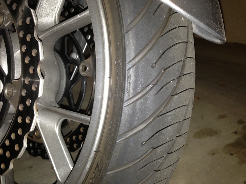

I don't feel like my rear is squatting but I have the same problem. I will see what my suspension guy says when I get a hold of him Tuesday!
RE: Street or canyon
05/19/13 8:59 PM
"but I have the same problem"....what problem?Chicken strips on the front?If you're leaning that far to grind that front all the way to the edge....BE CAREFUL!!!!!Closest I got was about an inch,maybe a bit less.I don't know WHAT turn caused it....or when actually.Or even HOW.These aren't track tires....but you sure don't want the front getting light or high exiting a turn.I mean...if you're into wheelying out on the exit...fine...you already know what to do.Anyone here have pics of their 'street' front tire worn to the edge?On the 14?I've seen ONE pic a long time ago.Maybe I'm full of shit...but I'm not so certain this bike CAN be leaned in that far without something going BYE BYE.On a flat curve....who can say the radius it takes to get around it and tipping the bike in to that kind of lean angle to get the front scrubbed?I'd like to see it...or someone doing it....
My guess it'd take a LOT of speed to get er leaned in THAT far,and a pretty good(tighter) radius.Both which may be too much for these street tires.IDK.Something like 51 degrees of lean on the 14 to reach max lean.You won't get that on any old turn....besides...there are SO MANY variables involved in getting that kind of wear on there anyway.You simply can't just go on any turn and get that(wear)(lean).
* Last updated by: Grn14 on 5/19/2013 @ 9:10 PM *

Grn14.. I was quite surprised to see my front tire worn down to prob 1/4".. I don't feel like a leaned that far over and it was on both sides.. Maybe because I dropped the psi about 5 f/r at the track .. This being on Pilot Road 3's.. We're you referring to street tires as a Sport Touring or long mileage?..
Since I'm pretty new to the whole handling and adjustments I won't even guess how I have even wear patterns front and rear.. I think Dragking may have done the same thing?.. Without reading my other threads I don't remember who said what right now... I just want to feel what "planted" feels like amongst other key traits to how the bike is feeling front and rear.. It's hard for me to picture telling that the front feels "loose" without it letting go.. It's easy in a car.. Fronts loose it slips/pushes.. No fear no foul.. NOT how I want to figure it out on a bike...

Ya...I hear ya.I'm not the best one really to add to this thing...Everyone rides different...lowing your PSI I would think would definitely give your tire a greater flex in turns...which would naturally wear more along the side....Yeah...I could see a guy getting it worn all the way over...and maybe not in such extreme conditions either.
My experience has been....street tires...41 PSI front/back...and the 'fastest' I've taken a turn to date is right at 145.I didn't want to lean any further than I was...though I probably had a bunch left....I didn't want to chance it.And I've right now got about a 1/2 inch on the front that isn't worn.Same as on the rear.So really...IDK.I feel my suspension is set fairly well for my weight.I did follow that set of videos from that guy tuning that green zx(OTT).The settings are a bit different for my 14R...but pretty similar.
