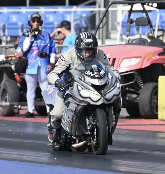

With 2.5" slammers in my front forks I've hit some pretty serious return road holes with no failures. They also survived my airborne launch at last years NHRA division 4 finals at 685 lbs. total when I landed it brought the front tire squat almost to the bead!
Wow, if it can take that kind of abuse, I'm sold
on ceramic.
What is the 685lb signify, is that rider and Bike combined
or just bike, I think my bike is supposed to be 684 wet,
and now with slip-ons, probably about 660lbs.

675-685 is my total weight. Various reduction and additions have the bike at 490 on the NHRA scales at the Texas Motorplex. I'm usually in the 170-175 range plus gear.

That's pretty darned impressive weight especially considering it's turboed and has an extended swing arm. I never weighed my Gen1 but from the weights of parts removed and changed, I figure it was about 485-490 lbs with full system and Carrozzeria rims.
