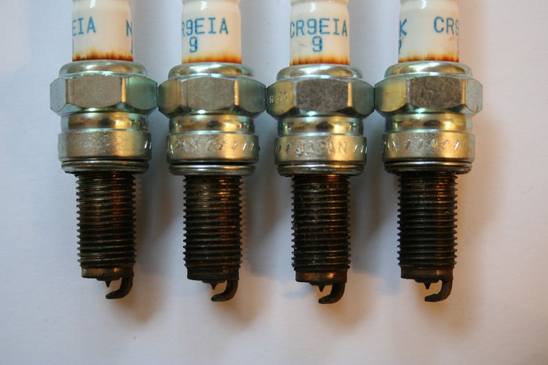

pegscraper
Location: UK
Joined: 05/04/12
Posts: 441
RE: Spark plugs
02/08/13 1:50 PM
Mine were all like this at 8200m. Gap hardly changed from new and virtually no deposits. Think I'll leave them in and check them again around 20k.
* Last updated by: pegscraper on 2/8/2013 @ 1:51 PM *

dericrey
dericrey's Gravatar
Location: Vidor, Texas
Joined: 04/04/12
Posts: 256
RE: Spark plugs
02/12/13 3:58 PM
It may be the Ethanol dragking or i'm running a little on the rich side. I'm going to stick with the 7500 mile mark.
