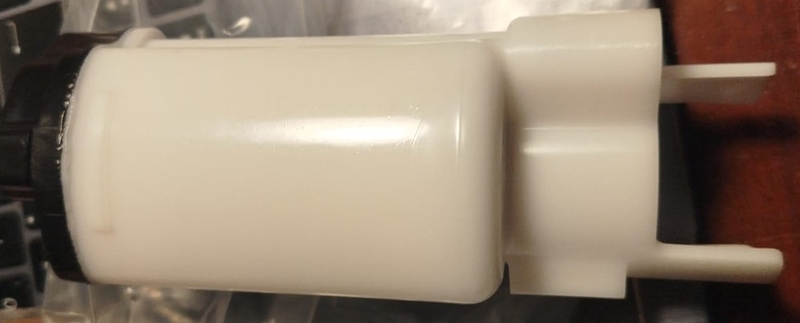

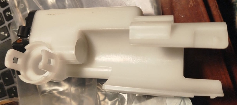

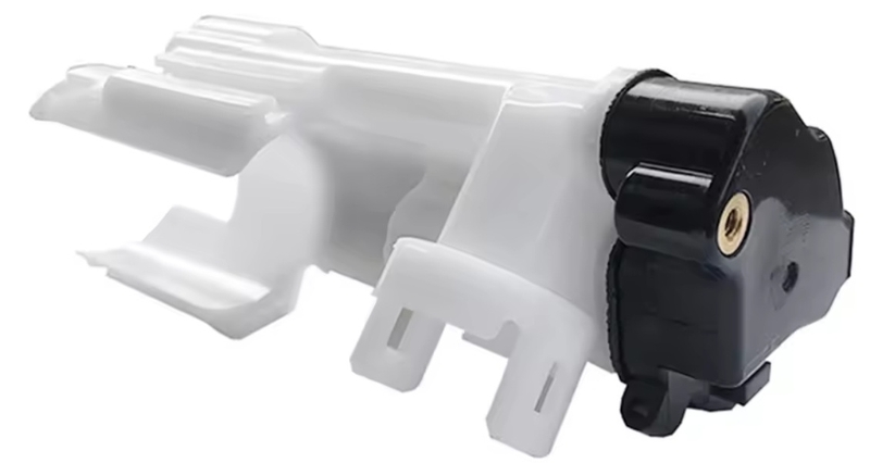

In the end, it was not fuel injectors, although it seemed that cleaning them made the engine run better.
If was the fuel pump high pressure filter being clogged. Fuel pressure was within spec, but fuel flow was less than half of spec, and that explains why at higher rpm's bike would start failing.
I still have some issues related to bike stalling after the engine being loaded, after going uphill and suddenly cutting gas, for example, and I think it may be the fuel pressure regulator. That's the next step, and I'll report it. It may help anyone like me who's searching to try to fix this kind of issue.
I ended up ordering an aftermarket one, they're the same as the ones for the Hayabusa, since it's a Mitsubishi fuel pump, and I'm sure they're available there, in the US (on Amazon or ebay). They're considerably cheaper than buying the whole fuel pump, although Suzuki sells the fuel pump filter separately, which Kawasaki doesn't. Basically, there are 2 types of fuel pumps: the ones with the sump bottom and the ones with the flat bottom, and there's a different filter for each one of those.
The pictures above are the ones for the fuel pump with the sump on it's bottom.
