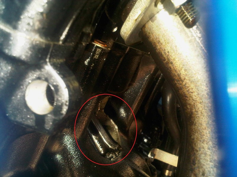

RE: Warranty Question
08/02/10 4:05 PM
Here is a Picture of the engine problem.
08/02/10 5:32 PM
That nos is hard on shit son! LOL. That looks like good old #3 rod bearing failure.
How were you riding before it went or when it went? A lot of long top speed wot running?
I am not accusing you and im BS you about nos its just what normally takes them out.
Regardless there is to many 14's losing that same bearing to ignore it or blame the rider.
I know it mostly happens when the bikes are run hard but kaw didn't advertise the 14 as a scooter!
I hope you can get Kaw to foot the bill' I think they should and if they don't then let the dealer know you plan to hit the forums with all the details.
Good Luck.............
08/02/10 6:17 PM
Hey Bill
I was running around 60mph when the bike started to shake and I thought something went in the suspension....when I checked my mirror to pull over I saw smoke so I figured I popped a hose or something and when my boys and I took off the fairing this is what we found. Really Suks!!! Riding Season Officially Over..
NOS.....seems alittle too crazy for Me.
WOT??? Wide Open Throttle? Nah just goin with the sunday afternoon traffic.
U have heard of more than just my bike blowing Up in the same way? If so this could definitly be a manufactering problem?
Thanks
