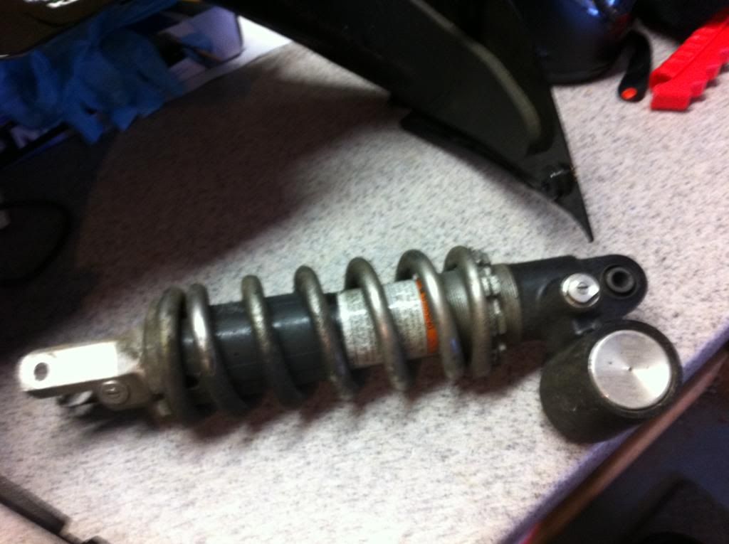

Well guy’s I was working on my girl and I had thought the hell with it I’ll do the suspension next year….Then a day went by and a new bike mag was in the mail box and it got me going again so here is how she looks now! LOL Going to send out the front and rears today!!! Race Tec here we come!

Bitchin'! That thing looks kinda like a Star Wars Speeder hangin' there.

Heh it does look sort of like a speeder.... I can date myself... I saw the speeders the first time anyone saw them, in the theater. Like what, 25 years ago? WoW
The process in the pictures would have been easier with a front pin stand, then you only would have slid the fork tubes out and left the triple tree installed. Those bearings in the stem only rarely need service, but he could do them now for sure, lol.

Yeah me too! That's too funny! I love having her all apart with no time line to have her back together. That way I can look at every little inch and make sure this is the bike I would want to go 200 MPH on and feel safe she's ready for it. Not just some guy that says yeah I checked it out (when he really didn't cuz his lunch hour was any minute)and before you know it there is a huge issue....Or even worse don't know it....LOL

Nice! It's the best thing you can do to the bike money well spent. I don't what size you are but with the suspension upgrades it will feel like a 1000 now. I know when I did mine that's how I felt. Now the playing field is starting to level off.
Again good for you an best of luck!!
