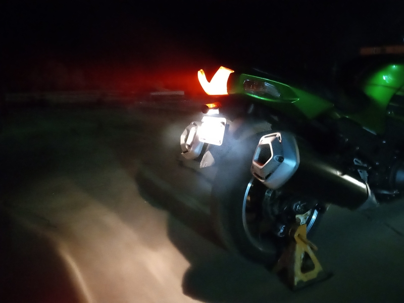

I just started the bike, it immediately started
smoking out of both pipes....
WHAT could be going on?
At first I thought it was from the cold air,
but nope it smelled a bit like burning
rubber or maybe oil, definitely smoke, when I shut it down
it continued to eek out both pipe ends.

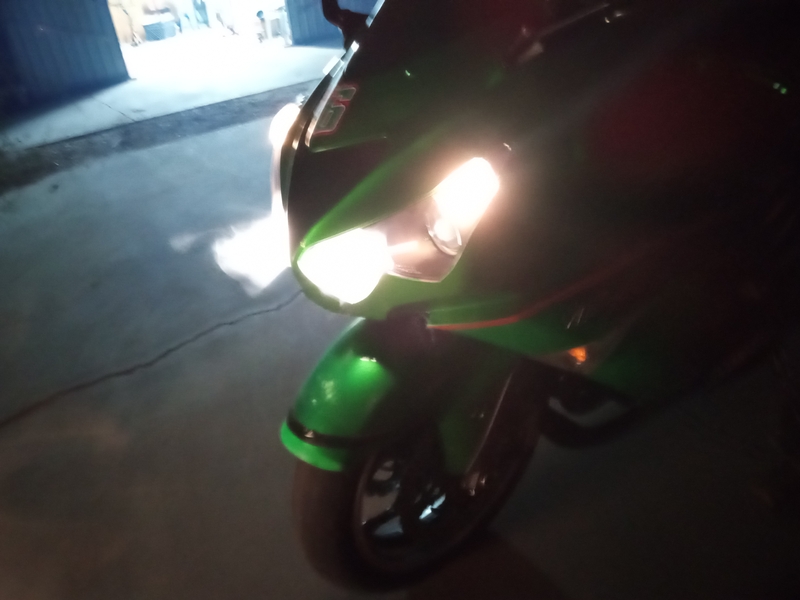

Smoke is also coming out the front fairing around the
headlight area, though the photo doesn't really show
the smoke well at that spot, it is there....
Strat, I hope you're from Finland or someplace really cold. Are you sure that's smoke? I ran my Gen1 once in the dead of winter and the engine temp never came above one bar. When I shut it down, two streams of steam rose out of the mufflers for a few minutes...like a couple cigarettes in an ash tray. My personal feeling is, "If it's stored for winter, don't start it until you're going to ride it." My buddy Kruz likes to run his bikes in the garage during winter if he can't ride and I think that's probably ok because he lives in Texas where the winter temps are above 40° F. Personally, I don't start a bike unless it's at least 60° F and I'm going to ride it but where I live, it's generally rather cold.
Burning rubber smell, that's an engine that's about to overheat. The rubber parts are actually giving off an odor. I don't think that's what's happening, you seem to indicate it's cold where you are.
Burning oil? Could be. If you have the head cover gasket leak, the oil drips down over the exhaust manifold and burns right at the top of the headers. I had this issue with my Gen1 but never actualy saw smoke. I sure smelled oil burning though.
If it's really cold where you are, could be steam coming out of the exhaust but smoke from under the top fairing sounds like oil burning on the headers.

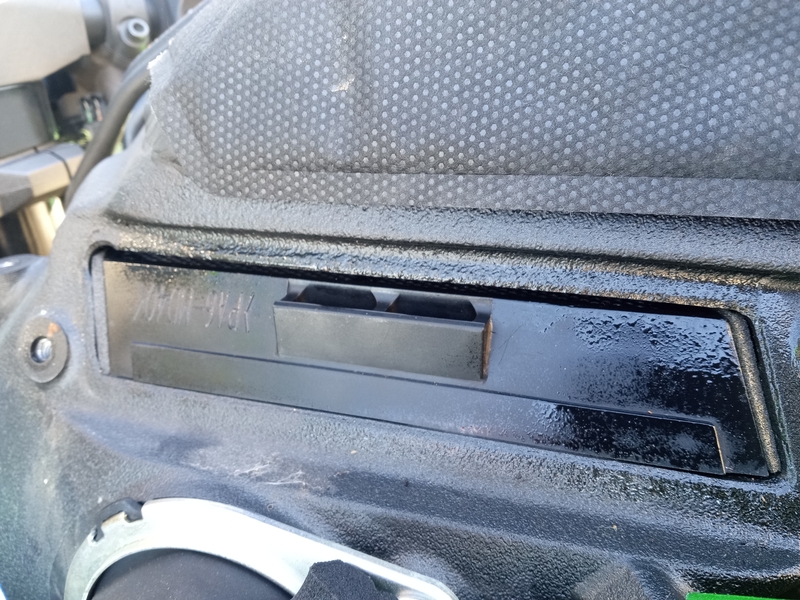

What is the 'engine blanket' ?
EDIT; The overwhelming amount of smoke though,
is definitely coming from the pipes.

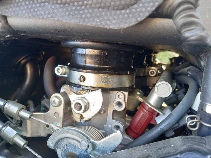

There is a lot of oily goop around the plastic
face of the filter though as it sits in the holder,
the drain tubes outside of the air box are oily
and so are the outside of the throttle bodies
(I think thats what they are, 4 'stacks' ?)

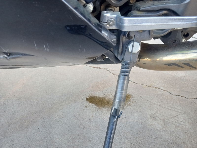

There is a small puddle under the middle of
the bike, at about the kickstand, it is brownish/tan
goop...
That's the rubber sheet that wraps over the engine. The engine blanket has straps at the top rear that can be easily unfastened.
the filter is pretty dry, I'd cleaned it out when I
bought it, it had had 6qts in the crank case.
I'll bet the oil under the air filter slot is from the bike being over-serviced on oil. The inside of the air box is coated with oil too. If the oil level is high, oil blows up the throttle bodies all the way to the air filter. I ran mine maybe just a half quart high and all these things happened to me. As for oil on the throttle body duct clamps, I think my 08 always accumulated a film of oil there even when the oil was kept at the correct level.
The black plastic tubes are the ducts. The metal part with the cable spool on the side the ducts join to is the throttle body assembly.
goop...
That's probably oil that has drained out of the air box drain tube. It's more for water that might get in the air box but any liquid that gets in there will run to the back of the air box and go down the drain tube. That's how your air box will dry out. Believe me, it dries out like nothing ever happened. Not even a film of oil is left eventually. It will probably take a good deal of time to get bone dry though. You could remove the gas tank and open the air box access doors to wipe the inside of the air box out a bit. I kind of don't recommend it. Much of the unfinished inside surface of the air box has a rough, toothy texture and it will definitely snag lint off any cloth. The only concern would be lint or strings sticking in the intake somewhere. If the drainage looks a little goopy, that's probably just sludge from oil in the air box mixing with condensation. I remember seeing a photo of an air box that was very badly oiled up and it had sludge in it too.

You can wipe off the outside of the throttle bodies if you want. I'm sure some oil seeped past the clamps. The T-bodies shouldn't get hot enough to burn any oil. That would be oil on the inside of the T-bodies getting sucked into the engine where it would burn.
If you're cleaning the outside of the T-bodies and the duct clamp screws seem not tight, that's how they should be. The torque spec is only a few inch lbs. If you tighten them down, the clamps bend and could deform the ducts. Also, don't take those duct clamps off unless you really need to. There's a bunch of spacers between the clamps and if you pull that long screw out, all the spacers fall everywhere. I have a tutorial on T-body removal.
If you take the fuel tank off, the T-bodies are still cramped under the air box. You'd need to remove the fuel tank to get at the air box access doors to remove the ducts however...if you were going to remove the T-bodies.
I wouldn't worry about any oil inside the bike that might be where it's not supposed to be. It will drain back in time or drain out the air box drain tube. As far as burning, it couldn't hurt to eliminate as much oil from the air box as possible but it seems like the problem is already correcting itself. Your spark plugs might be very carboned up now but as long as it runs good, I wouldn't be in a big rush to change those either (unless they're due). no sense in changing plugs if there is still any oil burning.
Another thing, remember I said a bit of oil on the T-bodies and ducts seems fairly normal? I had the access doors off the air box a few times and I always saw oil on the butterfly valves even when running the proper oil level. Some oil is probably going to always to get up there and I'm sure some of it burns. That's probably one reason a lot of these bikes loose a little oil after a couple thousand miles.
