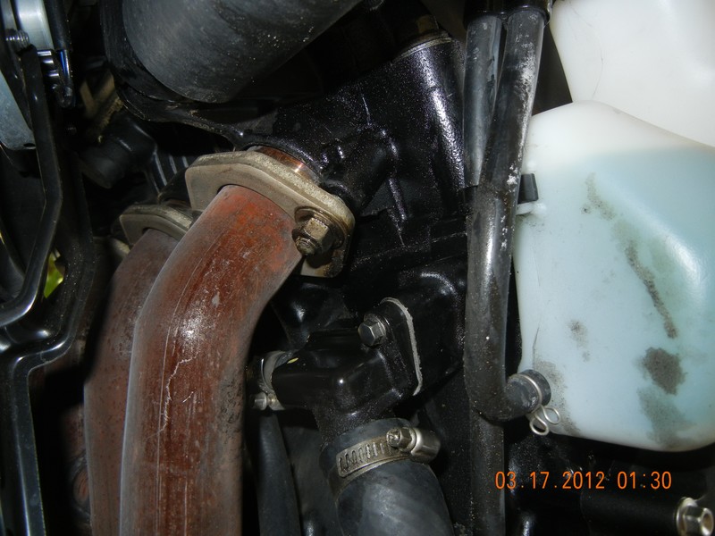

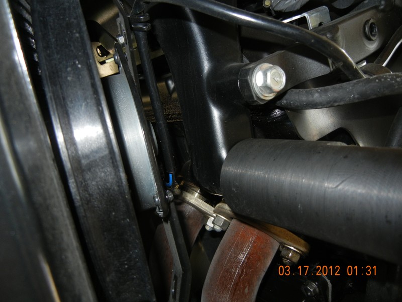

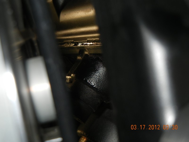

In the mean time I took off the faring for cleaning and maintenance and found some oil seepage:
I'm not a mechanic, and this seems small, but I imagine ALL the oil is supposed to stay inside the bike... Is this really bad news, or only kinda bad news?

Yes, I'd have that repaired. It's a simple procedure. Maybe under a hundred in parts, not including shims? Labor? I don't know? Since the leak is past a 'seep,' more a wet-pressure leak, you are losing little by little at the crankcase. But to a mechanic or the novice with a few proper tools, this is not something for you to take on.
I only say this being, you have the cover off, might as well check shim clearances. Then, here is the big, 'gotta have some mechanical know how going in,' to finish off the job. And that calls for removing the cams and all that. This is more for the dealer level to tackle this one. You have the parts in few days, the experience, the guarantee backup from the dealer's parts and labor. Only thing left is how much?

I think that's just something with the lighting in the picture. My valve cover is the standard brushed nickle color.
Yeah, that's what I thought. I don't even want to know how much they will charge for that. I don't think the hourly rates here are bad, but they're rate of labor seems high; Last front tire I replaced cost me $80 in labor. I swear every time I go to my local kawa dealership I feel like I'm getting ripped off. I sure wouldn't mind more local options.
It's been several years since I've done much more than basic maintenance, but how hard can it be to replace a valve cover gasket, esp if I have the shop manual?

So reading around it seems like this leak is fairly common on ZX14s... Many people seem to recommend using some washers to get a better seal around that gasket, and I think I'll try that method before I spend hundreds of dollars getting this thing changed out. I'll keep updated to see how it goes.

http://www.zxforums.com/forums/zx-14-forum/32552-oil-leak-valves-cover.html
The fix that several people said works:
Sorry to hear that Freddy-HOWEVER-it can be easily fixed by you-IF you have any mechanical/assembly skills at all(which it sounds like you do).First off-it's NOT the gasket.The valve cover bolts were machined just a tad too long,OR the threaded hole was not quite deep enough-one or the other-doesn't really matter.Simple cheap fix that works-remove whatever you need to there on the side of the bike,remove those front and rear cover bolts.(just the two on the outboard side).Place TWO each M10 washers on the bolts.3/8ths M10's.Reinstall bolts(a dab of red loctite on the tips).Tighten down CAREFULLY and watch your gasket seal as you tighten(do not tighten one end first,then the other-go back and forth keeping the pressure even).It will begin to deform ever so slightly along the seal.DO NOT OVERTIGHTEN.Stop when the bolt is snug,and the gasket is barely deforming from the front part along the side there and around the back of the seal.This will permanently repair your seal leak.Wipe down really well,and go ride.Come back,reclean any residual oil(which will probably appear for a few times).Once all the old oil is gone,you should have a perfect seal.(if not,go back in and tighten a bit more both bolts)I would not use the manual's torque settings-those were used for the stock bolt and "unwashered" situation.So they MAY not be adequate for this new configuration.Take yer time and don't overdo the squeeze there."
I know on my '09 those bolts were awfully hard to get to. One guy recommended just putting a line of gasket maker across the gasket, and this is actually the route I took. I had to drop the radiator to be able to fit hands in there, but there's now a nice new gasket line on the front of the cover. Looks like craps, but it's all hidden anyway. Just hope this doesn't cause a problem down the road...
First off, jolly has his head up his ass. I've been banned forum that place or I'd have ankle bracelets around his wrists, both occupying the same bracelet.
'The valve cover bolts were machined just a tad too long,' says the assholecraniuimthink if that is the case, then all the bikes should leak with extended bolts. Stupid! Flat the fuck plain stupid! The next lamebrain thinkass out his end is the surface of each head has a quality control problem, the factory has yet to catch it, but his ass says different. IDIOT!
Other than than, it really don't matter:
1. The bolt is too long.
2. The machining is hit and miss.
3. The rubber seals up because it shrunk there and can be loaded like buckle the cover/load the threads/stretch the bolt some. Some idiot needs to explain 1 and 2 to 500 thousand bolts, punched out of the same cast, there are long ones and short ones, not spec ones. Make perfect sense?
