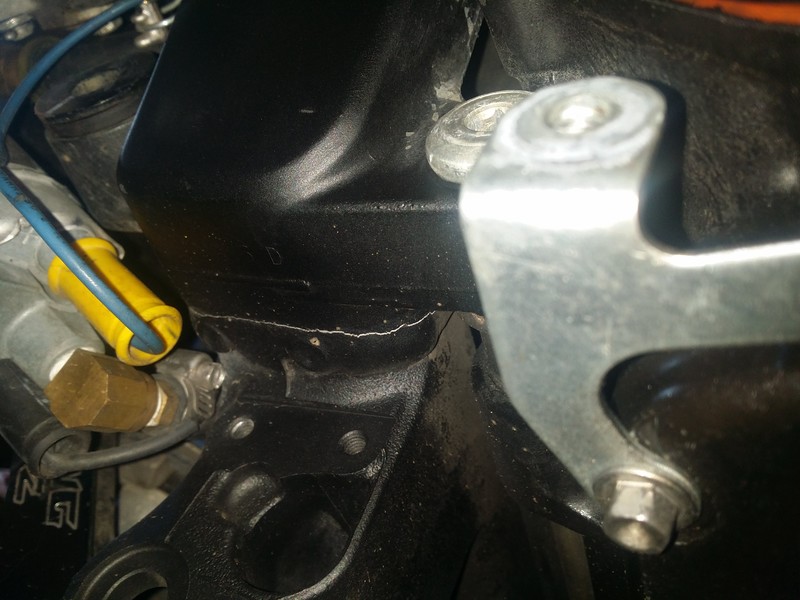

RE: frame crack
07/15/14 1:04 PM
here is what the crack looks like. not sure if it was the same as the 06 07 issue or not

RE: frame crack
07/15/14 10:59 PM
I don't have a pic of mine, and like I said, it wasn't a defect of the frame, so there were cracks in different places on different bikes. Usually on the weld on the lower cross member.
