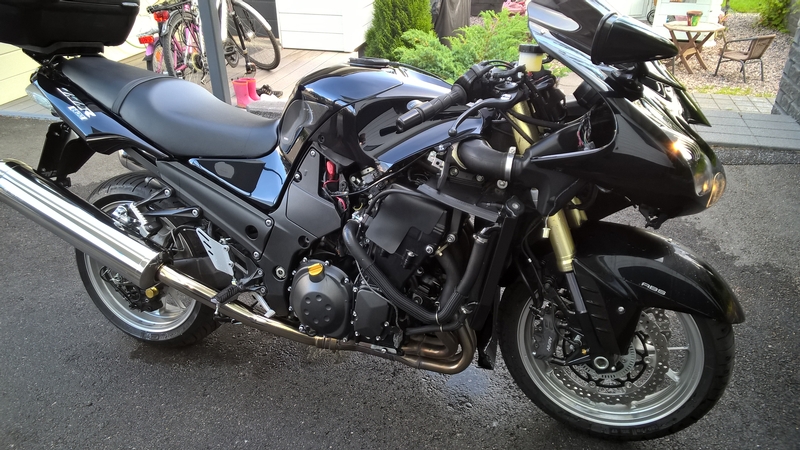

APE tensioner installed, no more rattle :-)
