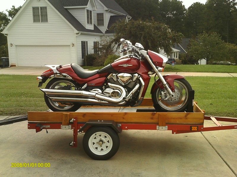

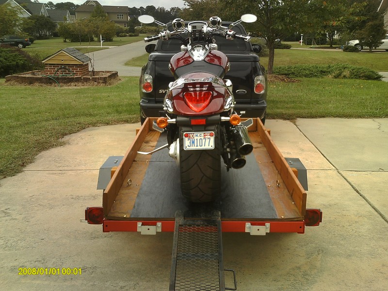

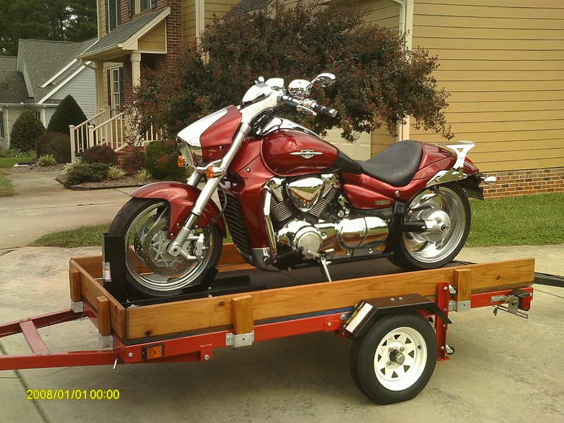

I actually picked up one of those 4x8 folding trailers from Harbor Freight for $269. I got the one with the 12" tires on it, and installed a piece of 4x8x3/4" ext. grade plywood that I cut in half. I coated it nicely with stain, and used some truck bed linning to do a 3' section down the middle. This was to keep the wood from being too slick in the event that it got wet. I used it 2 weeks ago to trailer my M109 (about 800 pounds) to Boone (185 miles one way), and it worked perfectly. You are able to fold it up once you get to your destination and place it behind you truck in a parking space. This is just another cheap version (very cheap), of a kendon trailer. I added a 1x6 side railing to my trailer, but that is not necessary. I used the harbor freight wheel chock that they have for $89 (cost me $39 with my coupon) and 2 eye bolts in the rear. Bike never moved and the trailer was rock solid. Here are some pictures that I took earlier in the year when I was test fitting the bike.

I like everything about that setup, except the ramp. Man, that's a narrow ramp. Dont miss on the pole shot... You also have nothing to stand on, should you have to stop on the ramp, for whatever reason.
Also, does your M109 get "stuck" when going over the ramp "lip" (the hinge point), at the top?
I would not do the "trailer on a tongue" idea for our cycle. The flexing and twisting moments of inertial would be pretty extreme at the mass we're talking about. "Normal" hookups have a ball joint to avoid generating these type of moments. You make a solid mount onto the hitch where the ball is normall mounted, and you're really asking for trouble when loading it. The hitch manufacturer's dont rate for flexing and twisting moments, they rate for steady state forces.
Now, if you could somehow brace both of the "arms" of the trailer with cross members, to the sides of the truck somehow, That would improve both flexing and twisting absorption. Place the ramp, mount the cycle, remove the ramp, and place the braces on each side. That would prolly work.

I have had no trouble with getting the M109 (or the zzr1200)stuck at the lip of the ramp. As far as driving it up on the ramp, I also have 2 additional 6'4 ramps that I place on either side of the one that I am driving on. I use those for placing my feed down when needed. I also usualy back my truck or trailer (depends on whichever I am using) into a ditch or something if the surface that I am loading onto is more than 18" above the ground. When I bought my first M109 from a guy in Ohio, we had no way to load it, but with a 8' ramp provided by the seller. he said just drive it into the rear of the truck (f150 longbed). I asked if he was crazy. He said he could do it. I held the money and said if he could do it without damageing the bike or truck, he could get the money. He zoomed down the alley and drove back up the 8" ramp into the truck (the rear rim on this bike is 8.5"). I was amazed and scared. Gave him the money and drove back to N.C.

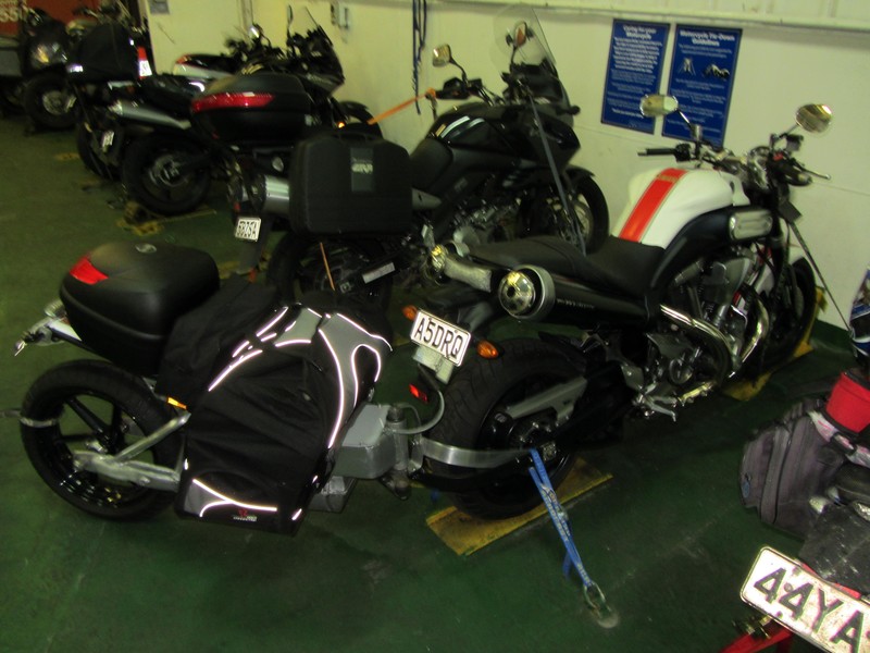

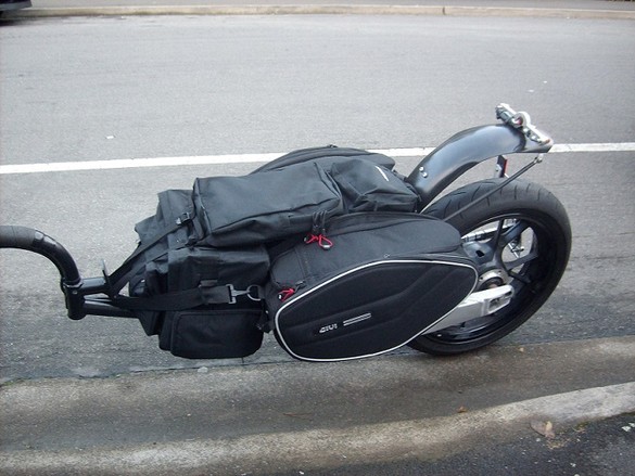

RE: HAS ANYONE TRIED A MOTORCYLE CARRIER.
09/22/13 3:38 AM
If it needs moved I just make something to move it.
This trailer I made in a day including onroad and painted it the next day.
Im making a quad bike trailer at the moment.
I might make a bike rack towing platform next.
I have an fetish with large arse ends. I don't think that I can give them up. I need help!
