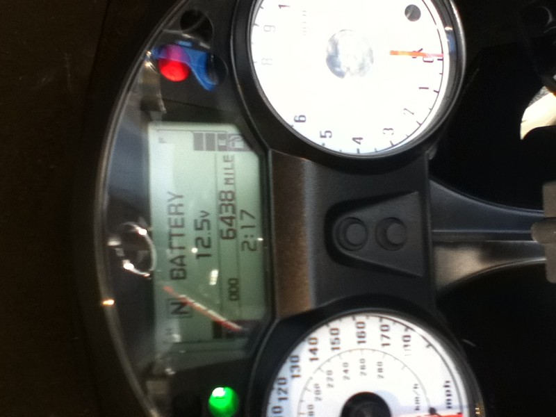

I RUN AROUND
1-NOT RUNNING--12.5
2-RUNNING---14.2
* Last updated by: SlowmoZX14 on 8/17/2014 @ 10:51 AM *
