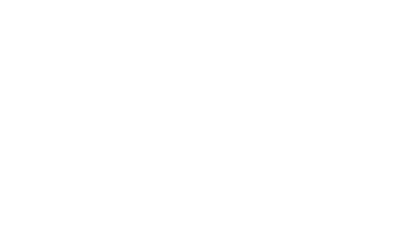

Kruz ya just got me browzing this subject mate as I want to know myself, so after hours of searching i,ve learnt that Maxima Chain wax That I use is better than Lubes Hands down, anyway this opinion is from many other forums & sites on this topic! since I found Maxima Wax seems to be far superier it seems that Dupoint Teflon is even better still compared to Wax ! This is the new for me product im just about to go out & buy for myself to try ! Kruz anyway as I had to get a new supply of lube to replace the Maxima Wax I was happy with in regaurds to the Fling & Mess factor
