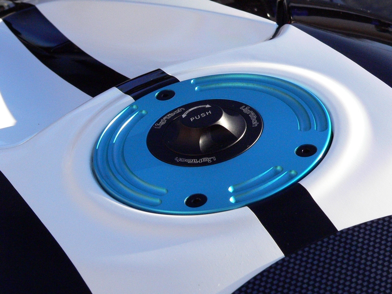

Lightec gas caps are on clearance at OPP Racing right now. I just bought two of them, a quick release in indigo and a full spin cap in black, both $73. I also bought the racing key for the full spin at $38 (LOL half the price of a gas cap). They have a few quick releases for fifty seven bucks, not in my color so I left them for you! No idea why they have quick releases for the ZX-14 under two different products. They look exactly the same but one is $74 and the other is $57. Call OPP and ask if you’re into it. If you order a LighTech in blue, it will be a light sky blue as shown in the photo below. I'd suggest indigo for something closer to a conventional anodized blue color.

So that's about everything I know about aftermarket gas caps. Here's my LighTech on the Gen1.
