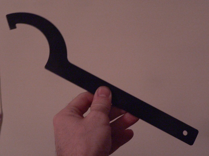

ROOK:::You will need to buy a Kawi spanner wrench to turn the nut and lock nut.
....DOES THAT COME WITH THE TOOL SET
RE: Suspension Settings
09/04/14 8:51 PM
No. There are spanner wrenches available in different sizes to fit different nuts. I bought the Kawasaki tool for the ZX-14. The part # is in the SM. It cost me about $40 for a plain old stamped out wrench from a plate of steel. It works though.
See? The hook grabs a castle and the inner curve rests across the tops of the other castles while you turn. Have a look at the rear shock preload nut and locknut and you'll see how this wrench works. You can place a flat tipped punch against the castleated part of the nut and tap it with a hammer to break the nuts free. Never tried that. To "caveman" for me. I think a punch is worth a try but it's going to chip the paint a little. I'm sure the spanner scrapes a little bit too. Those nuts are tight.
* Last updated by: Rook on 9/4/2014 @ 8:56 PM *
Every stroke of the hammer side loads the cylinder to ram interface along with its seal.
Use the proper wrench whether it be KHI or MotionPro brand.

Yeah, get a motion pro if it's cheaper than the Kawi tool. MP makes good stuff. Their spanner will work as long as it is specced for the ZX-14 shock.

ehhh, I'm no suspension expert by a longshot but IMHO, the spring length/tension/preload, whatever you want to csll it is the most importsnt setting. For one thing, if it is way out of whack, you are riding with improper chassis geometry. Also, you can make the shock rebound faster/slower or compress faster/slower but if it is too hard or too soft to begin with, Those won't help much. Bite the bullet and buy the right sized spanner. Then you'd set for life.
You could try to make one out of wood. Use a screw for the hook.

I meant the spring which use the spanner wrench
