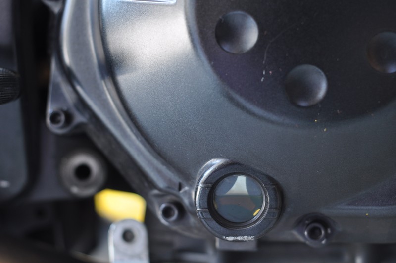

Sorry Kruz, just saw this earlier today. I'm just shy of 1000 miles on the new oil. Had less than that on the other batch (I think I high sided at around 400 miles). Anyways, I just came back from the garage where I had let her cool down and everything is kosher. The oil just started to darken a little but the level is the same. I even marked spots to make sure I get a surgical reading every time.
*I'm still using Motul 300 Dble Ester but I added some Petron Additive this time.
My cover leak is completely fixed as the side of the motor is flaky dry. My oil cap was busted from over tightening and I replaced it. It's far fetched but I could have been loosing oil that way too. The most plausible cause: I still bleep the throttle every change I get but I haven't been far in the country on those long sweepers where I usually keep her close to red line for 20-30 minutes at the time. I found out I had lost a lot of oil when I returned from my trip to the sisters! I should be at around 2000 miles on this oil at the end of the month. I will give you an update then
Also oil can actually evaporate so what you're finding is just part of what's coming out.
