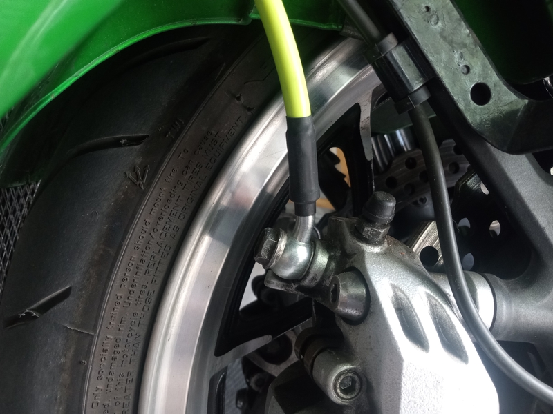

''This video shows what I did to delete the ABS for my front brakes,
while allowing the rear abs to continue working.''
When finished with this project the instrument cluster
notifications remain in proper working function with
no error codes or warning notices.
It is very likely that if I repeat the procedure at the
rear brake assembly, I'll have the same result; No
issues with instrument cluster 'faults' all-normal.

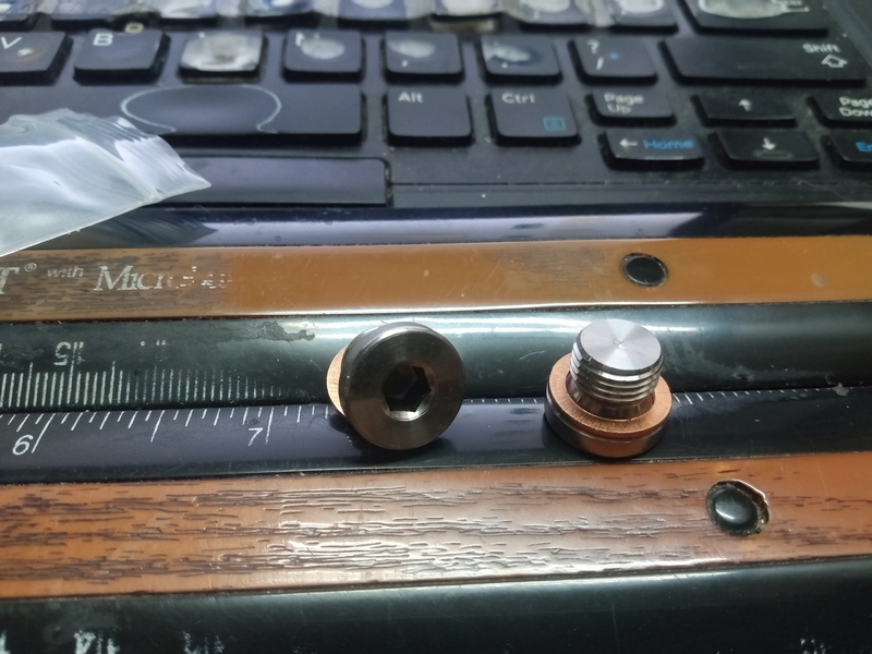

Parts used;
2 M10 1.0MM inverted couplings O'Reilly's
2 M10 1.0MM stainless 'plugs' with cu crush washers Amzn
1 36'' + - braided brake line amzn
1 28'' + - braided brake line amzn
I was short 1 10mm banjo bolt crush washer, may
have lost it or could be there was just not enough
for the project.

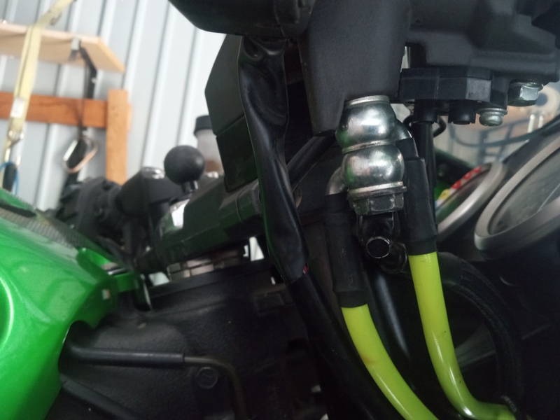

I was able to use the long crossover banjo bolt
at the master cylinder, so I didn't need to order one.
DISCLAIMER; ABS can save your life, so I do not
recommend anyone try this, however
there are instances and occasions where
some of us do not want ABS.

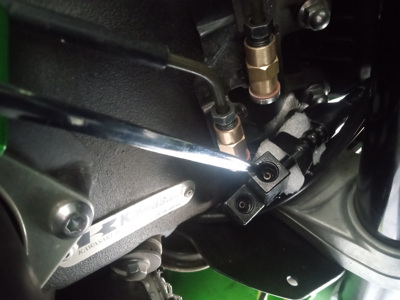

Plugged brake lines, and original line interface blocks that
I removed from the bike;
These are the plugs that I fitted into the inverted flare brake line couplers;
Double banjo bolt junction, using the longer bolt that used to hold the
two lines to the right side caliper, where one is the jumper to the
left side caliper;
Right side Caliper;
Alt ABS Delete
