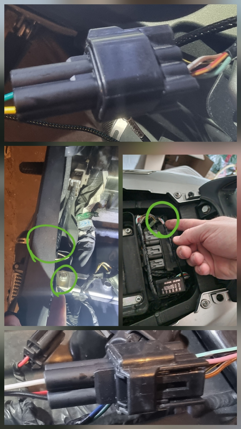

Yesterday I took apart the bike a bit since I have not found the second diag plug on the wire harness - lifted up the fuel tank and still not found so I was a bit sad and thought that maybe I'll need additional harness. But today after work in daylight I found that plug well hidden below the fuel tank on the left side of the subframe attached to a small metal holder. Truth is I checked in the office a few wire harnesses on the ebay since the wiring diagram in the SM doesn't help in how far from the ECU connectors and from the first one.
After that it was a piece of cake, connected, then to my laptop, turned the ignition on, read the ECU's contents, saved, then modded: for my bike ('08-'11) there's only one shared map exist, which is dyno tuned and more (hopefully it is okay, so I copied the fueling (IAP and TPS table) into my duplicated original, also modified the STP (secondaries) opening, modifying to open earlier then copying the 6th gear table values to all other gears tables - except neutral. Removed the top speed limiter as I want to check top speed someday, reduced the temp when the fan will kick in.
I know exactly which one you are talking about, beneath the seat on the left. I removed the bracket on my gen1 and fastened it with a zip tie.

The connectors: the easy to find one is below the pillion seating on the right, beside the ECU, but the other one was below the fuel tank , beside the frame on the left side, very well hidden.

Just a report back.
I ordered a Healtech Speedohealer, and put it in with -7.5% correction, so finally the speedo doesn't lie.
With the tunes I've leaned my 3rd one further, making that rpm range ( <4000 ) almost useless - it was a test how far I got from the limit, then I returned to the 2nd which I've mentioned before, the linear one. Modded it with even more STP opening. The bike's throttle-engine connection now reminds me much the ZX-10R's, it is instant. The only side effect that I "disabled" engine braking almost completely: closing the throttle after acceleration doesn't result in engine braking. It's weird but it's not because RPM hangs up. Also, the engine purrs nicely even below 1500 rpm in 6th - definitely the STP made it reluctant in OEM setup.
Sadly, cold season coming, maybe a few rides, and end of this season. Hoped for a top speed test run (I did it with every bike I had out of curiosity - with the 14 I'm hoping for 300+ kmph (GPS) - and then forget about and just ride them normal sportbike speeds on B-roads)
