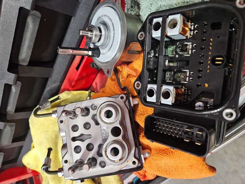

Daddyrabbit
Daddyrabbit's Gravatar
Joined: 05/13/20
Posts: 651
RE: Abs module
05/02/26 2:54 PM
Took the the old module apart for shits and giggles.
