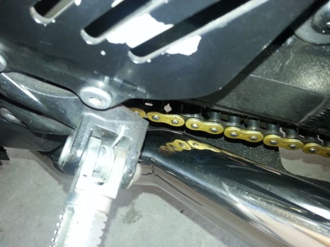

The issues I am having with fitment is that, the the cans are having issues clearing the passenger pegs, and they seem to angled up, impeding the heal of my boot when on the bike. Am I just doing it wrong? or is it indeed the wrong headers?. Will I need to pick up the right year headers or is there some modification that could be done?

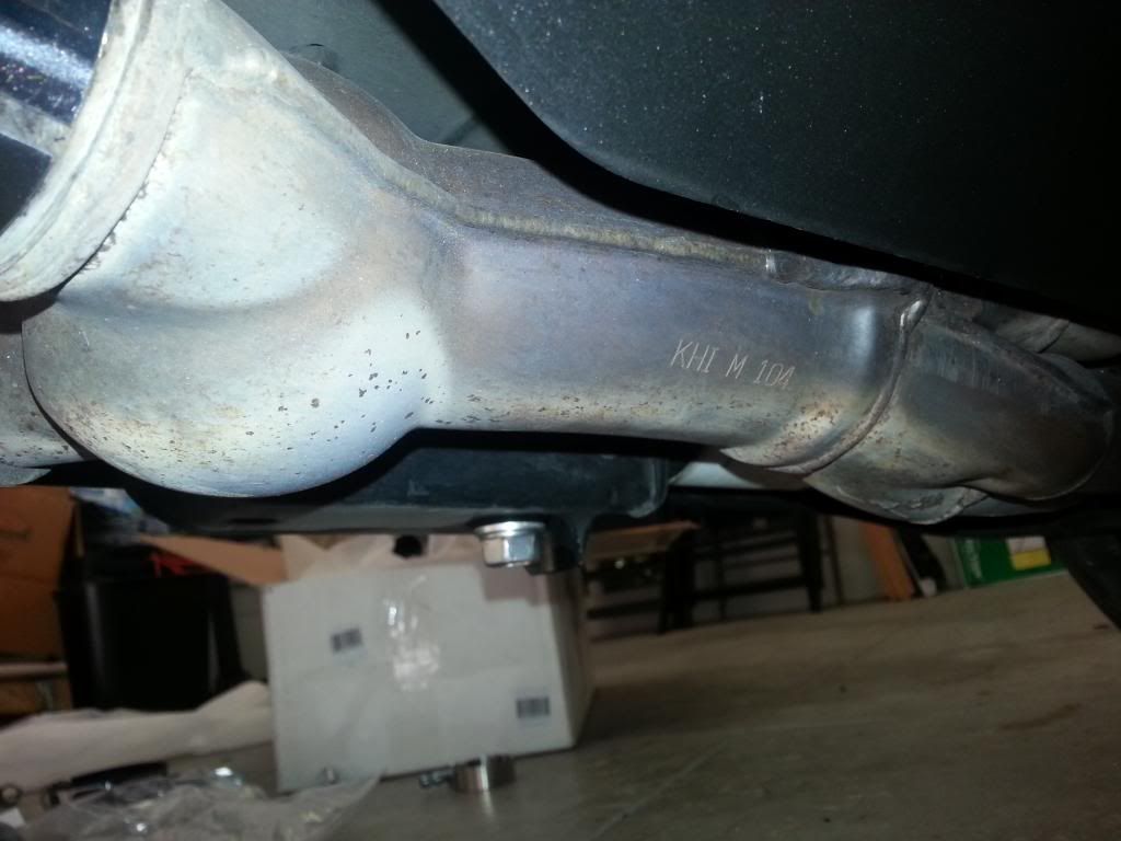

here are the headers, cant tell if I have the cats in my header or not, I don't see O2 sensors.
http://i3.photobucket.com/albums/y65/bigjoe87865/20140206_105847_zpsd3dc1b6a.jpg
http://i3.photobucket.com/albums/y65/bigjoe87865/20140206_105900_zps597ff87d.jpg

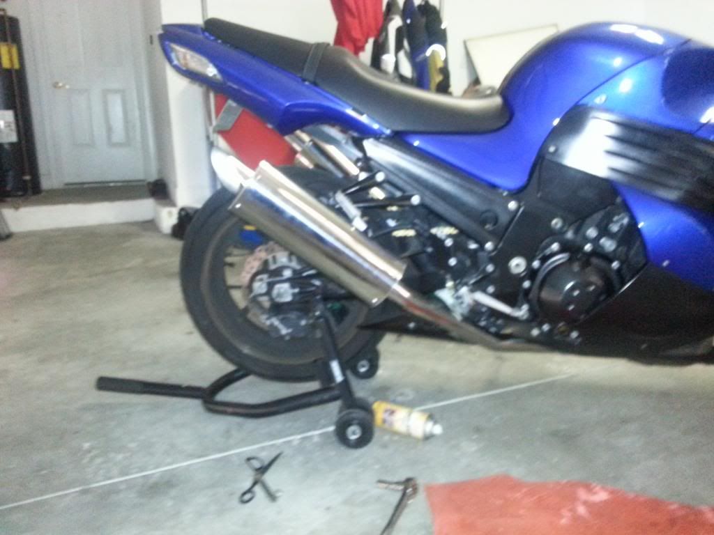

and the bike with the exhaust test fitted. Not clearing the passanger pegs and they are lopsided
http://i3.photobucket.com/albums/y65/bigjoe87865/20140206_110212_zpsf7af887e.jpg
http://i3.photobucket.com/albums/y65/bigjoe87865/20140206_110226_zps709b6893.jpg

yes they do separate, I have tried tweaking it around for a while and have not found the right angle. It either hits the chain, rear peg, front peg depending on the tweaking.
I am starting to believe it is poorly made. Unless the difference in headers could really throw it off that much. I have tried looking at pictures of 06 headers and mine look just like them. In-fact I couldn't tell the difference between an 06/07 and an 08+ headers when looking at pictures on ebay

I have a hard time believing that the tips should be angled out like that. Usually they point straight back. Something ain't right.

If the midpipes slip onto the header, they are the correct year. '06-'07 header outlets are 51 mm diameter and '08-'11 are 53 mm to make up for the obstruction of the 3rd catalyst (bulge in the collector).

Thanks Danno, the mid pipes do slip in, but I figured it would slip into either headers because the 2mm difference is not great enough to block the mids from going in. They could just expand slightly to fit in right?.
and was concerned about whether or not this bulge is the cat or not. http://i3.photobucket.com/albums/y65/bigjoe87865/20140206_105847_zpsd3dc1b6a.jpg
Also in this picture you can see the midpipes fit on the header outlet, but they don't sit flush all the way in with the stop on the header outlet. Is it because they are the 53mm outlets?.
http://i3.photobucket.com/albums/y65/bigjoe87865/20140206_110523_zps8626d78a.jpg
Aside from header outlets size and the cat, are there any physical differences between the 06/07 and 08+ headers? Do they angle different as well?

Bulb = A cleaver way to run duals out one header plus some.
Cat-Less Bulbs = 2006-2007 and 2012-2014.
Bulbs with Cat = 2008-2011.
Mid Gasket Differential:
Bulb's Gasket = Fat ~ would be a cat-less bulb, because there is no restriction but an empty bulb. First 2 years only.
Bulb w/Cat = Narrow ~ gasket happened when they expanded the headers/bulb/outlets so the honeycomb would not effect flow but break even [as if empty] with the expansion of the header/bulb/outlets.
Bulb Interchangeability:
2006-2011 = Use any 1st/2nd gen OE muffler to slip on any 1st/2nd gen bulb.
Gaskets = That change in "Gaskethickness" is the connection solver.
Generation Bulbs:
2006-7 = Smallest size are the header tubes and tip diameters.
2008-11 = Mid size grew in same mm growth for the honeycomb.
2012-14 = Biggest tip diameter grew for bore size change - No cat inside is my guess.
Just that one mm growth was enough to keep things from sliding into each other times 3 gens.
Aftmket Slips:
If say there is a parts number change for the same look of the slip, then they followed that slip as the gens changed. I'm an OE kind of guy so the slippers need to chime in and say, 'I kept my old slips and they slipped back on to the 2nd gen as well.' Now you know, or find the same part number on line, that answered that.
As far as the slips here, that looks like a nice tight fit to the bulb. The placing of the reversed pipe was an excellent variable. If we are still fit-less; stand both the stock muffler and slip next to each other; look at both mid pipe curves [at two angles] as you upright the muffler's brackets in the vertical and to the equal height in the horizontal and all that look me over.

Anyways, I tried again this time on only the right side, and no go, tried every which way to angle in the midpipe and exhaust and I gave up. maybe ill take it to someone or just return it
Anyways, regarding my stock exhaust, I have a feeling they are not from a 2006 , probably an 08+ since the previous owner installed them on the bike and I am pretty sure I have an 06 header. So when putting back the stock exhaust, I can't seem to get it to be nice and tight at the header outlet. Who ever installed the cans made some ghetto gasket out of very thin metal sheets rolled up. They are not holding up well anymore and my exhaust is loose and even leaks a little bit when the engine is running.
What kind of gasket or something of that sort can I buy to insert there and close up the gap between the diameter of my stock exhaust and the header outlet?

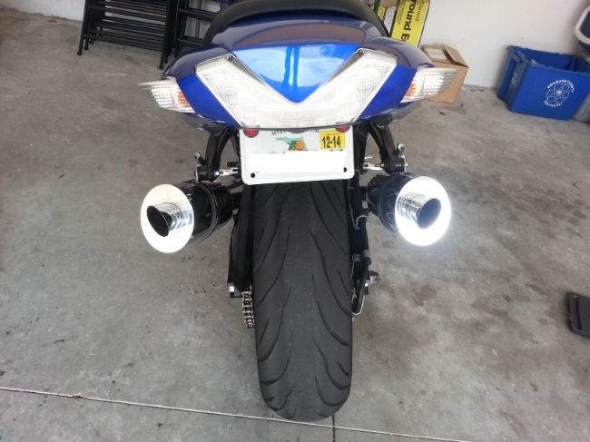

success finally! felt like a noob lol. This is the boz bros race exhaust and it sounds nice and deep. A tad on the loud side but bearable. at idle, it massages my ass. it has a drone below 3k when cruising in high gear. pops when de-accelerating. Over all I am happy and especially the price
The chain was awfully close, had to tighten my chain. Dont know why they would bend it that close to the chain. Streetracer, similar to yours?
